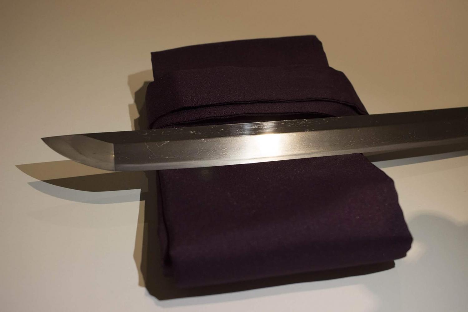

 This possibly explains one of my blades, a very open grained Mumei Wakizashi which looked to have no hamon. Then after cleaning an apparent hamon appeared at about the thickness of a piece of wire.
I think this wakizashi would be hoso-suguha?
I wonder how many hoso-suguha came about from many polishes over the years? You would think hoso and ito suguha would be a risky hamon for a sword in use, any chip would be potentially catastrophic for a combat sword.post-3926-0-82337700-1503722136_thumb.jpeg
