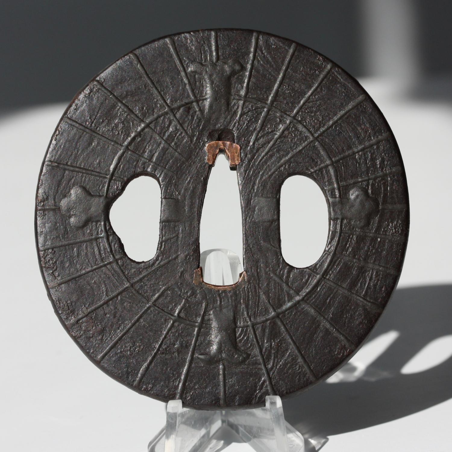

Marius Posted March 28, 2017 Report Posted March 28, 2017 Guys, I am hopeless when it comes to such mei... Mokume does not help, either... I will be grateful for help. Thanks in advance Small size pic: Big size pic: different aspect: Quote
Toryu2020 Posted March 28, 2017 Report Posted March 28, 2017 明珍〇〇 紀宗近作 Just guessing really - not at all confident this is Mune CHIKA. However if you start looking at Myochin signatures I think you will fill in the blanks... -t 1 Quote
Marius Posted March 28, 2017 Author Report Posted March 28, 2017 Thomas, Thank you so much! Your guess is certainly better than anything I can do... Quote
uwe Posted March 28, 2017 Report Posted March 28, 2017 My guess is, "Myochin Shikibu Ki no Munechika saku"! Quote
k morita Posted March 31, 2017 Report Posted March 31, 2017 "Myochin Shikibu Ki no Munesada saku", not Munechika. 3 Quote
uwe Posted March 31, 2017 Report Posted March 31, 2017 Thanks Morita san! "Munesada" is possible. But then it should be "...Minbu..." instead of "...Shikibu..." don't you think? 1 Quote
Marius Posted March 31, 2017 Author Report Posted March 31, 2017 Dear Morita san, Many many thanks Quote
Akao Posted April 11, 2017 Report Posted April 11, 2017 "Myochin Shikibu Ki no Munesada saku", not Munechika. What is the meaning of "Shikibu" in the mei ? Thanks Quote
SteveM Posted April 11, 2017 Report Posted April 11, 2017 I don't know what meaning it had for the artist, but for us it is just another part of his name. Probably a mentor or past master used parts of these kanji in his name, and so as Munesada became more skilled and celebrated, Munesada was allowed to add these kanji to his "art name". I also think this is Minbu (民部) by the way. Wakayama's reference lists both Shikibu (式部) and Minbu as possibilities for this artist, but to me it looks like Minbu... 1 Quote

SteveM Posted April 12, 2017 Report Posted April 12, 2017 Let me also say it looks like it could be a very nice tsuba. Any pictures of the whole thing? Quote
uwe Posted April 12, 2017 Report Posted April 12, 2017 Well, implied we have the Mei right, then only one "Munesada" left. According to an entry in the Shin Katchushi Meikan, he was active around the mid Edo period and lived in Edo. The Myochin genealogy (most faked genealogy ever...) mentioned him as an son of the famous "Muneakira". It is said that he worked for the Asano family and was also known for high quality iron tsuba! 1 Quote
Akao Posted April 12, 2017 Report Posted April 12, 2017 Here two pictures of this tsuba, sold recently on the NMB . It does not seem to be so much from the late edo period like the Munesada mentionned ... ? 1 Quote
Marius Posted April 12, 2017 Author Report Posted April 12, 2017 Hugues, FFS, it is a late Edo piece, whatever the signature. Yes, it is kind of Christian, Namban, whatever... Just a fad of the Bakumatsu. Certainly not one of those mythical Kirishitan kodogu of the Edo period, which did not exist, regardless of what smart dealers tell you. Gosh, guys, this has been described by myself in the sales section, and while I am certainly not an authority, keep in mind that there was a dozen of crests with a cross as the central motif. Is there any need to discuss this again? It is a good tsuba in its own right, a revival "namban style" if you will. Analyse the mei to death, but leave that poor tsuba alone Quote
Akao Posted April 12, 2017 Report Posted April 12, 2017 Marius, I am agree about the idea of a revival Namban theme and we don't discuss about it here. Just want to understand What is behind the mei (gimei or not) and more understand the mei composition. About datation, I'm maybe less severe than you :-) Quote
