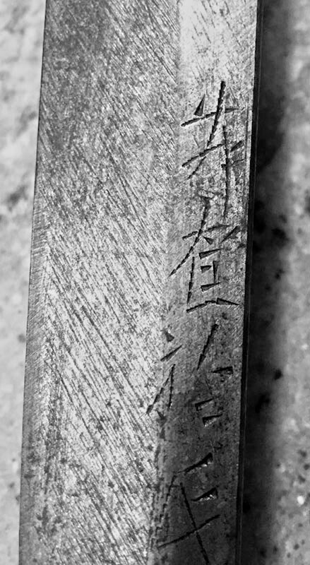

charlie1 Posted December 21, 2016 Report Posted December 21, 2016 Pulled this one off the trash pile. It was literally being thrown away. The nakago was really clean and the blades rusted. Needed some help on the mei. Thanks Charlie Quote
SteveM Posted December 21, 2016 Report Posted December 21, 2016 囗囗於氏房作之 ?? oite Ujifusa saku kore I am struggling with the first two, which would seal the deal on which Ujifusa this is. I wouldn't expect there to be too much mystery about a showa-era Ujifusa, but I can't place this one. Maybe somebody can give me a hand. Quote
Shugyosha Posted December 21, 2016 Report Posted December 21, 2016 There's only one Showa smith of this name listed in Sesko, but the signature doesn't tally: UJIFUSA (氏房), Shōwa (昭和, 1926-1989), Gifu – “Ujifusa” (氏房), real name Shinoda Hiroshi (篠田寛), born May 20th 1912, student of Watanabe Kanenaga (渡辺兼永) and Katō Jumyō (加藤寿命), he worked as a guntō smith, jōkō no retsu (Akihide), Third Seat at the 6th Shinsaku Nihontō Denrankai (新作日本刀展覧会, 1941) Quote
charlie1 Posted December 22, 2016 Author Report Posted December 22, 2016 It's hard to see any detail in the blade. Rust to the habaki 25 3/4" chu kissaki gunome midare iori mune. I did see some hada under the habaki. Came in a "shinbun" mounts... Quote
charlie1 Posted December 31, 2016 Author Report Posted December 31, 2016 Here is a clearer pic of the first two characters. I really appreciate the help so far Happy new year Charlie Quote
Brian Posted January 1, 2017 Report Posted January 1, 2017 All I can do is rotate it, and try a filter or 2. Brian Quote
