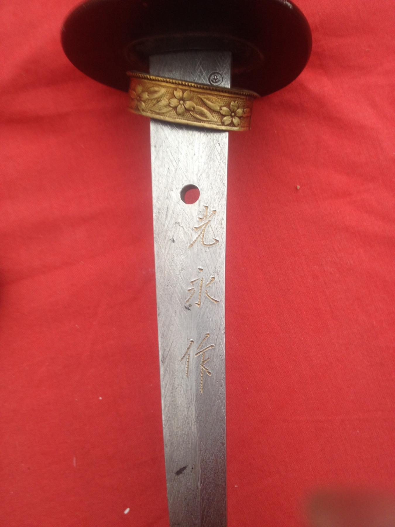

philippe isaura Posted June 26, 2016 Report Posted June 26, 2016 Can anyone help me to translate the inscription ?? Maker?? Thxthxthx Quote
Thierry BERNARD Posted June 26, 2016 Report Posted June 26, 2016 It's an Easy translation,you have to try a little more And Why a new thread? 1 Quote
Baka Gaijin Posted June 26, 2016 Report Posted June 26, 2016 Hi Philippe: Here are some clues: http://www.japaneseswordindex.com/kanji/kanji1.htm Then this should provide you with lots of information: http://www.japaneseswordindex.com/gendai.htm Above all enjoy the process. Quote
Brian Posted June 26, 2016 Report Posted June 26, 2016 As said...have a go, and then we will help with whatever you cannot find. http://www.jssus.org/nkp/kanji_for_mei.html It's an easy one. Quote
philippe isaura Posted June 26, 2016 Author Report Posted June 26, 2016 Mitsu Kiyo The third one, totaly no idea.... Sorry to disappoint you, but i am a real nerd About iT..... Help help :-) Quote
Brian Posted June 26, 2016 Report Posted June 26, 2016 Third one is what most signatures end with - saku - made by... Quote
philippe isaura Posted June 26, 2016 Author Report Posted June 26, 2016 So iT is Made by kiyomitsu ? Is iT that simple? Quote
Baka Gaijin Posted June 26, 2016 Report Posted June 26, 2016 Hi Philippe look closer at the middle Kanji, it's not quite what you think it is. Clue: count the strokes....... you will find it on this page in the N section. http://www.japaneseswordindex.com/kanji/kanji3.htm When you work it all out, there's a listing of a swordsmith using the name here, along with his real name: http://www.jp-sword.com/files/seki/gendaito.html Gambatte!! Quote
philippe isaura Posted June 26, 2016 Author Report Posted June 26, 2016 Hi Malcolm Thx!! I think iT is Nagamitsu????? Quote
Baka Gaijin Posted June 26, 2016 Report Posted June 26, 2016 Now try this: http://www.jp-sword....i/gendaito.html He's way down the bottom in the Seki Kaji Tosho list, together with his real name: 野口 平一 which I think reads Noguchi Heiichi Quote
cisco-san Posted June 27, 2016 Report Posted June 27, 2016 Hello, MITSUNAGA (光永), Shōwa (昭和, 1926-1989), Gifu – “Mitsunaga” (光永), real name Noguchi Heiichi (野口平一), born July 5th 1918, he worked as guntō smith 1 Quote
philippe isaura Posted June 27, 2016 Author Report Posted June 27, 2016 Fantastic!! Thx to all!! Is this a hand forged blade? Or just high mass production? IT has no serial nummer, but the anchor naval stamp Quote
Bazza Posted June 27, 2016 Report Posted June 27, 2016 Phillipe, a stainless steel blade I'm sure and therefore no hamon. Those I have seen had a psuedo hamon as an artifice of the polish. Best regards, BaZZa. Quote
