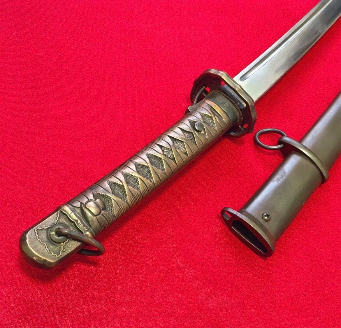

Scogg Posted November 7, 2025 Report Posted November 7, 2025 Here is a tricky one spotted on Facebook. The serial number is the biggest tell, although other details are pretty well done. It’s trying to be a pattern1 copper handle, but it does not stand up to scrutiny. Mekugi is wrong for pattern1, but I didn’t highlight that because sometimes you see that on repaired swords. -Sam 2 2 Quote
Bruce Pennington Posted November 8, 2025 Report Posted November 8, 2025 They are improving on the Kokura and Suya stamps! They still can't get the small, center, Tokyo 1st stamp, though. Yeah, that serial number is bad. No Type 95s have a zero at the beginning of the number. Another tell is the dimpling in the diamonds of the tsuka. They are raised properly, but blurred. So far, they have a hard time making clear, crisp dimples. 2 Quote

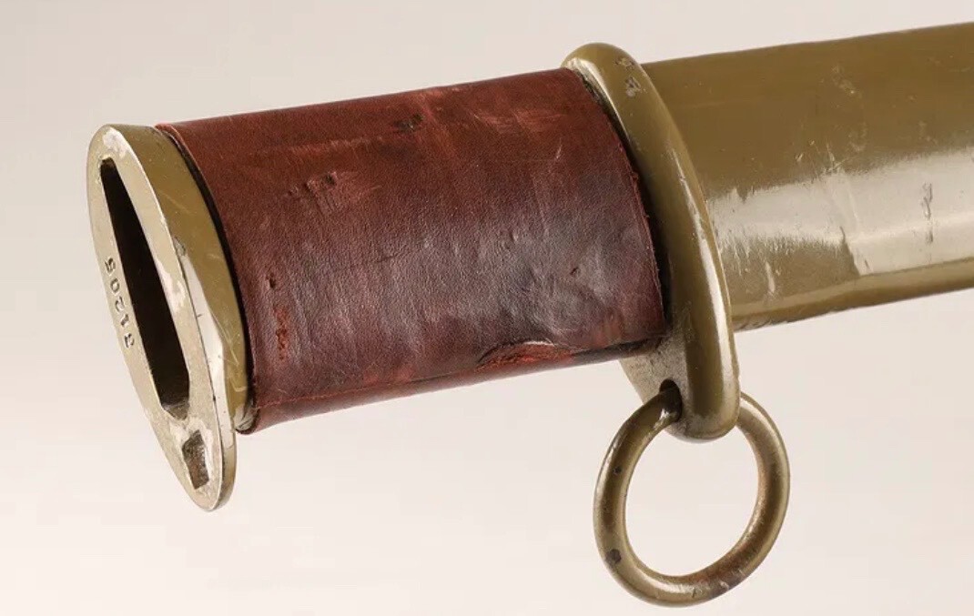

Rawa Posted December 15, 2025 Report Posted December 15, 2025 On 11/7/2025 at 4:24 PM, Scogg said: Here is a tricky one spotted on Facebook. The serial number is the biggest tell, although other details are pretty well done. It’s trying to be a pattern1 copper handle, but it does not stand up to scrutiny. Mekugi is wrong for pattern1, but I didn’t highlight that because sometimes you see that on repaired swords. -Sam Have you ever got serial number starting with 0?? Quote
Scogg Posted December 15, 2025 Report Posted December 15, 2025 2 minutes ago, Rawa said: Have you ever got serial number starting with 0?? No. I have never seen a genuine Type 95 with a serial number that starts with zero. I do have many fake examples cataloged that start with a zero. The example in the photos below are an example of a well-done FAKE. This exact example has appeared on facebook 4 times now, from the same individual, over the last 6 weeks. Varying commenters falsely proclaim that it's legit. Unfortunately it's not real. -Sam 1 Quote
Bruce Pennington Posted December 16, 2025 Report Posted December 16, 2025 You will sometimes see a number with an added zero on Type 32 saya drags after they have been back to the factory for a refurbish/repair, but never on a Type 95. 1 Quote

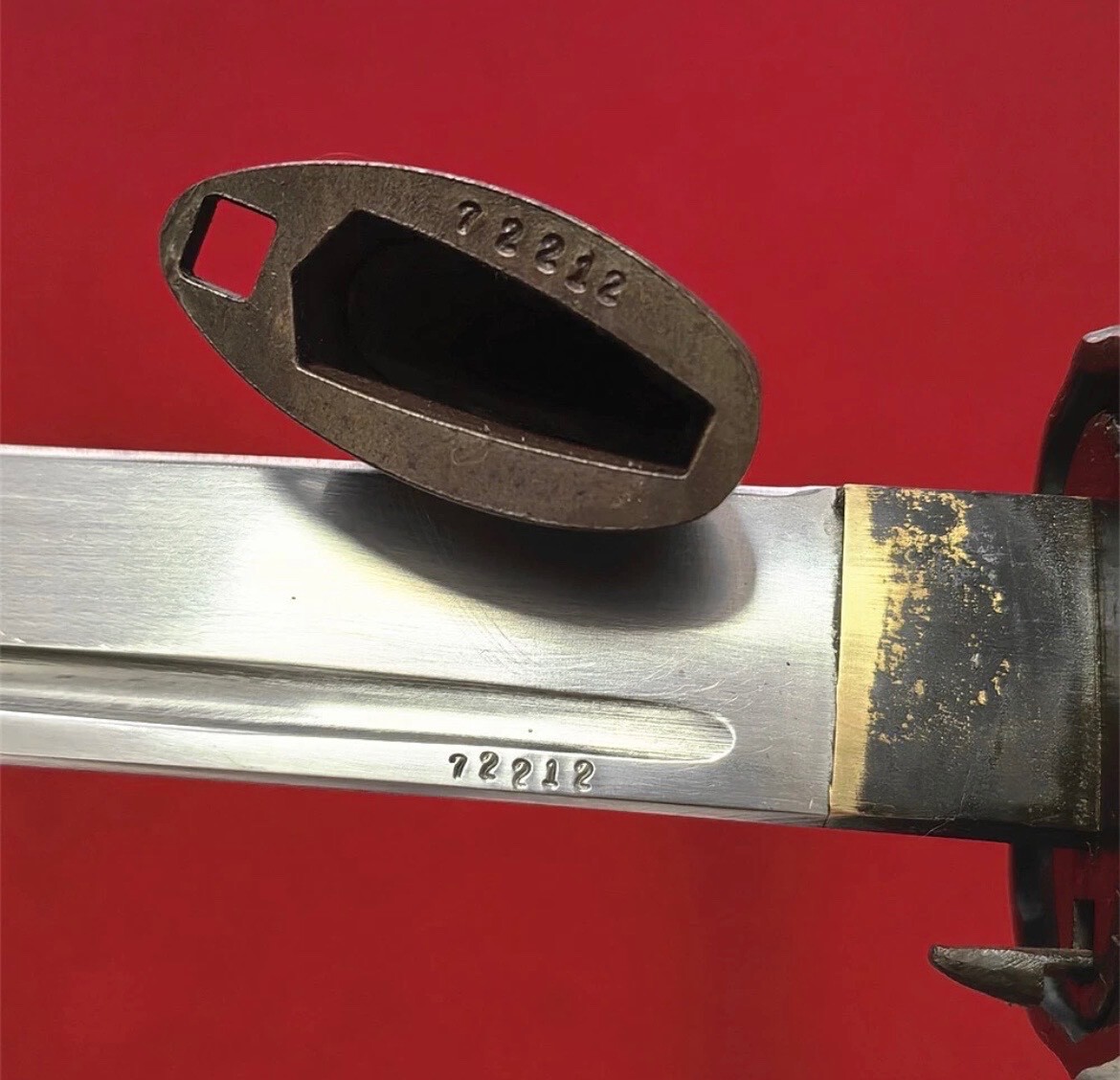

Bruce Pennington Posted January 29 Report Posted January 29 One of the better replicas, Polish?, posted on this Gunboards thread. Attempting to be a Gifu stamped Nagoya blade. Unusual to see one in the 70000 20000 (read that number wrong, originally) number range. These are usually seen in 30000-50000. 2 Quote
