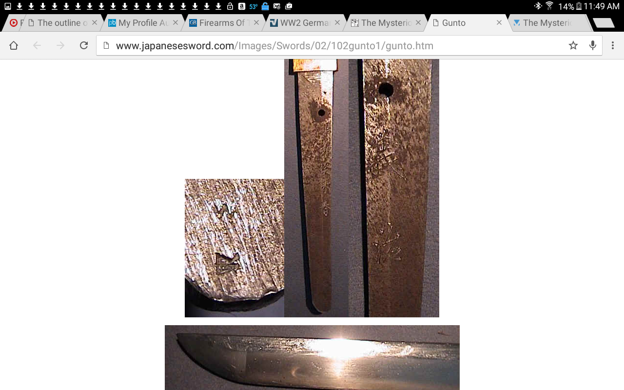

And out of curiosity, I've made a collage of several stamps. It's clear there is quite a bit of variation, so the stamps are made by different shops or arsenals. Still cannot answer JP's question as to whether these stamps were in a machine press or something hand-held and struck with a hammer. Many are struck crookedly, which I have assumed meant hand-held, but the same affect could happen in a press if the weapon wasn't held perpendicular to the stamp.
I'm still puzzled by the fact that so many of them have flat "peaks". There are a couple with pointy peaks, but the majority seem to have flat peaks. If these are supposed to be double-chevrons, I would think they should be pointy.

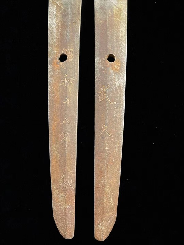

Trystan, here are the characters for the swordsmiths that used the yamagata M stamp: Murakami Haruhisa 村上治久; Takehisa 武久; Tenshin 天心; and finally Yoshiharu (also known as Yoshitani) 義治.  This excludes the Mantetsutō 満鉄刀, Zoheitō 造兵刀, and Type 95 Military Sword 九五式軍刀.

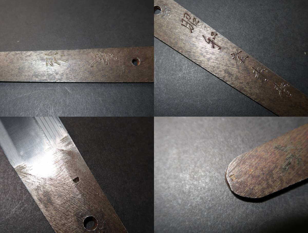

I have a few photos of 村上治久, it didn't show the full tang, can't tell if there is an M mark on the tang, but can see the 東 and the shop marks on Kabutogane.BTW: The handwriting of 村上治久 is very similar to 武久。

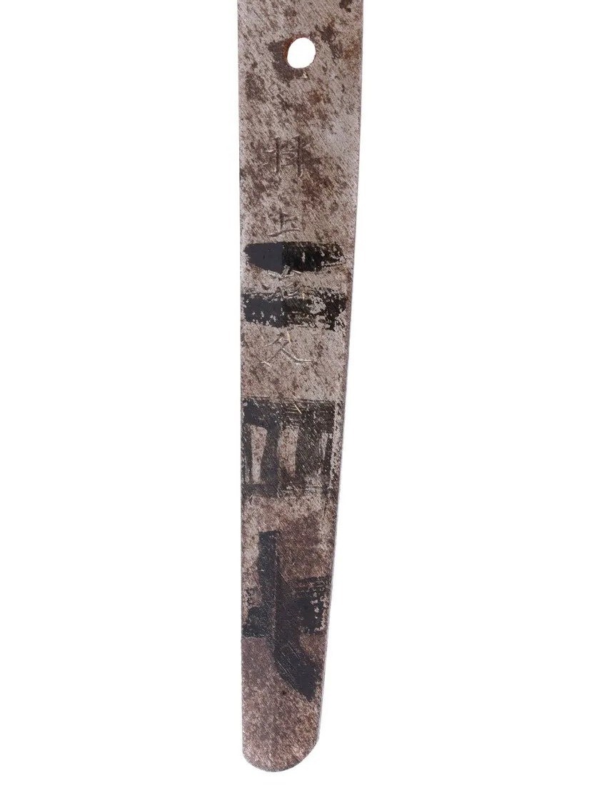

Trystan, I think there is a yamagata M at the bottom of the tang on this Murakami Haruhisa 村上治久.
Black paint: 七五二 = 752.
White paint: 六二 = 62.

5 hours ago, Bruce Pennington said:
On Kaneoto, I'm striking out.  I've got Kaneoto with star, and Kaneoto with large Seki, but cannot find my reference to one with a W.
Maybe the Kaneoto 兼音 that is pictured alongside the Tenshin 天心 was the source of the confusion?  A close examination of the pictures reveals no M stamp on the Kaneoto.  However, it would be easy to get the two swords mixed up though and the Tenshin does have an M stamp.
Type 94 Shin-Gunto Tang Translation: Assistance Appreciated!
I agree, and thanks for an actual example.  I have only had the Slough reference to Haruhisa, from his Mantetsu page, pg 96, until now.

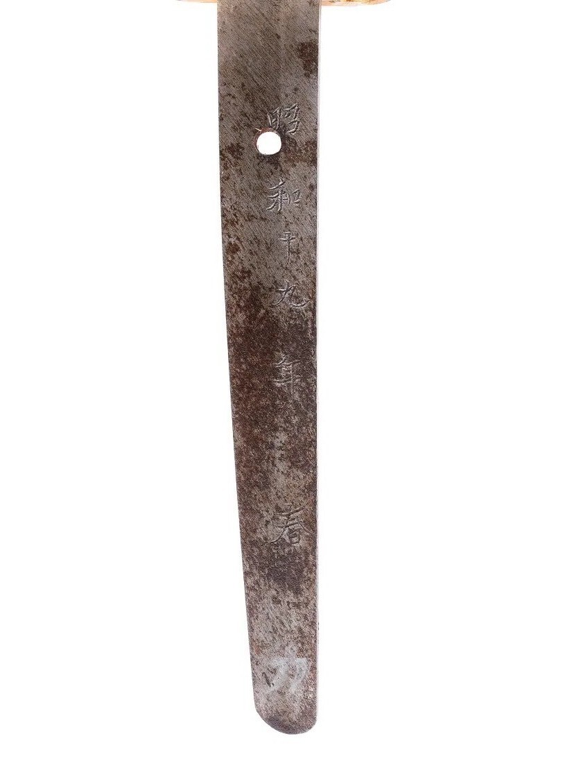

義治 Yoshiharu
1943 Spring
1943 Autumn
1944 Spring
武久 Takehisa
1943 Spring
1943 Autumn
1944 Spring
