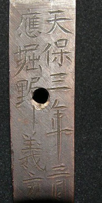

PeterS Posted November 24, 2014 Report Posted November 24, 2014 Dear Everybody! Please help me to translate this kanji. Thans in advance for Your helps. 応堀野義方之需作之 Peter Quote

cabowen Posted November 24, 2014 Report Posted November 24, 2014 It says it was made to the order of a Mr. Horino Yoshimasa, assuming the first 之 is a typo.... Quote
PeterS Posted November 24, 2014 Author Report Posted November 24, 2014 Dear Chris! Thank you very much for your help. Why must be the first 之 kanji typo? I can't belive it that the swordsmith made so big error. Do you think that this sword or the mei is a fake? Thanks. Quote
cabowen Posted November 25, 2014 Report Posted November 25, 2014 I was assuming that you perhaps had made a typo. If not, it just means that the person who ordered it has a different given name than what I indicated. How can I tell if the mei is good or not when I have no photo of it? Quote
PeterS Posted November 25, 2014 Author Report Posted November 25, 2014 Dear Chris! Sorry, i thought you've seen the pictures. Whatever. I attached some pictures about the mei that i download (maybe it is not problem, i bought and i paid the sword). If i get it finally i'll make more picture, if you will be so nice that you help me. Thanks in advance. I don't found nothing about this person. Quote
cabowen Posted November 25, 2014 Report Posted November 25, 2014 Have you compared the signature to valid examples? Many can be find with a Google search. There are many Naotane fakes, many very good ones. Compare your sword signature to 8-10 valid examples and then let us know what you think.... Quote
PeterS Posted November 25, 2014 Author Report Posted November 25, 2014 Dear Chris! I looked few mei. I found the better collection of Naotanes mei here... But if i can to decide it maybe i don't ask for help. I don't know. I found some difference few points of the kanji. For example at the Nao kanji. On the left side has a little line but on my blade wasn't there. But in this topik here i found similar writing of this kanji. So with one word: Idontknow :-D I'm really very grateful for your help and your time spent on me. Thank you very much. All the best to You. Peter Quote
Toryu2020 Posted November 25, 2014 Report Posted November 25, 2014 Peter - attached is a published signature that is considered gimei - I think you will find it interesting for comparison. -t Quote

PeterS Posted November 25, 2014 Author Report Posted November 25, 2014 Dear Toryu! If i made the translation correctly, then my boughted sword is a showa sword, not edo. And the mei is a really fake. Many thanks, that was very helpful to me. Can i know how did you find this picture? Thanks again for your help and time. All the best to you. Peter Quote

Mark Posted November 25, 2014 Report Posted November 25, 2014 Peter Any sword in Japan must have what you call a registration paper, it is required by law. The registration just says what is on the nakago, it does not say if it is genuine or gimei just what is there. A sword by a famous maker is worth a lot of money if genuine and it is easy to get a paper in Japan, so if it does not have a reliable paper that sort of speaks for itself. It is not a Showa sword, if made by Kajihie it would be made in the later 1800's Quote
PeterS Posted November 25, 2014 Author Report Posted November 25, 2014 Dear Mark! In the parenthesis is three kanji (Showato). Or translated i wrong? What made i wrong. Where is on the paper this name "Kajihie" Thanks Peter Quote
Toryu2020 Posted November 25, 2014 Report Posted November 25, 2014 Peter - This Oshigata is from a book by Fujishiro, a study of Naotane, Masahide and Kiyomaro published during the war years. We shall have to examine your blade more closely to determine when it was made as the signature could easily have been added later. Kajihei is the nickname of Hosoda Naomitsu a student of Naokatsu who took to forging famous Shinshinto works when there was no market for swords in the Meiji period. If you can find Harry Watsons' translations of the Nihonto Koza Shinshinto volume there is an excellent article on how to spot gimei and particularly the work of Kajihei that is well worth the cost. -t Quote
