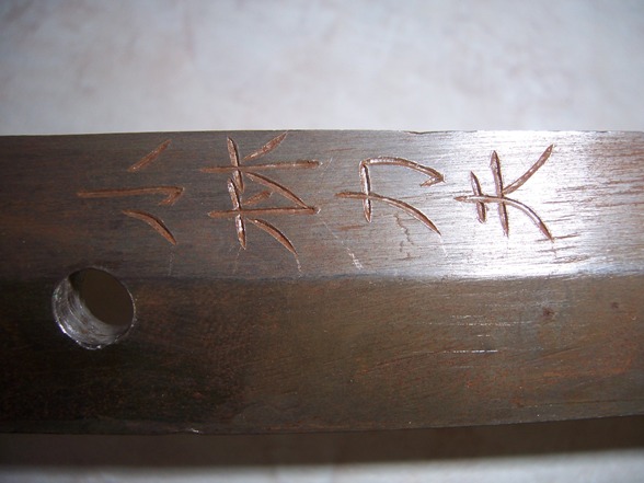

I have a WWII Katana that I know very little about. It is signed and has what looks to be a family crest on the tang. I've included some pictures with this message. Any insight you can offer about this sword would be swell. I love historical items, and hate not knowing anything about them lol.

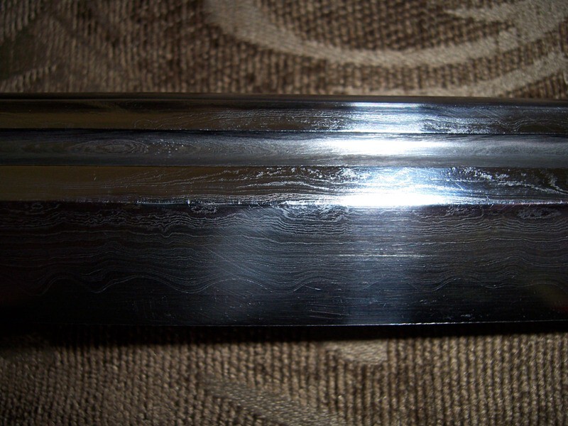

First of all, do you see the swirly, wavy lines running along the blade starting just above the hamon (cutting edge)?
Those aren't supposed to be there. That is a technique used by frauds called "acid etching." It's supposed to make the grain of the steel look real, but anyone who knows what to look for could tell it was fake in less than a millisecond.

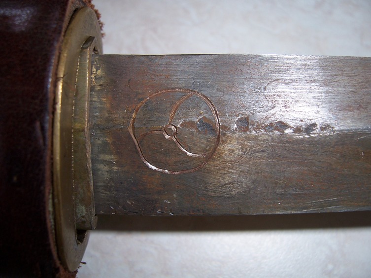

Second, see that beachball (for lack of a better word) on the tang? What you thought was a family crest? I can draw better than that. Even a mass produced showato, nontraditionaly made blade, (of which I own one) shows better workmanship than that. If a real Japanese smith had fudged on a design that badly, he would never have sold that sword.
If it doesn't look like a professional did it... it probably isn't professional.

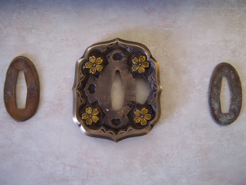

Now turn your attention to the tsuba (hand guard).
Do you see how the main portion of your tsuba is gunmetal in color, but the cherry blossoms are golden? The Japanese government never made gunto (military) fittings like that. They were always uniform in coloration, as per this picture...
http://images.google.com/imgres?imgurl= ... n%26sa%3DG
These photos also show what the rest of the fittings on a well maintained gunto blade should look like.

To summarize with a bit of tact (sadly lacking here occasionally) it is a Chinese fake.
Sorry to be the bearer of bad news. In the links page above, there are some excellent pages with info on how to spot these.
It happens far too often, but with a bit of research beforehand, hopefully others will be saved before laying out money for these modern copies.
I don't think there is any doubt at all on this one though.

C A II is quite exuberant in wanting to help one or two clarifications, 1 you will find true Nihonto with the wavy lines its call hada not deep as in you photos but once you do the book learning (something all Newbie's should do before tearing a sword down) you'll know the different hada's. 2 I have seen true WWII tsuba like yours not very often but there out there. The Net is a great place to learn the above links will give a lot of info without the books.
Indeed, as Stephen said..the tsuba is not far off. I have seen similar. It is the blade that gives it away. Although the grain will show on a genuine sword..it is not this obvious and looks less like damascus steel. This one is done with acid etching. The Japanese pride themselves on their workmanship, and sloppy engraving like this is a dead give-away.
