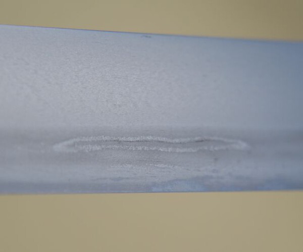

Lee Bray Posted September 3, 2012 Report Posted September 3, 2012 Marius, I've roughly outlined the umegane I refer to. I believe it's an umegane as there is no nie in it, indicating it is different steel added later. Is that what you refer to as the "elongated lens-shaped something"? Quote
Lee Bray Posted September 3, 2012 Report Posted September 3, 2012 You mean the small carbon pit? I can see a complete outline of a patch of steel, at least to my eyes. That pit is on the lower edge of the patch that I see, the upper edge going through the streak of ji-nie, which is why the ji-nie is partially obscured. At least that's how I interpret it and could be entirely wrong. Quote

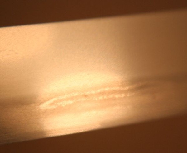

Marius Posted September 3, 2012 Report Posted September 3, 2012 Lee, Jean, it is neither sumigane, nor fukure. It is just an irregular spot in an irregular streak of nie. BTW, this streak has nothing to do with the boshi, it is a metallurgical effect that flows out of the boshi towards the hamachi. Here is the pic of what I mean - this lentil-shaped cluster of nie appears directly in the habuchi. Quote

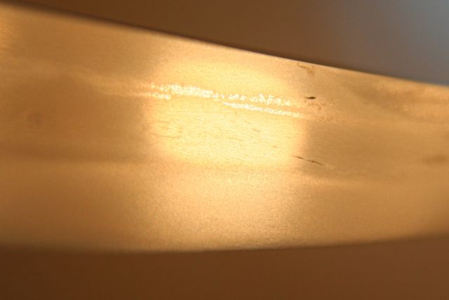

Marius Posted September 3, 2012 Report Posted September 3, 2012 And in the picture here, the nature of those streaks of large nie flowing from the boshi towards the ha/mune-machi becomes apparent. They are pretty brilliant. And so is the lentil-shaped cluster I have showed in my previous post. Sorry for the quality of the last picture... Quote
Jean Posted September 3, 2012 Report Posted September 3, 2012 Mariusz, Lee and myself were dicussing about the carbon pit which for me looked like a small fukure rather than a pit (in the middle of the circule drawn by Lee) and not the nie effect you mentionned. Lee, I did not even noticed on my ipad the patch you mentioned. I have just checked on my main monitor and see what you tried to show on your picture. It is difficult to say without having the sword in hand. On one hand, taking into account the scale of the picture, it may be only a pit and not a fukure, now, on the other hand, all umegane I have seen have , even polished a few times, the borders were well distinct and generally roundish, which is not the case with this one. Quote
cabowen Posted September 3, 2012 Report Posted September 3, 2012 It is an inclusion from forging of steel with a different carbon content than that of the surrounding area. Not quite a fukure, but a kind of flaw. Quote
Lee Bray Posted September 4, 2012 Report Posted September 4, 2012 Jean, you maybe right as a uniformly shaped patch would be a lot easier to apply. I'm still convinced I see a patch of different steel because of the disruption in the nie at its top edge, though. Perhaps it is an umegane, perhaps it is a weird piece of steel in the original kawagane that did not harden the same way as it's surrounding steel. If Marius' picture is showing an inclusion of some kind, as Chris suggests, then that's a possibility. Quote
cabowen Posted September 4, 2012 Report Posted September 4, 2012 It looks as if it is within the hamon- you can not put umegane inside the hamon as the steel is too hard and brittle. Quote
Lee Bray Posted September 4, 2012 Report Posted September 4, 2012 In the picture I posted the patch I refer to is above the hamon. Quote
Marius Posted September 4, 2012 Report Posted September 4, 2012 Lee, Chris, each of you talk about a different spot on the blade. And I can assure you, there is no fukure whatsover in this blade, and just one tiny spot of shingane. What was seen as a fukure/shingane is just a swirl in the long streak of nie. It shows (as has been said many times here) how difficult it is to judge from photographs. Quote
