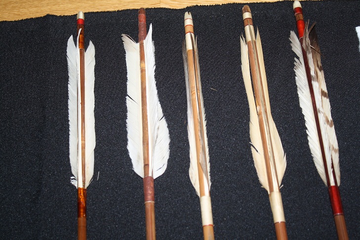

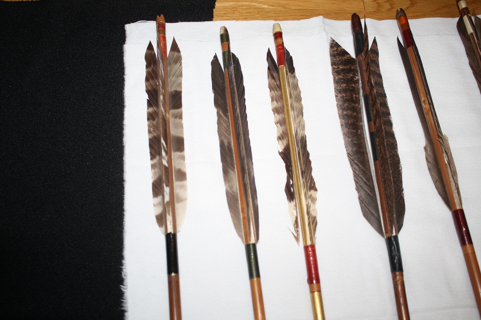

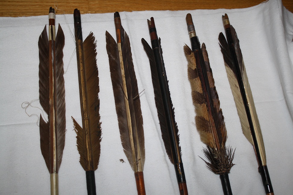

Anthony de Vos Posted August 19, 2012 Report Posted August 19, 2012 Sirs, I'm just starting up my Japanese arrow renovation project. I have plenty of arrows needing fletching as well as new arrowheads. When I made a survey I noticed that among the hundred or so arrows there are at least 20 different birds contributing to the existing feathers. I would be interesting to now what birds since I'm trying to get the original feathers ( there are legal ways even though they are protected) If there are there any ornithologists or bird lovers out there that can intentify enclosed feathers it would be great. I found this list of Japanese birds of pray, anyone able to connect that to the photos? Osprey Pandion haliaetus Misago Honey Buzzard (or Eurasian Honey Buzzard) Pernis apivorus Hachikuma Black Kite Milvus migrans Tobi White-tailed Eagle Haliaeetus albicilla Ojiro-washi Steller's Sea Eagle Haliaeetus pelagicus 0h-washi Northern Goshawk(or Goshawk) Accipiter gentilis Oh-taka Grey Frog Hawk Accipiter soloensis Akahara-daka Japanese Sparrowhawk Accipiter gularis Tsumi Sparrowhawk (or Northern Sparrowhawk) Accipiter nisus Hai-taka Rough-legged Buzzard( Rough-legged Hawk) Buteo lagopus Keashi-nosuri Upland Buzzard Buteo hemilasius Oh-nosuri Common Buzzard (or Buzzard) Buteo buteo Nosuri Grey-faced Buzzard-Eagle Butastur indicus Sashiba Hodgson's Hawk-eagle(Mountain Hawk Eagle) Spizaetus nipalensis Kuma-taka Greater Spotted Eagle(or Spotted Eagle) Aquila clanga Karafuto-washi Imperial Eagle Aquila heliaca Katashiro-washi Golden Eagle Aquila chrysaetos Inu-washi Cinereous Vulture Aegypius monachus Kuro-hagewashi Crested Serpent Eagle Spilornis cheela Kanmuri-washi Northern Harrier(or Hen Harrier, Marsh Hawk) Circus cyaneus Haiiro-chuhi Pied Harrier Circus melanoleucos Madara-chuhi Eastern Marsh Harrier Circus spilonotus Chuhi Family Falconidae English Names Scientific Names Japanese Names Gyrfalcon Falco rusticolus Shiro-hayabusa Pregrine Falcon Falco peregrinus Hayabusa Northern Hobby(or Hobby) Falco subbuteo Chigo-hayabusa Merlin Falco columbaris Ko-chougenbou Eastern Red-footed Falcon Falco amurensis Akaashi-chougenbou Lesser Kestrel Falco naumanni Hime-chougenbou Eurasian Kestrel(or Kestrel) Falco tinninculus Chougenbou Family Strigidae English Names Scientific Names Japanese Names Snowy Owl Nyctea scandiaca Shiro-fukurou Eurasian Eagle Owl(or Eagle Owl) Bubo bubo Washi-mimizuku Blakiston's Fish Owl Ketupa blakistoni Shima-fukurou Long-eared Owl Asio otus Torafu-zuku Short-eared Owl Asio flammeus Komimi-zuku Common Scops Owl(or Scops Owl) Otus scops Konoha-zuku Elegant Scops Owl Otus elegans Ryukyu-konohazuku Collared Scops Owl Otus bakkamoena Oh-konohazuku Borel Owl(or Tengmalm's Owl) Aegolius funereus Kinme-fukurou Brown Hawk Owl Ninox scutulata Aoba-zuku Ural Owl Strix uralensis Fukurou Arrow nr 1 is supposed to be white hawk "shira taka" not on the list, maybe a sub spicies? 1 Quote

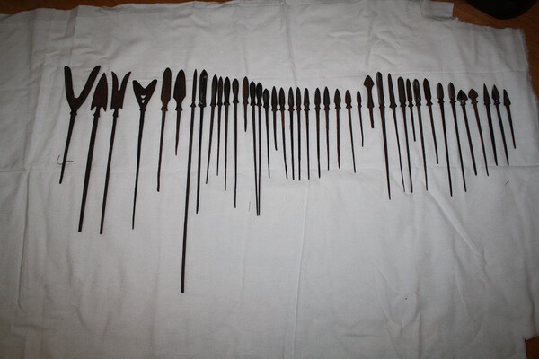

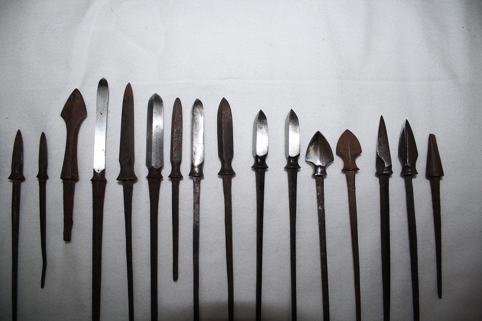

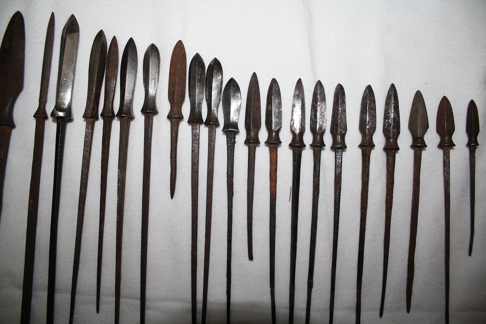

Anthony de Vos Posted August 22, 2012 Author Report Posted August 22, 2012 Hello! I enclose some pictures of arrow heads in waiting to be ensambled with the arrow shafts. Some different models for you Jean, some signed as well. Regards, Anthony 1 Quote
ROKUJURO Posted August 22, 2012 Report Posted August 22, 2012 Wow, what a wonderful collection! Thank you for sharing, very much appreciated! I understand now that you don't need to buy NEW arrowheads. As you are knowledgeable in this field, I'd like to ask again if you happen to know who forged these YANONE. In medieval times, European smiths had a tendency to specialize on a narrow spectrum of their respective craft, so we had up to 46 different professions in the vast field of forging, and of course we had arrowsmiths. Was it the same in Japan? Quote

Anthony de Vos Posted August 24, 2012 Author Report Posted August 24, 2012 Hello Jean! Regarding your question, I'm no authority on the subject but from what I understand there were sword smiths doing yanone and swords. If there also apeared specialist yanone smiths maybe somebody else know? Regards, Anthony Quote

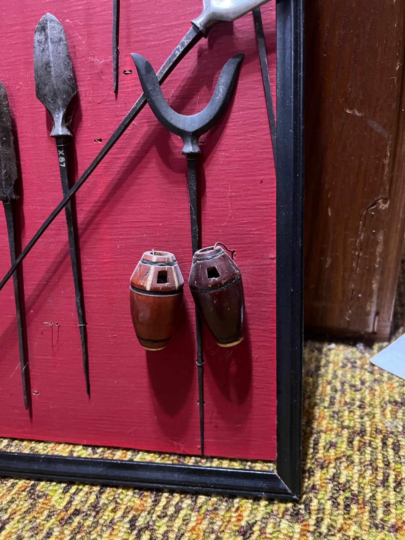

Bruce Pennington Posted June 3 Report Posted June 3 Don’t know the proper place to post this, so I just piggybacked on this thread. One shot of Arrowhead’s from Lee Monson‘s collection. I wish I had taken pictures of the other three cases. This one was interesting because it has wooden whislers. Had not seen these before. 2 Quote
ROKUJURO Posted June 3 Report Posted June 3 Thank you Bruce! Nice YAJIRI, they would fit nicely into my small collection.... 1 Quote
Brian Posted June 4 Report Posted June 4 Big fan of these myself. Have a small collection. Some very rare ones there. Quote
Bruce Pennington Posted June 4 Report Posted June 4 I plan to visit again next week. I'll get shots of the other 3 cases then. He said the two corroded ones at the top were excavated from some old site and believed to be a few thousand years old. Quote
