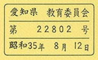

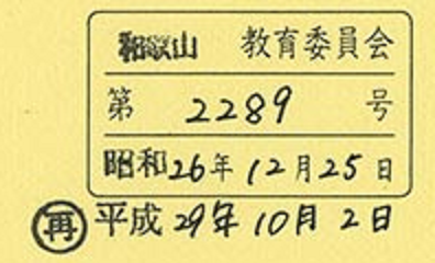

I had a similar origami question to ask, and thought it might be good to keep it in the same thread (Thanks again, Dalton!).  Does anyone know when the torokusho number and date were added to the origami?  As best I can tell, it started in 2013, but I'm not certain.
Attachment 1.  Portion of an origami from 2013.  I've not found any earlier years that have the registration info.  Note the small seal to the left of the registration date line.
Attachment 2.  This one is from 2017.  Note the Showa and Heisei dates, with the seal next to the latter.  These first two attachments are the only two I found with the additional seal.  Also note the registration number and date appear to be hand written on both examples.
