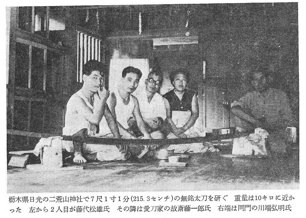

Just thought you'd like to see what a real polishing job looks like!
This old pic shows a group at work at the Futarayama (reading?) Jinja in Nikko in Tochigi. The Daito is mumei and is 7 shaku 1 sun 1 bu (215.3cm - 10kg). Included are 2nd from left: Fujishiro Matsuo and next to him is Sword Lovers House (the late?) Saito Ichiro and on the right is fellow student Kawabata Hiroaki (readings?).
I can remember seeing a sword in a shrine in Okayama that must have come close to this in length...amazing to think a sword like this can not only be made without flaws, but polished in the usual manner (unless it took one man on each end)...even more remarkable that they could keep the polishing "correct"...a tribute to Japanese craftsmen's dedication and skill...I'd insist on sashikomi of course! :lol:
Just out of curiosity, does anyone know how a blade this size would be polished? Just speculation on my part, but I would have thought that contrary to the normal procedure, in this case it would be easier to apply the stone to the steel as opposed to the steel being applied to the stone.
Chris........ your opinion is needed here. ;)
I was at Fujishiro Okisato's place once when they had recently finished a similar monster (by Norimitsu as I recall) and indeed he told me they had to move the stones over the blade. I would bet he learned that from his father who polished the blade in the above photo.
I remember he said the amazing thing about the blade was that it was flawless....I think there may be a video of the process out there...
Yes, it must be stone on blade for sure...I was only tongue in cheek about one man on each end...!! :lol:
Not joking about the sashikomi though...if my memory serves, the long sword in Okayama (I think actually Kurashiki) was a fantastic Yokoyama blade with the kobushigata (fist clusters?) type choji...it was in sashikomi...had to be IMHO.
There was also a very long sword in Hiroshimajo last Christmas...one of the Akabane swords I think...as yet unpolished...it would take some skill to do also.
When you think about it, imagine the skill it must take to impart an even polish, stone applied to steel along such a length of blade. One must stand in awe of the hand-eye coordination required, not to mention the experience it must demand of the togishi. I never cease to be amazed at the skill of a togishi, working with zero technology on a purely physical and experience based level. These guys are amazing! Quite apart from the knowledge of nihonto they need, the control they have of the medium and the blade is astounding.
Ten or so years ago I posted a photo of a high-rankig polisher (Ôno Kôkei?) who polished a similar sword. I think it was the old Bugei forum, but I could be wrong - in any case, I can't find neither the original post nor the picture itself anymore.
Anyhow, the sword was polished using kind of a double-swing suspended from the ceiling; at the ceiling the cords went through a pulley and had counter-weights so the sword could be drawn down. This way a more or less "regular" polish is possible without the awkwardness of moving stones on the blade.
