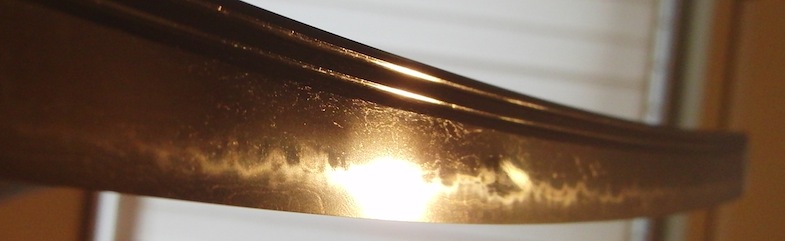

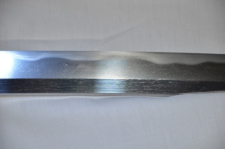

I've got an interesting o-suriage wakizashi that has clear masame hada in the ha.
Is this a particular trait of any school in particular? I think I remember reading somewhere that you see it in Muromachi Bizen swords but can't find the reference.

Thanks for the help Paul. The hamon appears to be mostly nioi and has a Bizen look. The boshi is midare-komi but doesn't have any hakkake.
The nagasa is 23" so it looks to have originally been a 27" katana.

Nevertheless, I distinguish massame in the ji and not only in the ha in the first picture/close up of hada.
I would have thought of Naoe Shizu, togari ...
Naoe Shizu seems a good call, a lot of the features match up well and as you mention the hamon has plenty of togari-ba.

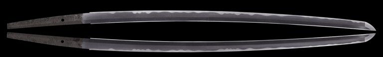

I have seen Juyo Naoe Shizu blades with no masame and with extremely different hada and hamon than mine - With the Courtesy of Aoi Art

I see too many later Mino traits in what I can see in the photo.
I won't explore it too much more without considerable photos, but definitely lean towards Mino.
