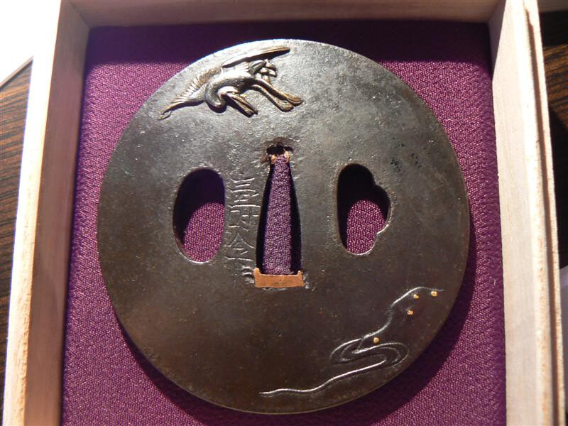

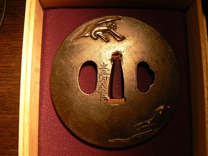

Thank you John for your reply.
According to JSSUS's Kanji Pages, your suggestion is: TOSHI NAGA. Am I correct ? On the other side, the second kanji also looks like KANE (according to the same page).
I don't get "Jumyo John". What does it mean ? Sorry for the probably dump question, just trying to learn.
Many thanks
In this case, the kanji are read as "Jumyo"
Do a Google search or search the forum for lots of info about this prolific group, who were also swordsmiths.
Regards,
Brian
Jumyo sword smiths used 壽命, they made plate for other artists to work on or their own Tosho tsuba. Haynes lists these smiths as 寿命 which I consider incorrect. Now as you noted 壽命 this can be read as Toshinaga , but, there are no Toshinaga tsubako using these kanji. John
Hi Grey, I was thinking the same originally, but, no kanji is this form that I can find other than 'myo' or whatever reading you prefer. To be sure I checked all combo's I could imagine, Hisa, Toshi, Hisashi, Ju and could not find any other likely kanji to combine to a known smith. Other than the Jumyo sword smiths Haynes lists two others using 寿. One Nomura Jumyo (Goshu Hikone ju) and the other Ochi Jumyo a kinko artist. I have no examples to see if they may have really signed using 壽 instead. Doesn't mean I'm right though!! John
