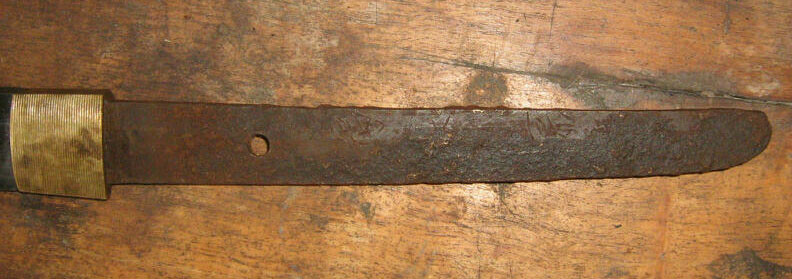

Quite an odd one. When I saw the pics, my thoughts were "blade looks ok, but what the heck happened to the nakago?"
Appears to me to have suffered some seriosu water damage, with only the blade being cared for and not the saya or nakago. That is not normal rust...
When I got the following pic, things are a bit stranger too. Obviously some of the rust flaked off the nakago when the tsuka was removed (Cameron confirmed that) and he knows not to clean the nakago. But I am confused a bit by the nakago shape.
If I had to commit to an answer just from the habaki and nakago shape (nakago jiri too) I would say it is a WW2 blade. But that is a rough guess. Mei is not legible to me at all.
Puzzling. I would like to see this one in hand.

Thank you Brian. I was very carefull when I removed the tsuka. The rust that came out was not enough to fill a tea spoon. I saved it in the hopes of having it carbon dated. I must say that there is something about the copper mekungi that still makes me think. Why would anyone make their weapon unservicable?

The shape and nakago jiri don't look unusual to my eyes except of course for the significant rusting. In one of the photos I can make out some yasuri and the sword certainly looks genuine. As for the excessive rust, there's at least one possible explanation. It was reported that the mekugi was copper. Copper and iron in contact with each other and with enough moisture present could cause accelerated corrosion (rusting) of the iron. Technically the process is known as bimetallic corrosion. If at some point the nakago had also been exposed to salt water and the wood of the nakago retained some salt even after it appeared to be dry, that too would hasten corrosion as salt tends to be hydroscopic and attracts moisture. While the extent of rust or corrosion appears excessive for a WWII era sword, unfortunately it can happen. I own a very nice WWII gendai by Nobufusa the nakago of which looks more like something from the mid 1600's than WWII. The sword was owned by the veteran to whom it was given at a surrender ceremony until I acquired it a few years ago. The vet kept it as a wall display in his home since the end of the war. The blade is in great shape, but as I mentioned, the nakago looks centuries older. The blade that Cameron has isn't what we like to see in such a relatively new blade, but it can happen and my guess is that the copper mekugi was the culprit. I'd venture that the copper mekugi itself is in pretty good condition, since chemically speaking it was protected by the iron sacrificially rusting instead of the copper. I suppose at this date we can't be positive as to what all happened to cause the excessive rust, but copper in contact with iron and water isn't a good idea. Hope this helps to explain what might have happened.

About the nakago, i cannot ascertain the signature but the rust damage is definetely consistent with salt water rust, it is very aggressive and abrasive. It is likely the tsuka at one time was drenched in this and the wood fully soaked which made the rusting process even more agressive. a copper mekugi does not help in this.
I have found the same type of rust damage on WWII items recovered from the beaches in France, as well as on archaological iron finds which came from a salt water environment.
The reason for the copper mekugi could lay in the ease with which wood rots in humid pacific environments. It is seen on Gunto swords from time to time.
One of the good things is that some of the file marks survived. That combined with the part signature might give clues as to its maker. The blade itself, from what i see of the pic with the tsuba looks real. The seppa and tsuba and fuchi look genuine, the saya looks quite like the saya of my own Gunto, aluminum with the same fittings. It looks like a type 94 but i would like to see photos of the top, the attachment point and the bottom parts.

maybe the maker is Fukumoto Kamemune? the silver "mon" was something the owner paid extra to have, it is a nice extra from a militaria collectors point of view

Fukumoto Kanemune? Im not so sure? I have been looking at swords on line that were signed with this name and see some similarities in particularly the 1st kanji but I cannot conclusively decide. file markings are also simmilar.

The silver badge is a mon, the heraldic badge of a samurai family. They crop up on gunto mounts from time to time, often located where yours is, sometimes on the menuki. Quite often they have been defaced so that the mon is illegible, supposedly to avoid disgracing the family name through surrender.
Yours is not a chrysanthemum, it is a mon usually associated with the Sakai family. Always makes the sword more interesting.

PS. From the few strokes that can be seen of the mei,they look typical of the style seen on many ShowaTo, could be wrong but the blade style would tie into that.

I am agreeing with mark. Fukomoto Kanemun(Amahide Kanemune)The above comparison displays the same yasuri mei and there are too many similarities in the kanji to be coincidental, to my eye
Amazing, that the blade is in such good condition and the nakago so rusted. The tsuka has a family mon or crest on it which is usually a good sign that the sword was carried by someone who might have owned a "better" sword. (My opinion) Nobody has asked, but if you look at the cutting edge under and right in front of the habaki, you might see a "flat" or dulled section. This very often indicates a WWII era blade that has retained this flat area. Not 100% rule, but a good first indicator.
I thought with the mei appearing to be close to the mune of the nakago, this might be a good sign since (it seems) most WWII era blades -- Showa-to specifically -- tend to be "signed" down the center of the nakago. Oh yes, the cutting edge length might also be a clue since most of the WWII swords tend to fall into the 25"-26.5" nagasa. Again, not 100% rule but a good indicator for spotting a WWII Showa-to.
