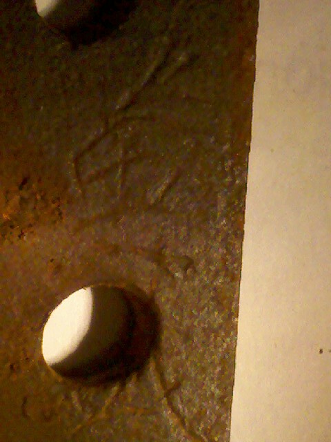

Dannzo Posted January 17, 2011 Author Report Posted January 17, 2011 I reluctantly removed the wooden peg, it wasn't as bad as I thought. Please take a look at the photos below. Sorry, the knife is old and the pictures are not good quality. Quote

John A Stuart Posted January 17, 2011 Report Posted January 17, 2011 It sort of looks like 兼茂 Kaneshige. Of course it may not be. If so, there were quite of few smiths of this name especially around the later Muromachi period. Nijimei Mino-to are notoriously hard to pinpoint from this time. John Quote
Grey Doffin Posted January 17, 2011 Report Posted January 17, 2011 Hi Dan, Allow me to translate. The 2nd half of your sword's smith's name (the 2nd character) has been mostly obliterated by the lower hole in the tang. The 1st character is read, "Kane". In the 16th century in an area of Japan called Mino there were a great many swordsmiths making an even greater many swords (this was a time of constant warfare in Japan). It was the norm for these smiths in this province at this time to sign with art names that began with Kane. It is quite likely, though not 100% certain, that your sword fits here. Maybe someone will be able to read the 2nd character and then we'll know more. If you live in the States and you'd like to ask someone who knows more than you some questions feel free to give me a call. Cheers, Grey 218-726-0395 central time Quote
