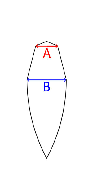

Guest Fungyi Posted January 14, 2011 Report Posted January 14, 2011 Hi All, I found the answer on SBG forums, but would like to double-check here. The intersection between the shinogi-ji and the ji is the "shinogi"; the intersection between mune and shinogi-ji, for convenience sake, I will call the "non-iori-mune-ridgeline". The distance a.k.a. thickness between the "non-iori-mune-ridgelines" can either be similar to the distance a.k.a. thickness between the shinogi's, (as in the case with a "low" shinogi i.e. the shinogi-ji's planes are parallel in one dimension), or it can be drastically different (as in the case with "high" shinogi, where the shinogi'ji's are orientated like an isosceles triangle). In most traditional texts, "kasane" refers to what I call the thickness between the "non-iori-mune-ridgeline", but I find that colloquially it's been referred to as thickness between the shinogi's. That's for both Motokasane and Sakikasane. For the purpose of creating a listing, if I don't want my description to seem overly verbose (i.e. "motokasane" is shorter than "thickness at hamachi"), is it okay if I use the word "motokasane" to mean the thickness between the shinogi's? Many thanks for clarification, Mark M Quote

Guest Fungyi Posted January 14, 2011 Report Posted January 14, 2011 In other words, does "kasane" refer to "A", or "B"? Sorry for not clarifying earlier (you'd think with technology nowadays I should be able to just poke my finger at my screen, draw something and post it ) Thanks, Mark M Quote
Nobody Posted January 14, 2011 Report Posted January 14, 2011 Kasane means the length of A. Kasane Thickness, specifically, the thickness of the mune. Ref. p. 341, The Connoisseur’s Book of Japanese Swords, Kokan Nagayama, translated by Kenji Mishina Quote
Guest Fungyi Posted January 14, 2011 Report Posted January 14, 2011 Yes! That was the first thing I thought of too! (thank you for pointing out that book...I have it too and I guess I really should have referenced that here). But is it just me, or do people seem to use "kasane" and "thickness" interchangeably? Moreover, isn't "thickness" in some ways more important than "kasane"? A big, beafy, heavy Shinto can have a high shinogi, and look ~light~ on paper with a smaller "kasane". But that's not going to make it feel any lighter.... Also, from my humble experiences, the distal taper of the "thickness" is usually linear, whereas the distal taper of the "kasane" can be somewhat exponential, especially if there is funbari (funbari referring to the ~sudden~ increase of mihaba towards the machi's, as opposed to overall profile taper). Kasane can start "thick", then gets thinner and thinner, then stops getting thinner at midway, monouchi or close to yokote, then gets thick again. Which brings up the point, the "kasane" close to the yokote i.e. "saki-kasane" can often be quite thicker than the kasane just a few inches further down towards the machi, because, in the case of high shinogi, the shinogi -ji has to become ~low~ again to make the mitsukado look neater. Because of this ~spreading~ of the ko-shinogi-ji, the "kasane" here within a 2-3 inch area can rapidly increase. Meanwhile, at the machi, the "kasane" is thin to begin with because it is a high-shinogi sword. Therefore, it is possible that the Moto-kasane be very close to the Saki-kasane, suggesting a sword with less distal-taper, when in fact, it could well be a sword with a lot of distal, linear taper. Does this make any sense? Let me know if I should draw another diagram. Thanks, Mark M Quote
Eric H Posted January 14, 2011 Report Posted January 14, 2011 I see it differently KASANE - 重ね - thickness of blade When referring to the posted design: kasane is the line „B“. That said kasane defines the thickness of a blade... there where the blade is thickest. The cross sections of blades have changed during times. Yamato swords are associated with „high“ shinogi... the shinogi thickness is major to the thickness from mune-kado to mune-kado. In Shinshinto times f.e. cross-section is usually different, the thickness measured at the shinogi is often less to the mune section. Examples: Yamato Shizu: moto-kasane 0.7 cm Shinshinto Masayuki: moto-kasane 0.65 cm - saki-kasane 0.51 cm Moroha-zukuri Tanto Norimitsu: moto-kasane 0.9 cm - saki-kasane 0.75 cm BTW you need a special tool to measure the thickness, I have it. Eric Quote

Nobody Posted January 15, 2011 Report Posted January 15, 2011 I believe that Kasane (重ね) is defined as the thickness of Mune (棟). The thickness between Shinogi lines (鎬) is specifically called Shinogi-gasane (鎬重ね), which corresponds to “B” in the previous picture. Refer to the description of the following example. http://www.l-wise.co.jp/super-jsa/aucti ... ode=detail …………………………………… Examples: Yamato Shizu: moto-kasane 0.7 cm Shinshinto Masayuki: moto-kasane 0.65 cm - saki-kasane 0.51 cm Moroha-zukuri Tanto Norimitsu: moto-kasane 0.9 cm - saki-kasane 0.75 cm ……………… According to the pictures attached in your post, actual terms in the 3rd example are moto-shinogi-gasane (元鎬重) and saki-shinogi-gasane (先鎬重), because the 3rd blade is Moroha-zukuri and it has no Mune. Quote
reinhard Posted January 15, 2011 Report Posted January 15, 2011 You better listen to Moriyama-san. Kasane is defined by line A, i.e. thickness of the mune. In Nagayama's book (p.58) you will find the following sentence: "When there is a substantial difference between the KASANE and the distance between the two shinogi, the shinogi is said to be high." This statement leaves no room for speculations. BTW Questioning Nagayama Kokan/Mishina Kenji at this stage of learning will get you into serious troubles understanding NihonTo. reinhard Quote

Guest Fungyi Posted January 15, 2011 Report Posted January 15, 2011 I'm a believer now! I've never seen the kanji. Now I am convinced (as I should have all along) that "kasane" is in fact "A". Many thanks to all who contributed, especially Mr. Moriyama. I hope I may have the chance to continue to learn much from you, and everyone here. Thanks Mark M Quote
