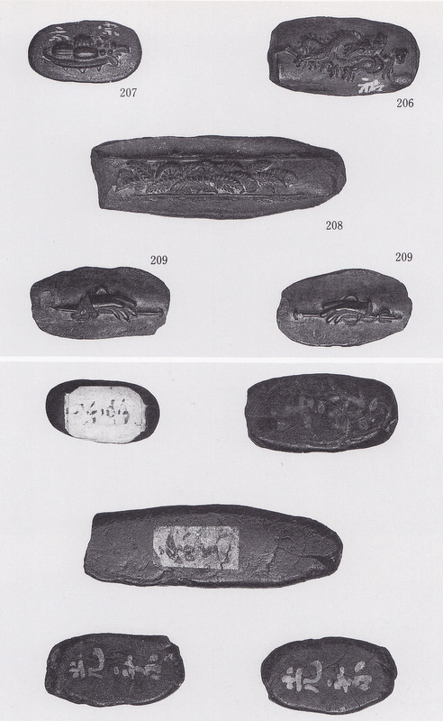

Fantastic work Ford! Thanks for illustrating the process -- very educational. You are giving me a great appreciation of the skill-set involved in making quality tosogu. However, I have a question (or 10...).
In old menuki, there is occasionally evidence of sprues on the backs and rarely I have even seen minute porosity likely resulting from degassing. These observations are suggestive of a casting process leading to some partially formed intermediate product, which would then be worked further to achieve the desired levels of detail. What are your thoughts on this form of menuki manufacture?

Wow. Truly impressive. I would have bet that lost wax casting was used to make menuki.

Boris,
what you are describing sounds awfully like a modern jewellery casting. Casting metal in such thin section purely with a gravity pour, maybe a hand swung centrifuge arrangement, is unlikely in my opinion. Then you have to discover what was used to make the moulds and I doubt clay, however fine, would hold up on such a complex form as a menuki. Consider also the wax model you need to start with. Without rubber moulds and wax injection it would mean each wax would have to be first carved individually. So I can't see any evidence that such a process was ever used in the past.

Ford,
Stunning work, and very informative, as I said elsewhere. I'll be back many times to look more and more carefully.
On the subject of casting which Boris raised, someone - I don't recall now who* - asked me a few years back to help them find a Japanese Museum exhibit catalog (probably) that showed some molds that had been used, perhaps by the Goto. Bob Haynes said that he thought it sounded familiar, but neither he nor I have been able to identify the publication. Perhaps it will turn up one day.

Craig,
perhaps you're referring to these images. They're from the Sano Art Museum catalogue; Sword Fittings by the Family of Goto.1994
These are actually sample imprints taken from completed menuki as a means of record keeping. The actual piece is pressed into a fine, wet clay first and this is allowed to dry. Once the clay is dry, and hard, hot matsuyani (pine rosin, that we use to secure the work when carving etc) is pressed into the clay mould.
There are quite a few such samples in existence in fact. I posted some images of others here on the NMB some time ago when a similar query was raised. I think these sorts of misunderstanding are fairly common when academics try to interpret material without reference to any relevant empirical knowledge that may still be available.

Similar examples are also found in the "Katchû - Abumi - Tôsôgû, Kaga Han no Katchû" exhibition catalogue, 1997.
There are also some wooden tsuba examples.
