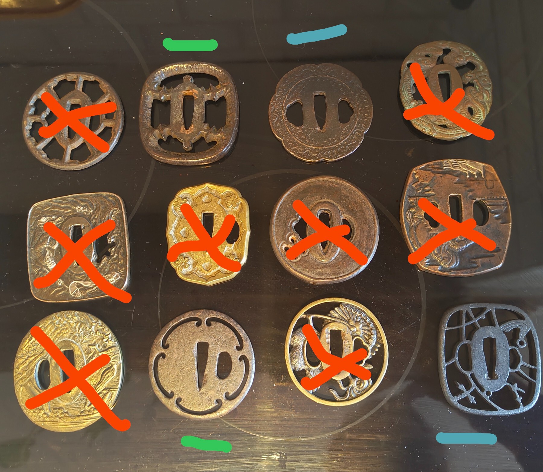

Hi all, so randomly bought some auction tsuba, not for a lot and marked as copies....soooo i kind of knew what I was in for. Anyhow a couple looked genuine to me so went for it as was also looking at some other items.
Have posted a couple of images below, against light and dark back grounds, have not gone into singular images.
from auction photos I thought a couple more would be genuine.....currently I believe 2 to be forged and I have question marks over another 2....IMG_20260806_180605903.thumb.jpg.cac6faeff51127ee4d65f7605aa32478.jpg
But don't want to reveal yet.
Just for future reference, your tsuba photos are oriented upside down.
I agree that some look more promising than others, although I'm not qualified to determine if theyre cast or not. I think some better photo might be needed for the tsuba folks to make a determination.

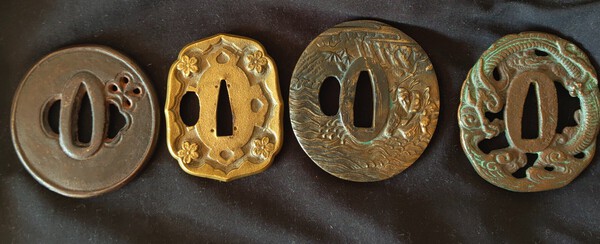

That brass one, with the 4 flowers, appears to be a tsuba for a World War Two shin-guntō (shown from my screenshot below):

I agree with the 4 flowers, I thought it may be a war piece, but also cast.
@Kantaro yes that was my original thoughts, plus the 1st one from the second row.

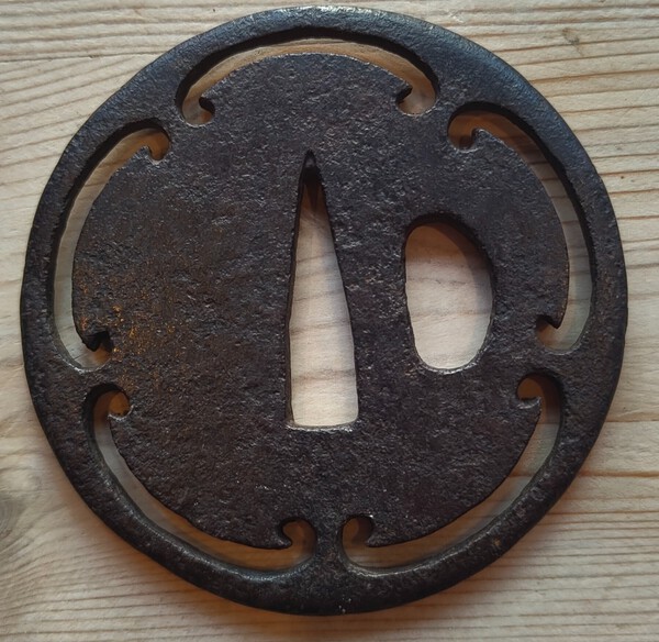

@Hector I thought this was most likely out of the bunch, simple, nice patina, iron sukashi tsuba, maybe early Edo?
Some images below (not against black as I am finding on my camera it just blows out the exposure.)
After going through and looking for seam lines. grainy textures and blown out details I reduced it to the below (I could be wrong, as a complete beginner, just looking for casting marks and no tool marks etc)
The ones with blue marks I am questioning, as certain elements seems off to me for forging, or should I say look more like cast artifacts in the metal work
Really hoping the bottom right is genuine, but have some doubts.

I think the 4 you marked definitely have potential to be genuine and I also like the look of the bottom right tsuba. If you can share some better photos of them tomorrow that would be helpful.

WW2 gunto brass tsuba were all cast as far as I know. Many workshops made them, and they can vary in style and quality quite a bit.
Theres is some debate about whether or not poorer casted examples are repros or late war. I actually have one just like yours, and I’m not certain if it’s a repro or not. See some similar examples here:

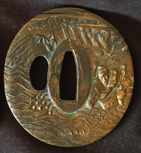

Middle left is a Chinese repro - https://www.rubylane.com/item/2203710-BR-1622-061625-01/Sword-Guard-Tsuba-Brass-Guan-Gong   Sword Guard Tsuba Brass Guan Gong Fortress
As is this one https://www.lot-art.com/auction-lots/A-Japanese-rectangular-bronze-tsuba-embossed-with-a-figure/291-japanese_rectangular_bronze-18.8.20-walli  A Japanese rectangular bronze tsuba, embossed with a figure ...          Bottom second from the right (kinko flowers with signature) could be genuine.

Yes that is what I had come too, the 1st Chinese repro, very Chinese figures, blown out details, painted on silver (I think/plated), Sandy texture,  no seam lines though. On the link you sent,.seems a high price, I'm minted now.
The second link is very interesting, as that's the same tsuba through the same auction, obvs sold separately 6 years ago, thanks for the link.

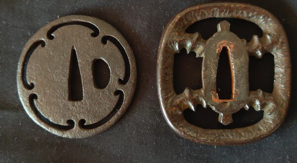

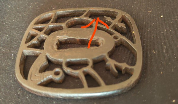

These two are interesting, and I question.

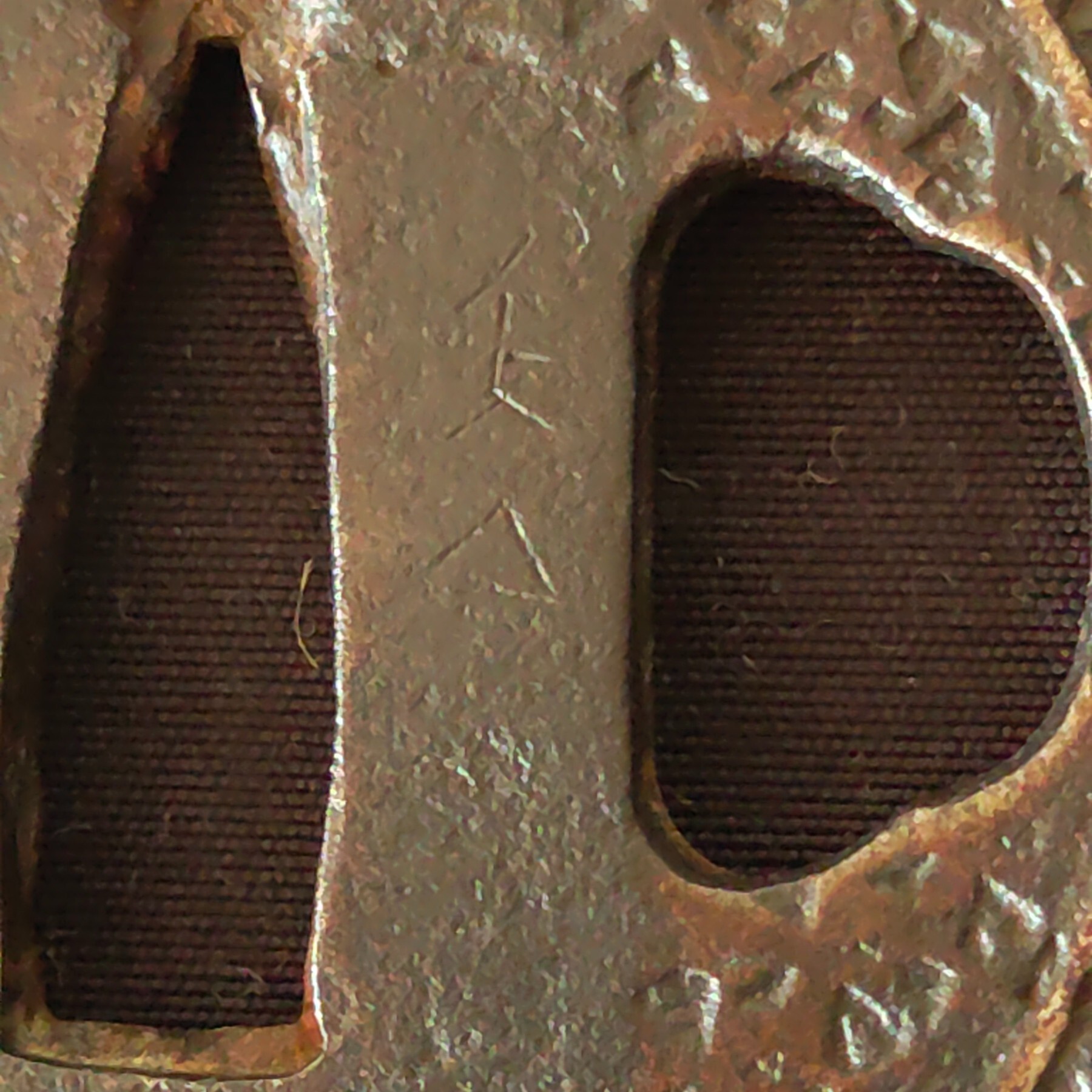

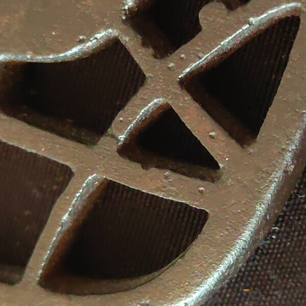

On the sukashi tsuba on the right there are several elements I am not sure about.
Air bubbles in the metal? Also kogai-ana seems 1/3rd smaller than the kozuka-ana (hope I got that the right way around)
A possible seem, but nowhere else can I see it, so could be a product of forging, it's not central and not very straight.....
The tsuba on the left, has a few marks but I think the patina throws me a bit

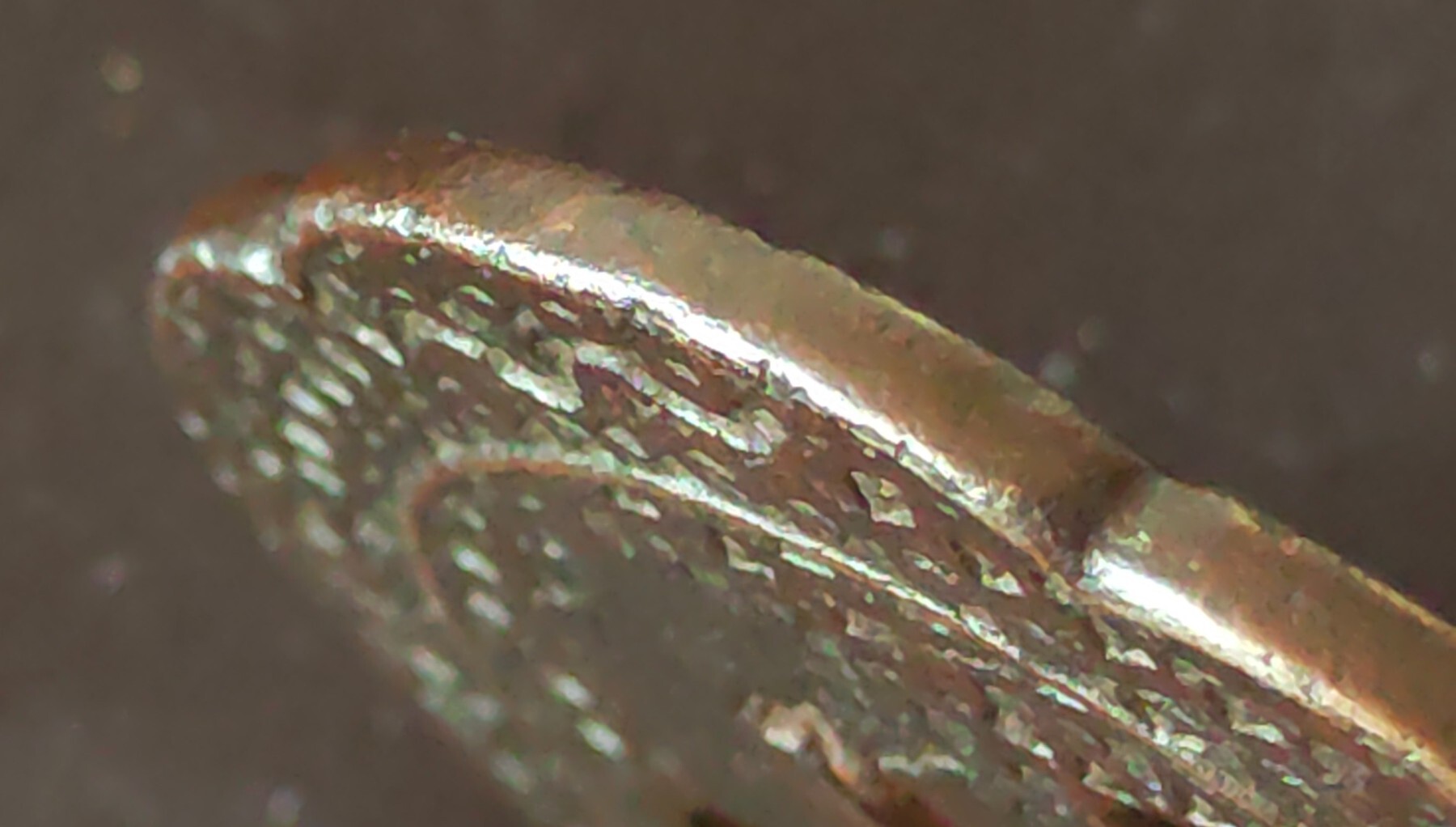

I really thought the brass one was forged, but as you can see there is a very dominant seam line on the inside of the rim
The tsuba on the right, has a very cast surface......and also a seam line running around the rim.

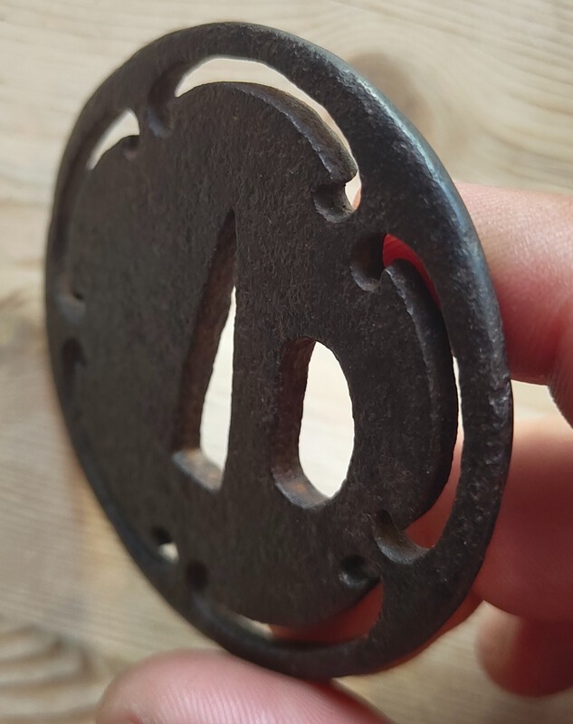

These feel a lot more forged than the rest.....the tsuba on the right is very chunky compared to all the others  (9mm)

What would your thoughts on the square sukashi
I see air bubbles, but also nice sharp edges and a few tool marks. The limited chiseled detail is a bit lacking in its grace.

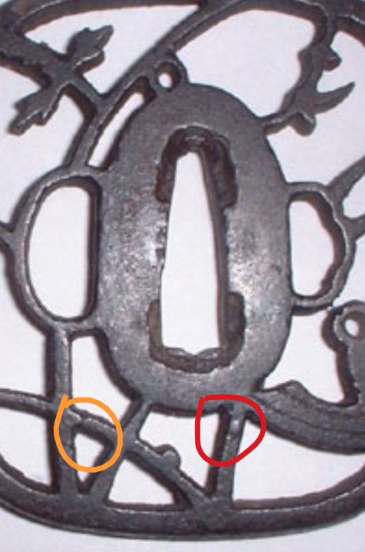

Hi Will,
Thanks for the extra pictures. I'm a fan of Musashino plains-themed tsuba portraying the desolate, poetic Musashi Plain covered in autumn grass (susuki) and featuring a lone stirrup (abumi) to symbolize fallen warriors. However, the small air bubbles and partial casting seam give me an uneasy feeling about your sukashi tsuba. I did an image search and found a website displaying an identical tsuba as cast so I'm inclined to think your tsuba is unfortuantly also cast.
https://www.ksky.ne.jp/~sumie99/tsubacastiron.html
That said, it could fool me, it's not your typical looking cast tsuba and does seem to have sharpe features and tool marks. It's difficult to be sure without seeing it in hand.
Sorry I can't be more helpful.

Posted (edited)
17 minutes ago, Spartancrest said:
    image.thumb.png.879ce42de13a5a2d141db482bb88d842.png It may even be the same piece, the faults are too identical - which means only one example so is it cast? There are many tsuba with smaller hitsu on one side - that would not eliminate it.
Interesting, when on my laptop later might do a wee photoshop overlay.
But from on my phone I think the lower detail on the left on your image is a lot softer than my one, plus in my grab below there does seems to be a artifact near the stirrup.
Could the the photos though. Also just looking again, mine does seem to have slightly sharper edges than on the link....again could just be the photo
W
