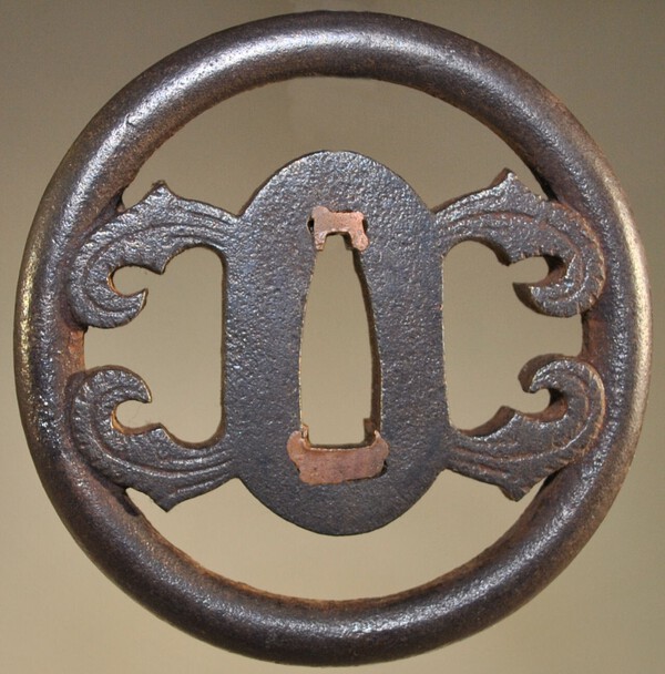

Kiko Posted July 20 Report Posted July 20 Gentlemen, I would like to submit this iron guard (77 x 74 x 6.4 mm – 96 g) to your expert judgment. 1. What could be the purpose or significance of this vertical groove, visible on only one side of the nakago-ana but on both omote and ura ? 2. What motifs are depicted? 3. From which school do you think it originates: Ōno, Myōchin, Higo? Or another? Looking forward to hearing your thoughts! 1 Quote

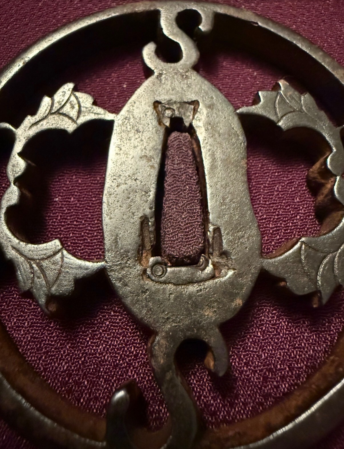

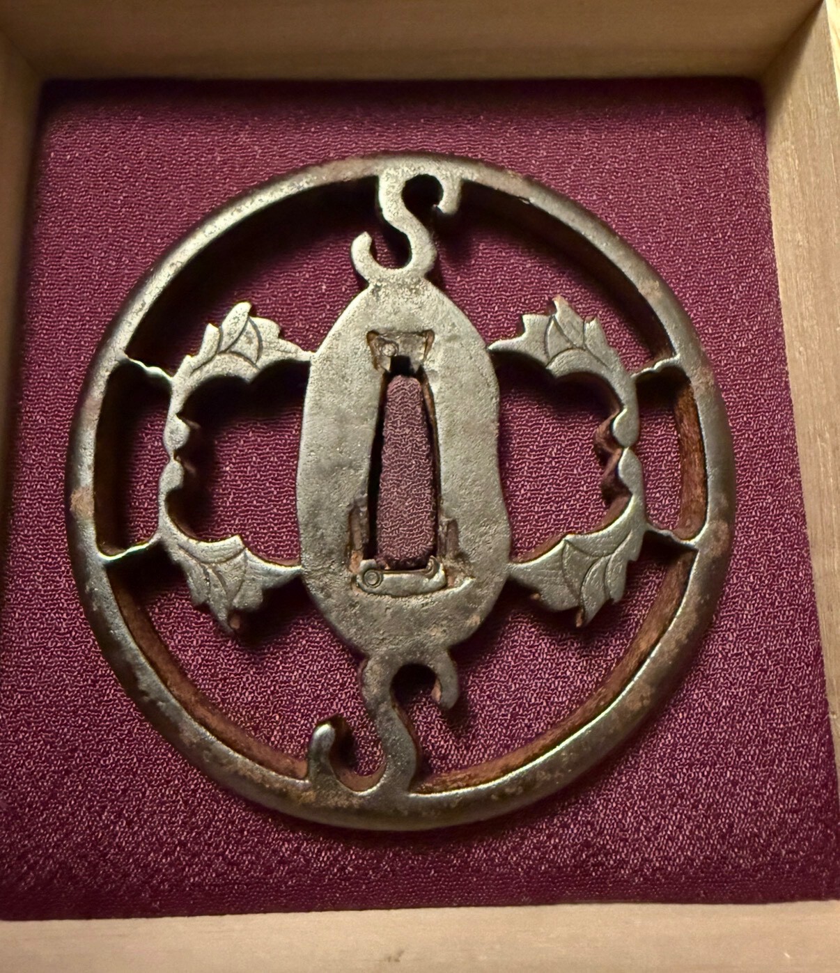

Scogg Posted July 21 Report Posted July 21 Hi Nicolas, nice piece. I have a similar tsuba depicting myoga from the Akasaka school. Akasaka was also the first thing that came to mind when I saw your piece. It’s good to see others are leaning that direction also. Mine also has those grooves; although mine are smaller/shorter. It was my understanding that the punch marks and grooves surrounding the nakago-ana are artifacts from fitting the tsuba to a blade. Manipulating the metal so it fits “just right”. I’m no expert, so I’d be curious if my thoughts here are in-line with the more knowledgable tosogu guys. All the best, -Sam 1 Quote
Kiko Posted July 21 Author Report Posted July 21 Thanks, Sam! I have to say, my initial reaction is that the fact my piece has a kan-mimi rather than the maru-mimi seen on yours, makes me skeptical about an Akasaka attribution. Am I the only one bothered by this detail? As for the grooves, I don't think they should be equated with tagane-ato; they seem far too distant from the nakago-ana—not to mention the fact that there is only one per side. But again, I defer to all your expertise to help further my understanding! 1 Quote

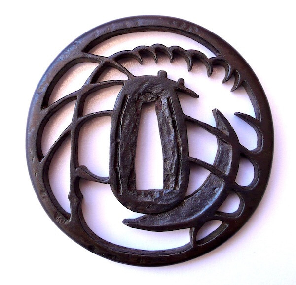

ROKUJURO Posted July 21 Report Posted July 21 I see elements of SADO TSUBA like this one: Image borrowed from John: Sado Island Kazariya Katsukage 2024 3 Quote

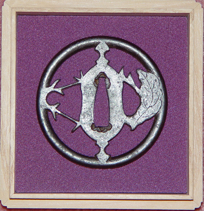

kissakai Posted July 21 Report Posted July 21 It always looked Myochin to me As an example but not papered 3 Quote
Kiko Posted July 21 Author Report Posted July 21 Thanks Jean—I don't know who John is, but I really love the dynamic feel of his tsuba! I'll see what I can find from the Sado region. Grev, I actually saw your tsuba in another thread, and I have to admit that its airy quality—with that floating seppadai—is also very appealing to me. Quote

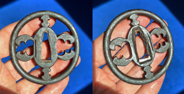

FlorianB Posted July 22 Report Posted July 22 21 hours ago, Kiko said: I admit I didn't expect Akasaka to come up here—what put you on that track? Well, the full-rounded rim is frequently seen on Akasaka pieces, the myoga motif, too. Here's coincidentally an other Akasaka from a fellow collector, note the tagane have been punched more or less to the outer side of the seppa-dai. 1 Quote
Kiko Posted July 22 Author Report Posted July 22 Thanks for clarifying your thoughts, Florian! So, to revisit what I said earlier—but trying to be more precise this time—the rim of my tsuba has an "O" shaped cross-section (kan-mimi), whereas your example—like most Akasaka guards I’ve seen—has a rim with a "D" shaped cross-section (maru-mimi). But perhaps I misunderstood your message; is maru-mimi what you call "full-rounded"? That said, the grooves visible on your example certainly do resemble the ones I was wondering about, and I could see how they might serve the same purpose there as tagane-ato. However, I remain a bit skeptical about the idea that the iron in my piece was ductile enough for a single groove in that location to actually tighten the nakago-ana. Quote

FlorianB Posted July 24 Report Posted July 24 On 7/22/2026 at 9:38 AM, Kiko said: But perhaps I misunderstood your message You do, I'm sorry for this. On one hand I spoke of the "full rounded rim" which is the same as the ""O" shaped cross-section (kan-mimi)" You mentioned. If You research Akasaka You'll come across those rims easily. Her's one I shot at a meeting, (alas I don't know to whom it belongs so I hope I get not in trouble by posting it!) The picture I've posted before has nothing to do with this but was chosen because of the tagane. 4 Quote
Kiko Posted July 24 Author Report Posted July 24 Thanks for the reply and the correction, Florian! I have to admit I was mistaken here; my mental image of Akasaka was very "Sasano-oriented," but a quick check of the Tsuba Shuusei confirms you are absolutely right: out of 111 illustrated guards, five do indeed feature a kan-mimi comparable to the one on my piece. That’ll teach me for being too lazy to pull out the grimoires! 1 Quote
