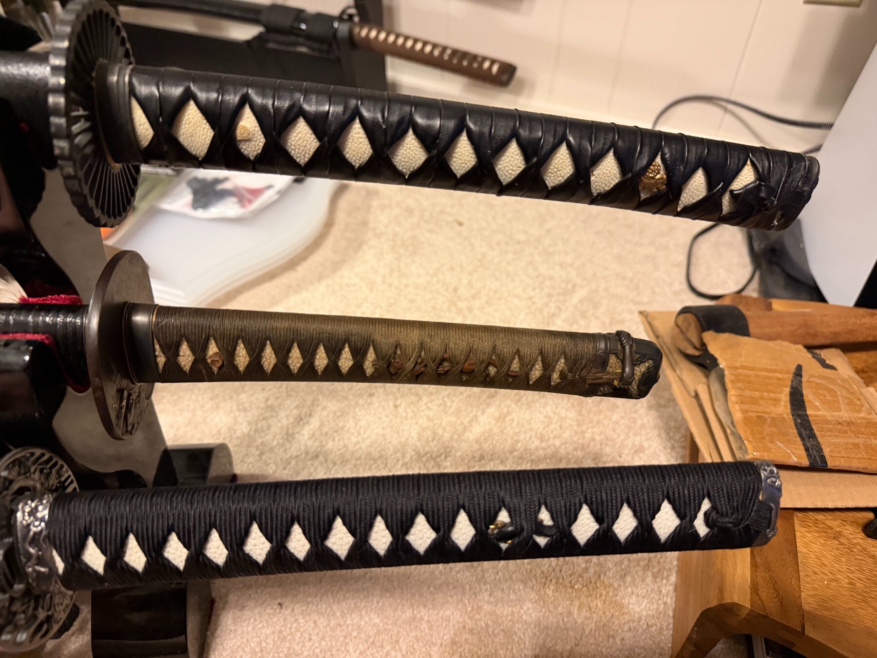

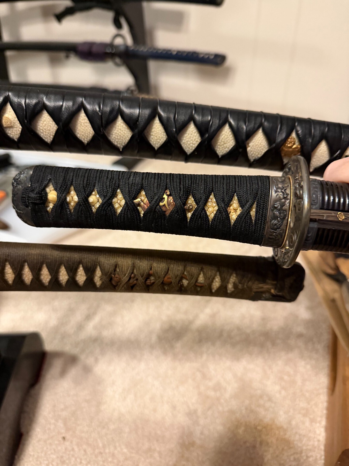

GreyVR Posted yesterday at 02:17 AM Author Report Posted yesterday at 02:17 AM 17 minutes ago, eternal_newbie said: Toyama-ryu style tameshigiri and ZNKR-style iaido (which has strong ties to kendo, and thus also favours a longer tsuka) What you say is absolutely true, but I would like to say I do not refer to tsuka length, but width/diameter/circumference. Here are a few swords in my collection. The top is a Hanwei Practical Plus, which I bought because it was cheap and I wanted to own a katana of some kind. (I'm hoping to put it on ebay soon.) It's nice enough for an entry level Japanese style sword. Look at how BIG the Tsuka is. Under it on the rack is an antique nihonto that I likely paid too much for, and need to have rewrapped as the wrap is rather dirty. (Can you reuse ito? I hear some claim they unwrap yearly and clean it, and other say it must be replaced because you can't retie the knots.) Lest you think this is JUST a Chinese copy problem, I held in the image a sword whose Koshirae I had made for a mumei hozen I bought some time ago. In the second image, I am holding in an antique wakizashi (though the silk is new, the tsuka is the original.) The modern Tsukas are very large around compared to the antiques, and I strongly believe this is a topic that should be talked about much more. @Tim Evans Quote Yes, the interior of tsuka can be enlarged with basic woodworking tools, and also shimmed using thin strips of wood and glue. I have examples of both being done back in the day on old koshirae I have. I would be very interested to know how this is accomplished. I am not a talented woodworker, but I have a cheness tsuka (without a mekugi pin) I'd love to be able to use to feel the handling of a ?tired? older blade in shirasaya I have. How I would get the pin hole drilled I have no notion, even if the tang fit into the tsuka, which it does not. 1 Quote
eternal_newbie Posted yesterday at 03:05 AM Report Posted yesterday at 03:05 AM 50 minutes ago, GreyVR said: The modern Tsukas are very large around compared to the antiques, and I strongly believe this is a topic that should be talked about much more. Among modern Japanese koshirae (iaito, shinken) there seem to be two main styles - the standard tsuka type which is the slightly curved but otherwise near-uniform width form that you dislike, and the other is Higo-style, which is the slimmer, more dramatically waisted form seen on your wakizashi. I also favour the latter and ask for it when ordering iaito (and for my commissioned iai shinsakuto), even though it tends to be more expensive than the thicker "default". Among Chinese copies the problem is even worse; believe it or not, your Hanwei is one of the better tsuka from that early age of production blades. Most of them suffered from what we called "axe-handle syndrome" where the tsuka was (in addition to being far longer and wider than traditional katana) completely straight and of an entirely uniform width from fuchi to kashira, resembling the handle of a polearm or chopping weapon rather than a blade made for slashing and slicing. 1 Quote
