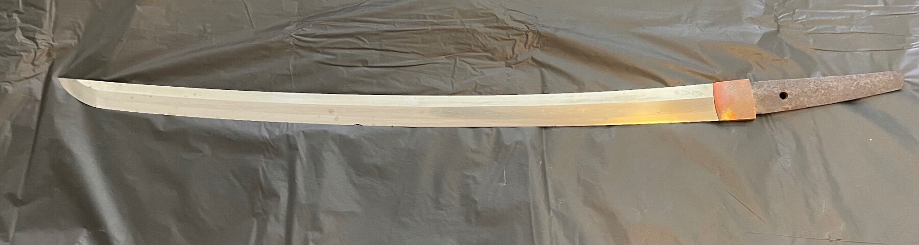

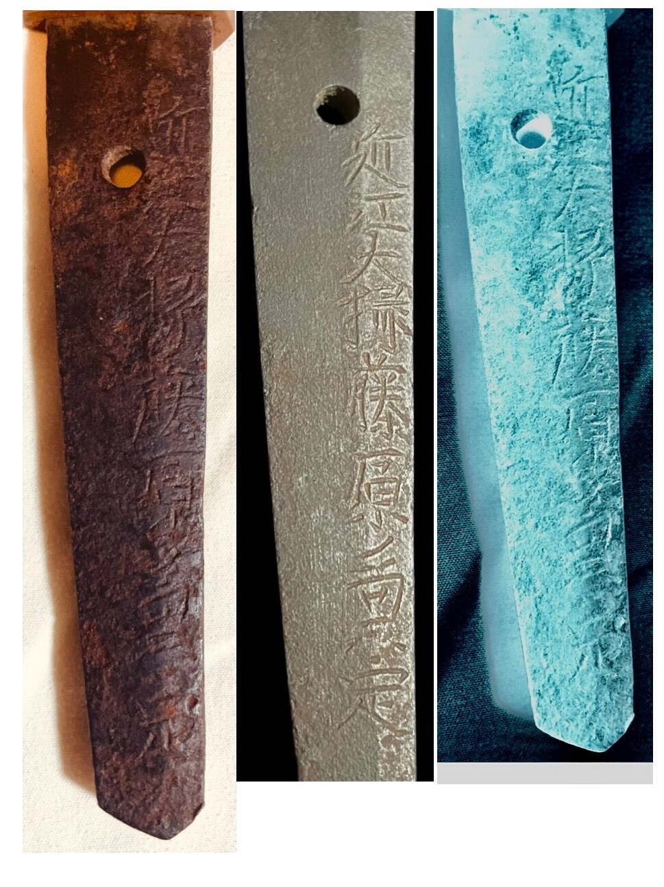

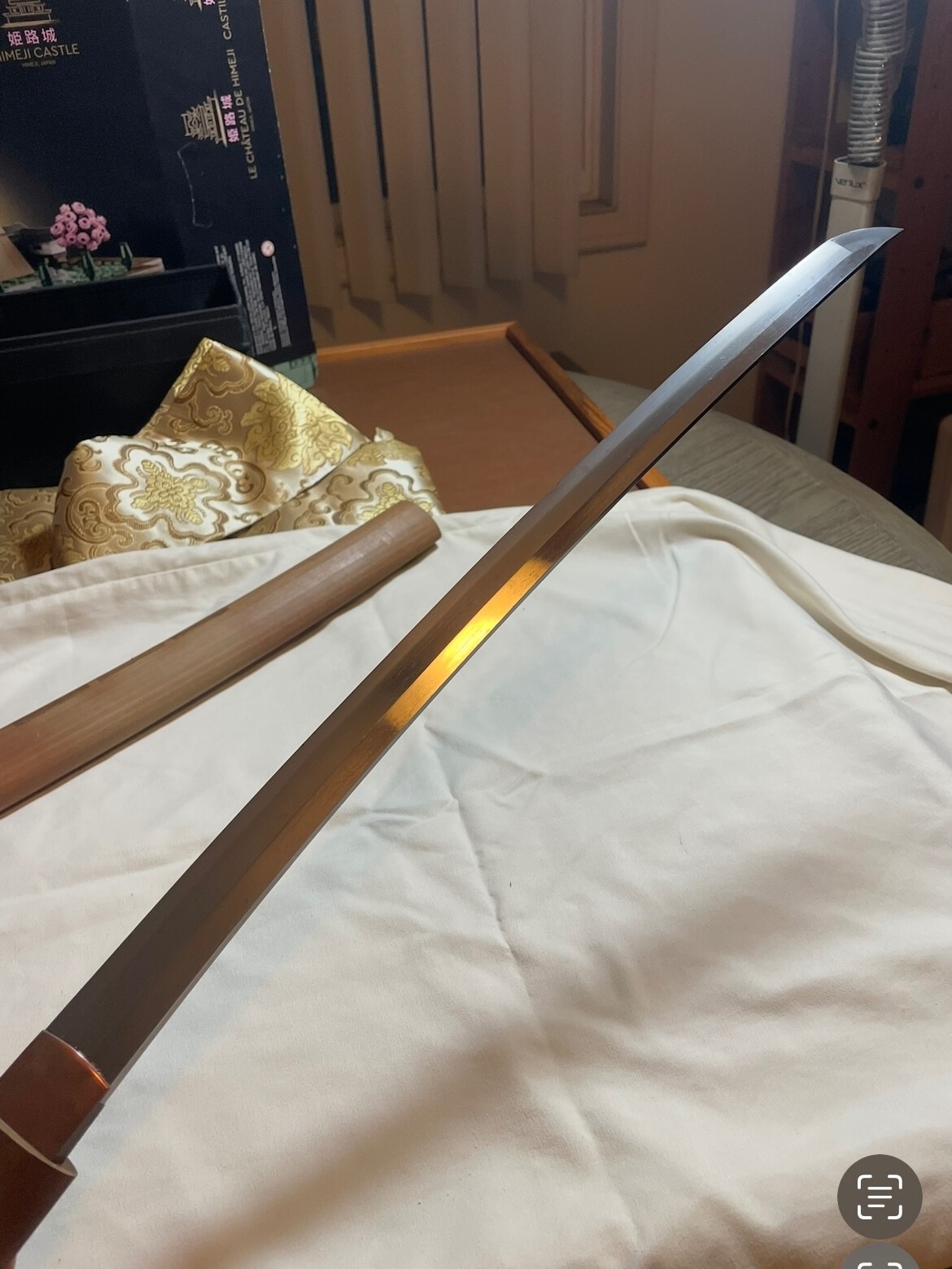

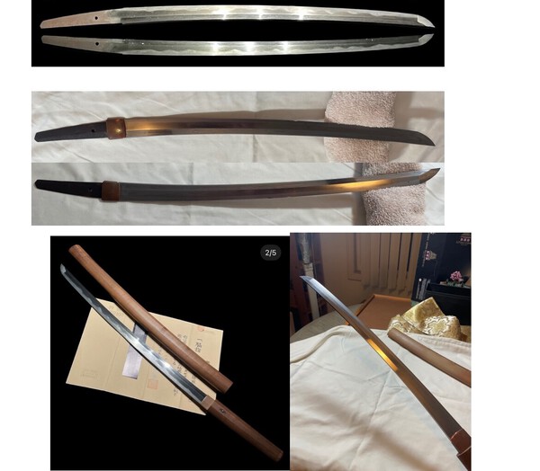

Iwo87 Posted May 21 Report Posted May 21 Hello there, I am new to the world of Nihonto and recently acquired this entry-level study sword. I bought it not as a high-grade collector piece, but as a personal tie to my family history—my ancestors were samurai retainers of the Aizu domain in Aizu-Wakamatsu. As you can see, the blade has significant condition issues: the nakago (tang) shows obvious historical fire damage (saiha/yaki-naoshi), and there is a pronounced chip along the edge. I recently came across a papered wakizashi by the 3rd generation Aizu Kanesada, and I put together some side-by-side pictures for comparisons with my study blade. I would love the forum's insight on a few quick questions: Specs & Attribution • My Blade: Wakizashi // Nagasa: ~46.5 cm (18.3 in) // Shirasaya with copper habaki. • Attributed Smith: 近江大掾藤原兼定 (Ōmi Daijō Fujiwara Kanesada) // Mid Edo period, circa 1660–1740. • Reference Blade (Papers Attached): Aizu Kanesada 会津兼定, Omidaijo Kanesada 近江大掾藤原兼定// Nagasa: 54.2 cm (21.34 in) ō-wakizashi. My Questions for the Forum: 1. Mei & Sugata Comparison: Looking past the fire scale and heavy pitting on my tang, does the Mei on the study wakizashi look like it's Kanesada? 2. Historical Context: I’m curious about the reasons why an owner would go to the trouble, time, and expense to find a qualified artisan to save/re-quench a blade in this condition? What time period would this have most likely happened, and what period would they most likely have had the reason and access to a skilled artisan to do this work? 3. The Edge Chip: Any opinions on what type of impact or stress caused this specific chip? Is it highly probable this damage occurred after the historical retempering? I have attached the side-by-side layouts and close-up details of the tangs. I tried to play around with the pictures of my sword's nakago using different filters to make the Mei more legible. Thank you all in advance for your time and expertise! Best regards, Kyle Top Pic is papered Kanesada, below is my Wakizashi. Left is papered Wakizashi , RT is mine. Middle Pic is Papered Kanesada, 2 other pics adjusted for better visibility are my WakizashiChip in blade Full view of my Wakizashi. Quote
Grey Doffin Posted May 21 Report Posted May 21 Hi Kyle, If you use a black background for your pictures we will be able to see more detail. Why are you so sure the sword is retempered? The large chip likely happened at the hands of some yahoo playing samurai. Grey Quote
Iwo87 Posted May 21 Author Report Posted May 21 Hi Grey, Absolutely not sure if it’s been retempered, just from I’ve read this would most likely what happened after a sword was in a fire. I’ll try your recommendation on taking pics w a black background to see more detail , thanks for the suggestion! Regards, Kyle Quote
Scogg Posted May 21 Report Posted May 21 I agree with Grey, that the chip is more than likely the result of mishandling. Battle damage usually looks pretty different. This sword was sold in January on facebook from a well-known seller. That seller did not state in the description anything about fire damage or re-tempering. I believe that this seller would have mentioned that, because i've seen him sell blades with fire damage before (if i remember correctly). Best, -Sam Description from that facebook seller in January: Quote .... Wakizashi in Shirasaya, signed as: 近江大掾藤原兼定 Omi Daijo Fujiwara Kanesada 近江大掾藤原兼定 Omi Daijo Fujiwara Kanesada is a Mei used by multiple generations of the 会津兼定Aizu Kanesada smith lineage. the 兼定Kanesada smith group of 会津Aizu area (today's Western Fukujima prefecture) is the Edo period descendents of the famous 美濃兼定 smith line. The 4th generation 兼定Kanesada of Mino migrated to the Aizu area by the request of 蘆名Ashina clan, and since then the smithline continued their work all the way until the 11th generation (Meiji period). During the 幕末Bakumatsu period (last stage of Edo period), they worked for the 会津藩Aizu-han clan, who were known to be one of the last Samurai group that strictly follow the traditional way of Samurai, and acted as the major force of the 幕府Bakufu side against the revolutionary 薩摩藩Satsuma-han and 長州藩Choushu-han. The sword of the vice commandor, 土方歳三Hijikata Toshizo, of the famous 新撰組Shinsengumi Samurai group who belonged to Aizu-han, was also made by the 11th gen of Aizu Kanesada. though specific generation is hard to attribute, I personally believe this blade should be from around mid Edo period as shown in the photos, near the middle of the blade, there's a light chip on the edge resulting from cutting hard object —— which is easily removeable during next polish (though sending it to polish just because of this little chip is not recommended). Besides this, it's a handsomely forged blade with neat mid Suguha style straight Hamon, large intact 帽子Boshi on the sharply constructed Kissaki. a lovely piece of history, decent study sample and affordable beginner blade measurement: Nagasa: ~46.5cm or 18.3inches ....... 1 Quote
Iwo87 Posted May 28 Author Report Posted May 28 Sam, sorry the late reply I just saw your post. Thanks for you and Grey taking the time to give me some input! Again, completely new to Nihonto , I was told by a well known expert that the tang Nakago was burnt , then just doing some reading on the internet and using AI I read about burnt blades being retempered. I need to take better pics on a black background as Grey suggests to help analysis. I’m just enjoying researching and trying to learn more about this rough study sword. 1 Quote
Scogg Posted May 28 Report Posted May 28 Interesting. We may need better photos of the nakago. Who was the well known expert who said it was burnt? Attached is a comparison of two nakago from the same smith. This is from one of Tanobe Sensei articles on saiha that I have failed to locate. Both swords by Yasutsuna; the left is normal and the right nakago has experienced fire damage. I got this image from one of Paul Martins posts, in the ancient thread linked here: https://www.militaria.co.za/nmb/topic/2771-this-should-be-interesting/#comment-22963 2 Quote

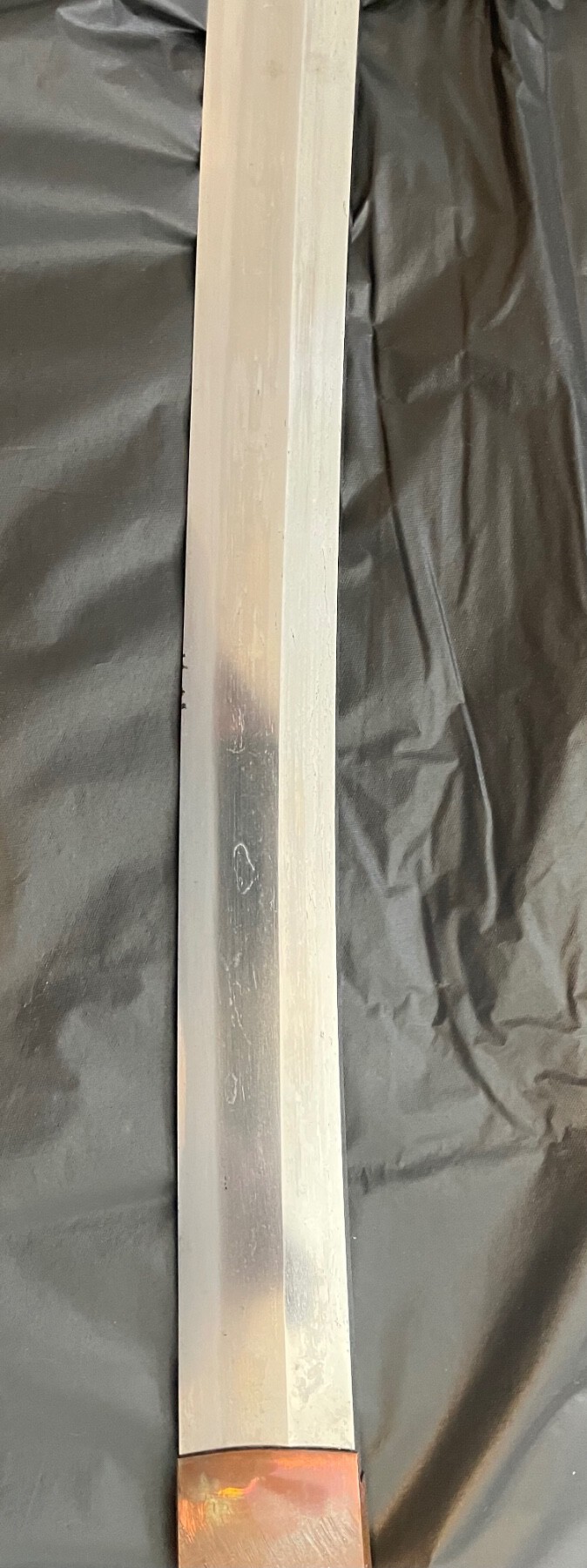

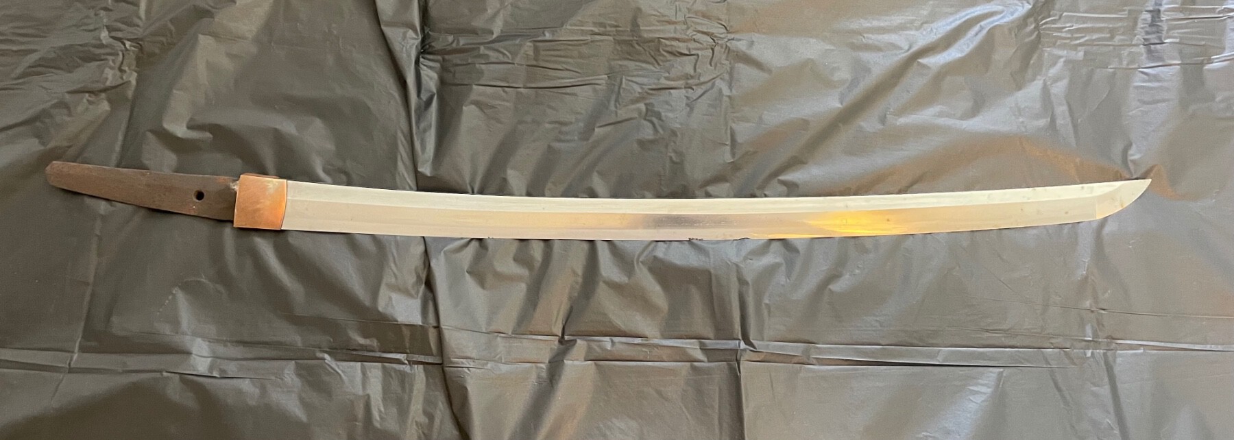

Iwo87 Posted Friday at 09:17 PM Author Report Posted Friday at 09:17 PM Tried take new pics with black a background as Grey suggested but looking at the pics I’m not if it was dark enough. Anyways, do the new pics help at all? Does the blade look retempered, again I have no idea if it is, other I was told the nakago was burnt. Thanks for checking the post out again! Kyle Quote
John C Posted Friday at 09:53 PM Report Posted Friday at 09:53 PM Here is an article by T.C. Ford that outlines some of the characteristics of a retempered blade. Since you have the blade in hand, walk through his points and look carefully at the blade. You may or may not find some of those characteristics. Also, he estimates that 10 percent of the blades in the US are retempered, so there is a 90 percent chance it is not! John C. retempered blades.pdf 2 1 Quote
