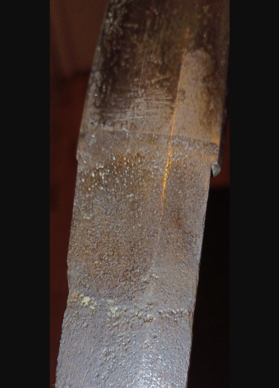

Vampyres Posted March 27 Author Report Posted March 27 2 minutes ago, Scogg said: @Vampyres, I’ve merged your newly created topics to this old one again. Please reply to this ongoing topic, instead of creating new topics I have cleaned the blade to see the hamon line but I have not touch the tang is that bad or good Quote

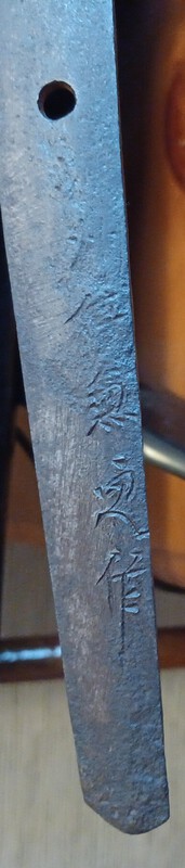

Bruce Pennington Posted March 27 Report Posted March 27 I can see why that pit looked like a Seki stamp in the original photos, but with the better lighting, I see that it is not. I am often the first to see stamps that aren't there! Ha! John, You didn't say how you cleaned, but, yes you are correct in not cleaning the nakago (tang). Please never do that. If there is orange, active rust, we want to stop that, but not clean it. Here is a good page about blade care: Japanese Sword Care - Japaneseswordindex.com Quote

Vampyres Posted March 27 Author Report Posted March 27 This is all kanji that can be seen because of the rust on the tang am not going to remove it because you will destroy its value Quote
Rawa Posted March 28 Report Posted March 28 (edited) If nakago wasn't altered what about inconsistent yasurime? I wonder could this be forgery or muromachi blade repurposed for gunto fittings by machi okuri. Funniest option would it be if this is originally Bizen sword with fake Mino Seki signature. Edited March 28 by Rawa Quote
raaay Posted March 28 Report Posted March 28 John, a basic rule of thumb never clean the tang , sometimes it is acceptable to remove active rust on the tang , but you really need to know what you are doing first . looking at the tang again , it could be signed No-Shu Ju Kanesada saku ? which would mean it is a WW11 sword . 1 Quote

Rawa Posted March 30 Report Posted March 30 (edited) @Vampyres @Scogg simply said that we are "dumpster divers" :D Those marks on nakago looking like welding couldn't be done by loose tsuba ratling. I'm adding closeups of this nakago area and as a reminder that all can happen photo of nakago made to "mount them all" [from gunto koshirae] Edited March 30 by Rawa Quote
