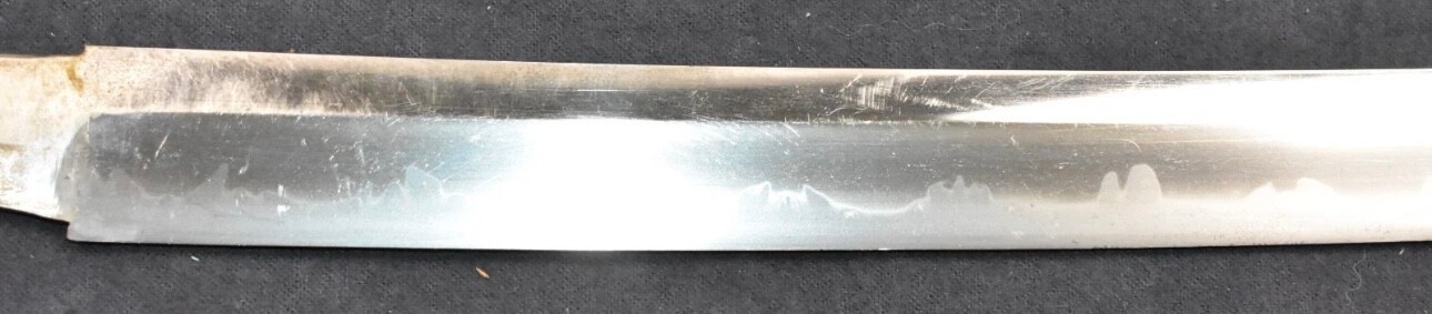

Swords Posted December 17, 2025 Report Posted December 17, 2025 I have 2 swords am interested in seeing what others think The saya looks polished the tsuka has a nfl wrapping and Interesting hamon 1 Quote
Brian Posted December 17, 2025 Report Posted December 17, 2025 That nakago was severely messed with. Junk with an acid wash 2 Quote
John C Posted December 17, 2025 Report Posted December 17, 2025 Steve: Saw those on ebay as well. The hamon looks a bit like the Yokoyama school choji pattern. But like Brian said, the nakago is scary. Not sure what someone did to it. John C. BTW, while folks on Ebay still use the term NLF, we prefer not to as these swords were Army swords and not particular to any one group or unit. 1 1 Quote
lonely panet Posted December 17, 2025 Report Posted December 17, 2025 (edited) Holy fukkballs batman, The joker committed fukkary on that sword. Quick to the batcave to cry Edited December 17, 2025 by lonely panet 3 Quote
Hector Posted December 18, 2025 Report Posted December 18, 2025 I suppose that's one way of making a mismatched nakago and tsuka fit. Usually, they file out the wood but this guy has 'ski-sloped' the metal tang instead. 🤣🤣🤣 Quote
Swords Posted December 18, 2025 Author Report Posted December 18, 2025 I wonder what was the purpose of acid etching John I know what you mean about the NLF just used it for sword reference At my least it has an interesting hamon Too bad the guy messed with it Quote
Bruce Pennington Posted December 18, 2025 Report Posted December 18, 2025 The acid etching is something and Joe Bloe and do which gives an appearance of a full polish to the untrained eye, without spending thousands of dollars for a real polish. And as an FYI, all the fittings, not just the tsuka, are Rinji Seishiki (Type 3; Type 100; Type 44; etc; etc). 1 Quote
Hector Posted December 18, 2025 Report Posted December 18, 2025 Took a second look and just noticed the boshi appears to run completely off the kissaki. IMHO that's the kind of thing you should be looking out for rather than the fittings. 1 Quote
