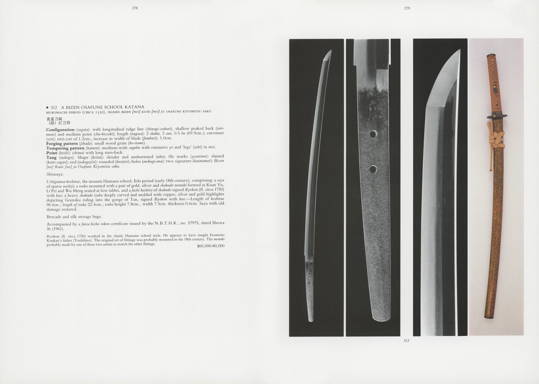

Jacques Posted Friday at 03:50 PM Report Posted Friday at 03:50 PM 16 hours ago, Lewis B said: Agreed, it appears to be Kiyomitsu. Lanes Armoury got it wrong. Ura side of the nakago isn't shown but my guess is that a nengo is absent https://www.thelanesarmoury.co.uk/shop.php?code=24324 No nengo = gimei.... 2 1 Quote
Jacques Posted Friday at 06:51 PM Report Posted Friday at 06:51 PM Does the person I made laugh have a valid point to make? Quote
CSM101 Posted Friday at 08:17 PM Report Posted Friday at 08:17 PM From the Compton Collection: Kiyomitsu without nengo. So it must be gimei. 1 1 1 Quote
Jacques Posted Friday at 09:45 PM Report Posted Friday at 09:45 PM So what? Just because it's in the Compton collection, does that mean it has to be soshin? All Bizen Osafune swords with a nagamei and an ubu nakago have a nengo, since OEI. 1 Quote
Jacques Posted Friday at 10:17 PM Report Posted Friday at 10:17 PM (edited) I would like to add that the shape of the nakago does not correspond to what Kiyomitsu was doing at that time (and that's not all...). https://www.toukenkomachi.com/index_ja_tachi&katanaA040425.html Edited Friday at 10:32 PM by Jacques 1 Quote
PNSSHOGUN Posted yesterday at 01:42 AM Report Posted yesterday at 01:42 AM Jacques raises a good point, the overwhelming majority of good Sue Bizen works with long Mei will feature a Nengo. For those who own Sue Koto vols. Iⅈ you will be hard pressed to find an example that doesn't follow this pattern. There will be exceptions out there, but they are certainly not the rule. 2 Quote
Jacques Posted yesterday at 09:53 AM Report Posted yesterday at 09:53 AM (edited) I should point out that I am referring to Chumon-uchi mono produced by skilled smiths (those showed in literature), not kazu-uchi mono or swords forged by obscure craftsmen. Edited yesterday at 09:55 AM by Jacques 1 Quote

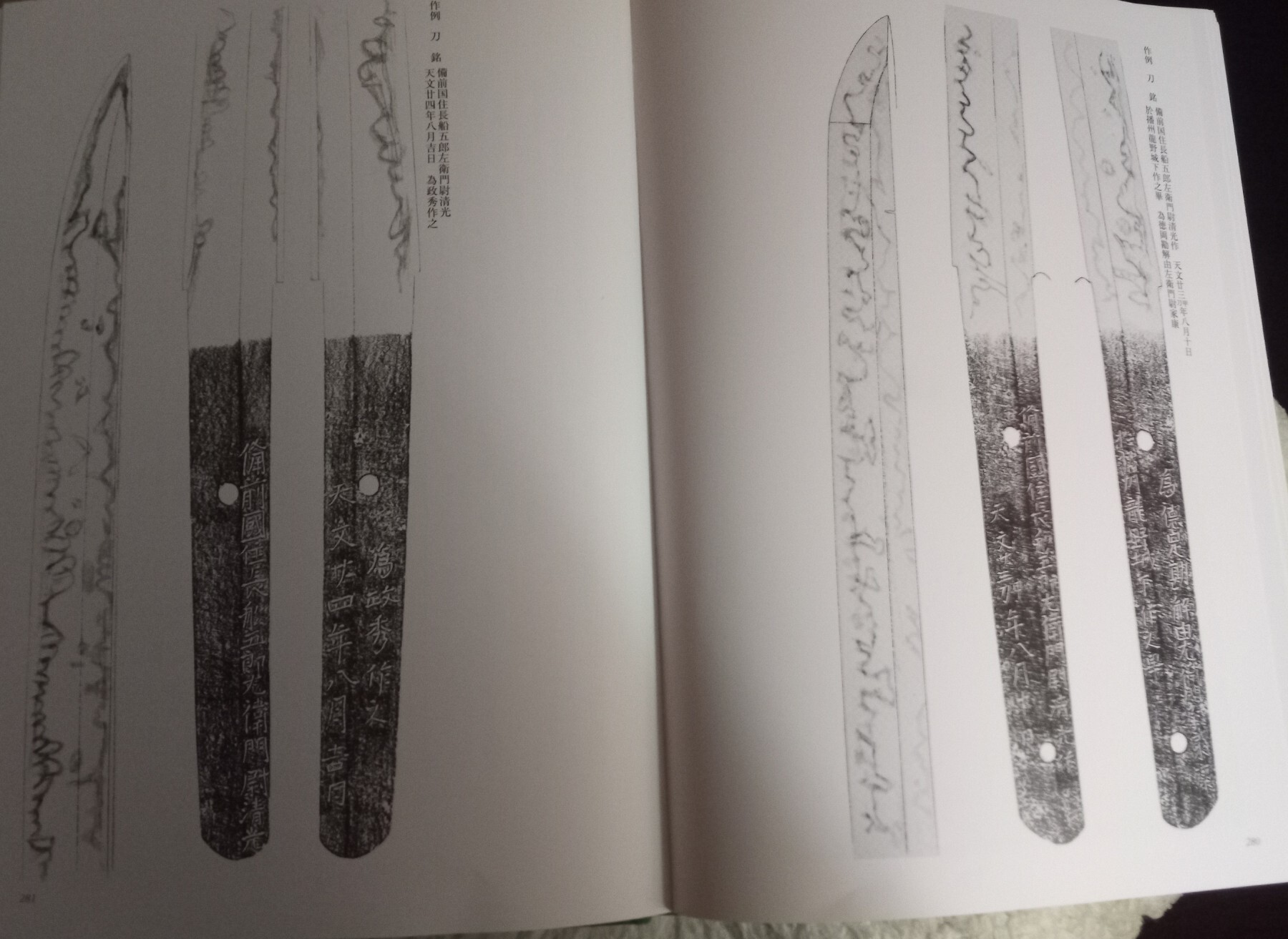

CSM101 Posted 23 hours ago Report Posted 23 hours ago Bizen Osafune Yozo Saemon no jo Sukesada. No nengo. There are speculations that the date was removed . 2 Quote
klee Posted 16 hours ago Report Posted 16 hours ago Very intersting piece @CSM101 ! Havent seen that one yet from all the sue bizen I looked through over the last few years. Reminds me of the magnicicent Kiyomitsu sword I currently own https://eirakudo.shop/token/wakizashi/detail/319916 I took a shot and emailed Mr Sesko about it and he was very generous to respond to me His #1 reason is what I would assume happened to this Sukesada 2 Quote
CSM101 Posted 15 hours ago Report Posted 15 hours ago Well, if you look hard enough you can find more examples without a date. Take the DTI catalogue from 2014. There are 3 different katana by Bizen Osafune Harumitsu. 2 have a date, one hasn't. Bizen Osafune Sukesada are sometimes without a date. Yes, most swords from Bizen have a date. But there are exceptions. 1 Quote
