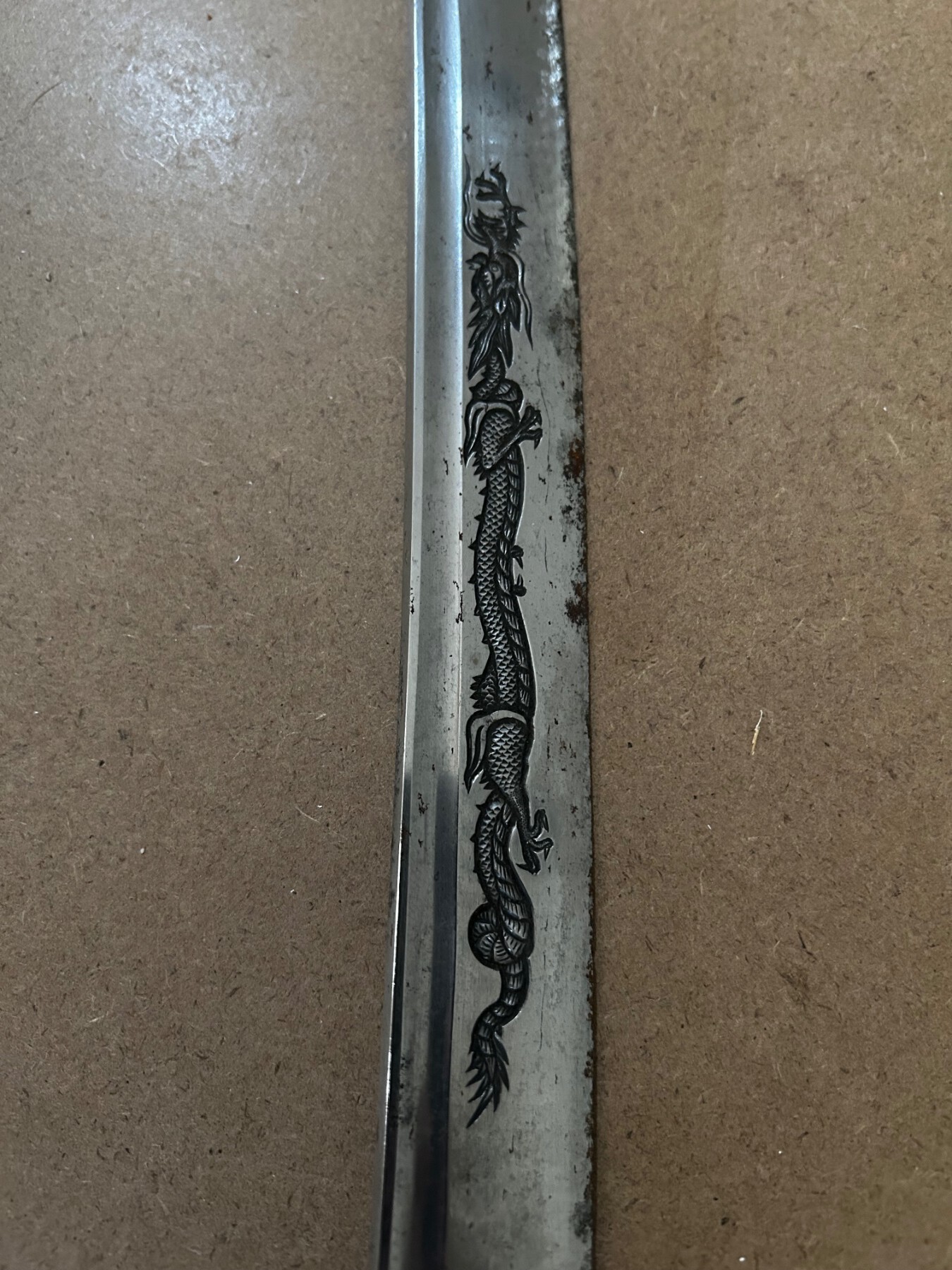

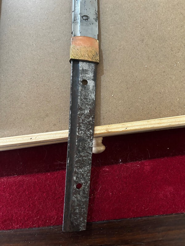

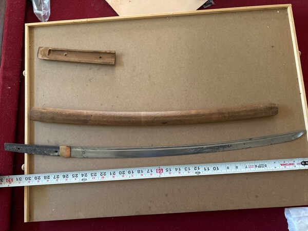

I picked this sword up and was just looking for thoughts on the sword itself (definitely will need to be sent for restoration) and possible age range and Bonji meaning.
Thanks in advance,
Eric

The work itself is not seen - but there is something. Photographing needs to be done without daylight, with a light source on a side. Overall picture?
but horimono are relatively late. Possibly end of shinshinto.
I added a full pic next to tape measure

Shinshinto. The carving is on the hand is sort of garish, on the other the hand is steady and the quality is above average.

Sometimes a sword gives off "has possibilities" vibes and makes you think it's worth putting decent effort into looking further at it. This is one.

Then it is wrong. See Handaka Sennin (aka Handaka Sonja)….
Handaka Sennin (also known as Handaka Sonja) is a rare depiction of a Buddhist Rakan in Japanese folklore, often mistaken for Taoist Sennin, who conjures a dragon from his alms bowl or a censuer. This figure is associated with wisdom and a pursuit of spiritual enlightenment and sometimes depicted on Japanese tsuba, okimono, and netsuke with a dragon.

1 hour ago, Rayhan said:
Hi @Eric187 Would it be possible to know what this area is?
IMG_6163.jpeg.c7780f316ed1666d6de1f6d1aad375d3.thumb.jpeg.5a0f69b9c616477c3924aa064e0e67ac.jpeg
The blemishing makes it look fairly recent, hard to tell
That’s the jewel the dragons reaching for.
  • Love 1
This sacred "ball" seems interesting indeed, the NMB is about to teach me something yet again. So, would any of the experts who have already commented on this sword please enlighten me as to how often we see perfectly drilled or punched (looks drilled) holes that represent the mystic ball, in the Ji of the sword? I have to admit this is my first but then again experts like @Matsunoki or @Bruce Pennington or @ChrisW any examples you can share? I genuinely would like to learn about this Horimono technique and which Kaji usually executed such mastery in a critical area of a sword? Such a round circle no less, masterfully executed. Mino you say? Any examples from databases to be shared? @Eric187 could you let us know how much you paid for this sword?
