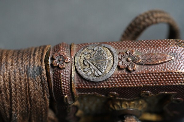

Saw this online and was avoiding it at first. It has a mon on the Koshirae which looks to be made specifically for the sword.

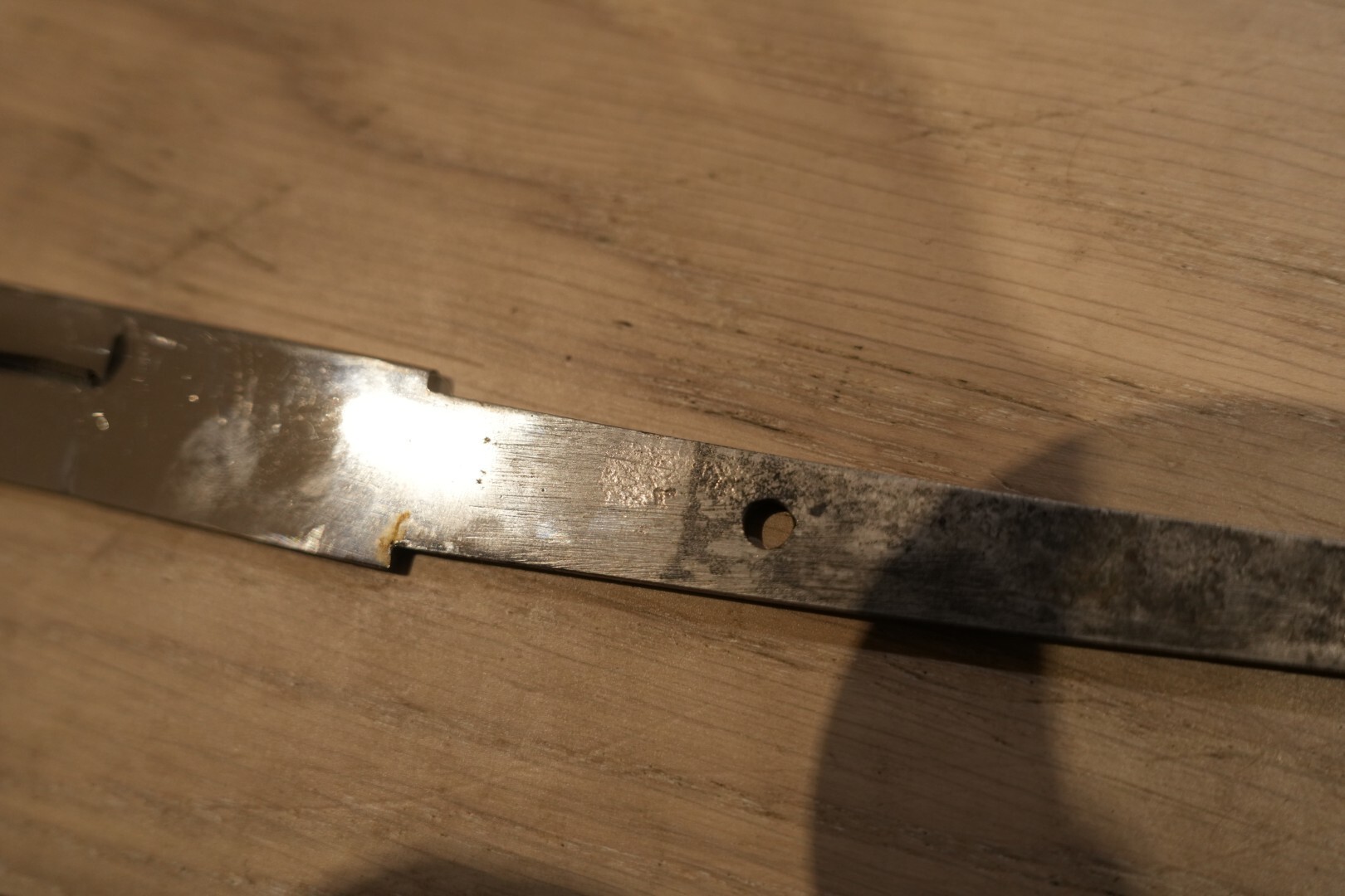

The blade itself is Kogerasu-Maru but one side looks blunt (if you zoom right in)
Was chatting with bruce about it potentially being Murato-to or a western repurposed blade but not seen anything super similar. Also the Nakago is mumei and shape wise unsure, couldn't find a similar nakago on the Murata pictures.

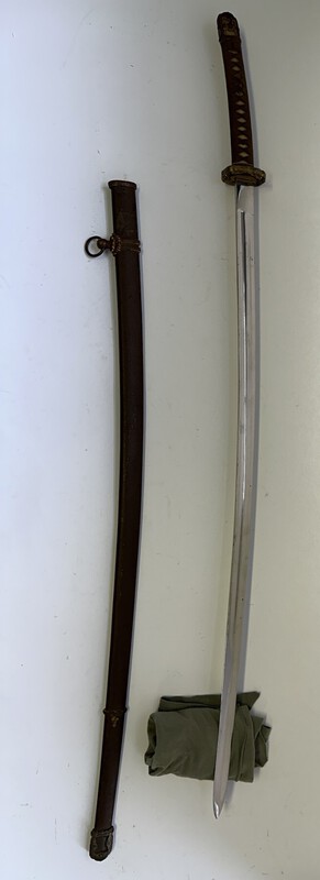

Reminds me of the light weight Type 98.

Took a look at it. It's 100% a lightweight gunto.
All of the fittings as described in dawsons are smaller than normal. It is very light in the hand. Feels more like a police saber in all ways. There is no edge to the blade, not even a false hamon. The fittings are of high quality and the blade is obviously plated.
No habaki and seems like it was never intended to have one. The saya wouldn't fit if it did.
Interesting Tony!  My light-weight gunto has a chrome plated blade as well and has a fuller, though the kissaki is standard shape.

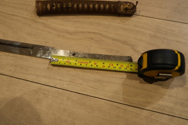

measurements:
Nagasa: 78.5cm
Sori: 2cm
Nakago: 15cm
Tsuba W: 4.7cm   L:5.5cm
Fuchi: W 2cm L 3.2cm
Mon: Hiogi - cypress fan

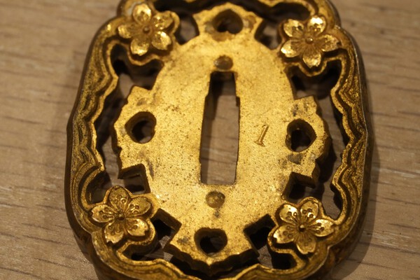

all fittings have a western numeric 1 stamped in

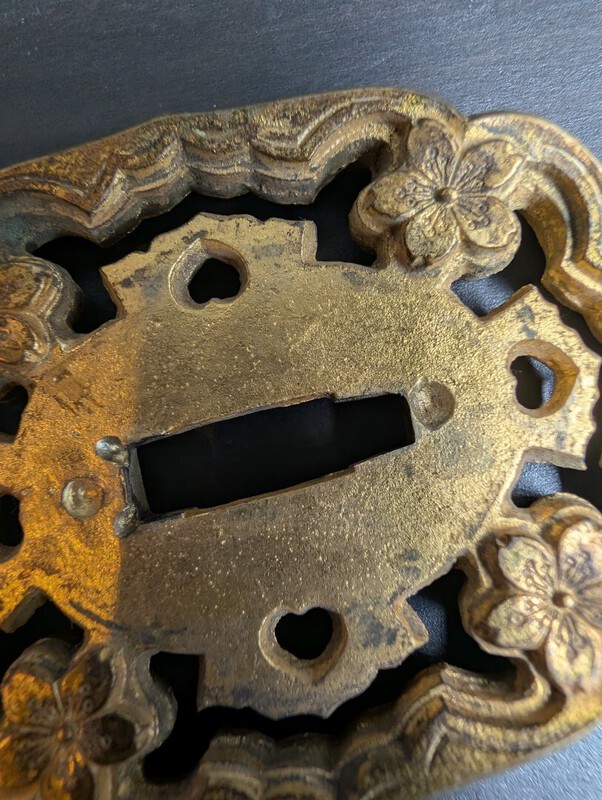

one thing i noticed that i've not seen before is the fittings all have dimples on them with corresponding raised sections so they fit together without moving.
as described in Dawsons, everything is smaller, even the mon
