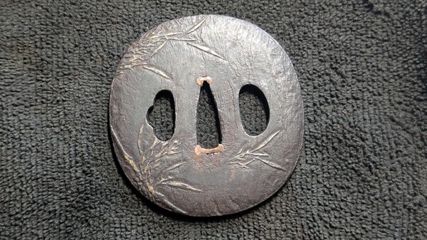

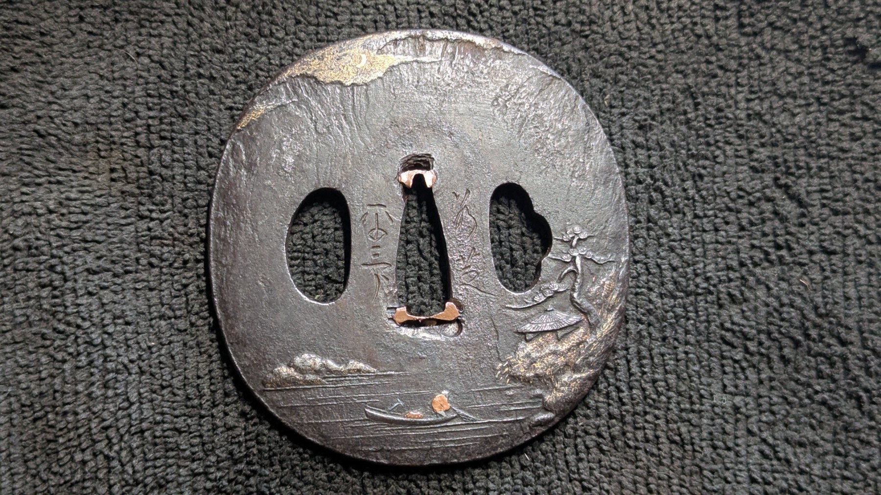

Atomic Logic Posted May 8 Report Posted May 8 Recently picked up this Tsuba attributed to the Jakushi school and trying to identify the mei. The right hand side matches to the typical Jakushi style form of Mei but I am struggling to identify the left hand side. I have done the usual search through my Joly book and through Markus's Meikan but no luck so far. Any help, thoughts, ideas would be greatly appreciated Quote

Nobody Posted Friday at 06:05 AM Report Posted Friday at 06:05 AM Maybe, 若芝 - Jakushi 平三郎 - Heizaburo 2 1 Quote

Atomic Logic Posted Friday at 07:24 AM Author Report Posted Friday at 07:24 AM 1 hour ago, Nobody said: Maybe, 若芝 - Jakushi 平三郎 - Heizaburo Thank you sir! I will look further into Heizaburo. Quote

uwe Posted Friday at 01:19 PM Report Posted Friday at 01:19 PM 7 hours ago, Nobody said: Maybe, 若芝 - Jakushi 平三郎 - Heizaburo Was struggling with 郎, but found similarities in sōsho script… Quote
Nobody Posted Friday at 01:30 PM Report Posted Friday at 01:30 PM FYI: Tsuba with design of birds, waves, crags, mountains and moon – Works – Museum of Fine Arts, Boston 1 2 Quote
Atomic Logic Posted Sunday at 08:18 AM Author Report Posted Sunday at 08:18 AM On 5/9/2025 at 2:30 PM, Nobody said: FYI: Tsuba with design of birds, waves, crags, mountains and moon – Works – Museum of Fine Arts, Boston so 平三郎 - Heizaburo is a very good possibility. Having a look at the above link. That tsuba mei is pretty close to my one. I will need to do a deep dive into the books and see what I can find but at this point. Tsuba attributed to 平三郎 - Heizaburo Quote
