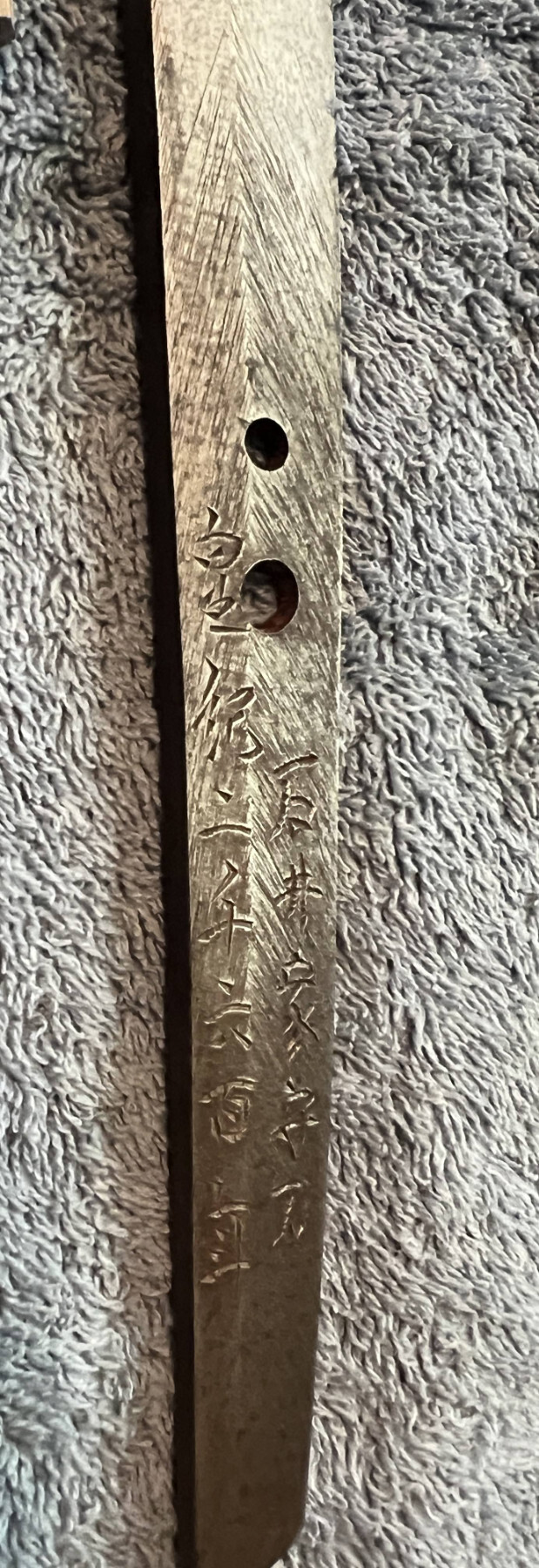

Dogditcher Posted April 6, 2025 Report Posted April 6, 2025 Any info would be welcomed on this sword -measures 25 3/4 and note attached says Kaneuji -Used Yasuki Steel,same smith as Oshi -Thanks 1 1 Quote

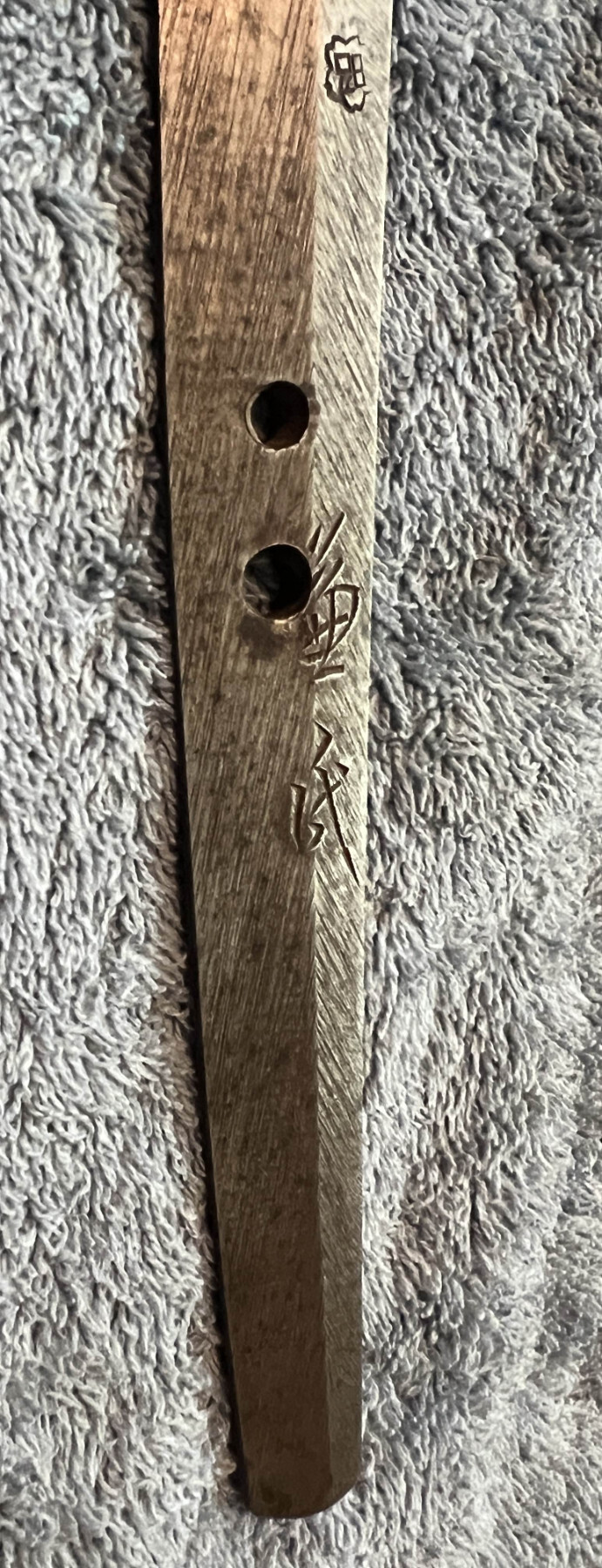

rebcannonshooter Posted April 6, 2025 Report Posted April 6, 2025 Hi Steve, the left side column reads "KO-KI NI SEN ROKU HIAKU NEN" (IMPERIAL RECORD 2600 YEAR ) 2600 years since the founding of the empire or 1940. The writing style matches an oshigata that I've seen for KANEUJI, who was known to use Yasuki steel. I'm having trouble with the right hand column it doesn't seem to make sense to me, maybe one of the better translators will help with that. He was a Seki smith, but this has a Showa Stamp, possibly because of its early date. (maybe Bruce can tell you more) Additionally, the saya is beautiful, and quite rare for Army mounts. Hope this helps, Tom 4 Quote

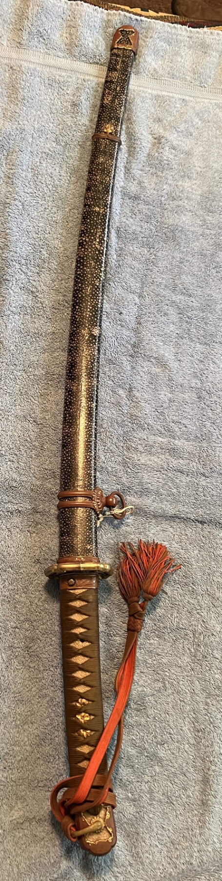

Dogditcher Posted April 7, 2025 Author Report Posted April 7, 2025 Thanks Tom I'm just amazed and appreciative of the knowledge here - Forgot to include this pic - 1 Quote
Bruce Pennington Posted April 7, 2025 Report Posted April 7, 2025 Steve, Don't know how much you already know, so apologies if I'm giving too much. Type 98 Japanese Army officer sword (gunto). You can read up on these on this site: Army Commissioned Officers Shin-Gunto - Ohmura The red/brown tassel was used by Majors - Colonels The saya cover is an upgrade, but we'll need closer, clear shot or 2 to see if it's shark or ray. I have 10 Kaneuji on file with Showa and other stamps The Showa stamp was used by the civilian (not arsenal) Seki Cutlery Manufacturers Association who inspected blades for quality. They are usually non-traditionally made, but with good quality workmanship and hamon. 2 Quote

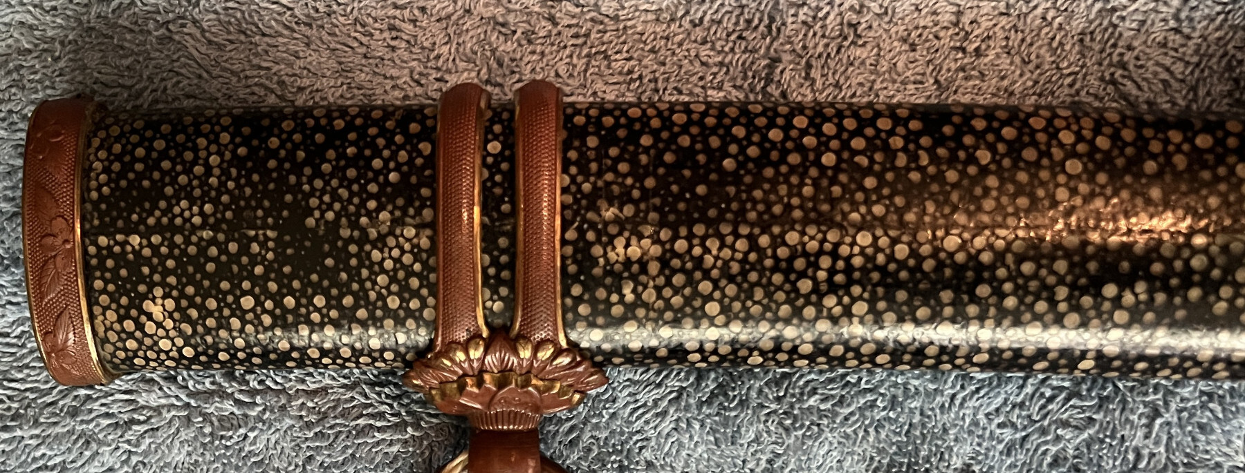

Dogditcher Posted April 7, 2025 Author Report Posted April 7, 2025 Thank you Bruce A closer pic of Saya 2 Quote
rebcannonshooter Posted April 7, 2025 Report Posted April 7, 2025 Wow Steve! That saya is in such great condition, what a prize. I have a very large collection of swords in Army mounts, but so far Zero with ray skin. I'm jealous! congratulations, Tom Quote
mecox Posted April 7, 2025 Report Posted April 7, 2025 Steve, looks a nice package. The smith is “Kaneuji” (兼氏), real name Yoshida Reiichi (吉田 鈴市), born Taisho 14 (1925) January 13 and registered as a Seki smith Showa 13 (1938) September 9 (which is very early and possibly as a deshi? His father was as swordsmith). He is also listed in 1940 as a member of Seki Token Kaji Association (at age 15). In 1942 Banzuke of around 400 smiths he is listed as Ryoko no Retsu (7/7) but would only be age 17. The mei with the date is a bit confusing, it could be read as "Ishii Iemori-to" ("sword of Ishii Iemori") that is the individual, or could be read "Ishii Ke Mamori-to" ("protection sword for the Ishii Family"). Possibly is the latter. 3 1 Quote
rebcannonshooter Posted April 8, 2025 Report Posted April 8, 2025 mecox (Mal), thanks for helping with the translation of the right side of the tang. The date was easy, but I really struggled with this part. Thanks, Tom Quote
SteveM Posted April 8, 2025 Report Posted April 8, 2025 3 hours ago, mecox said: could be read "Ishii Ke Mamori-to Yes, this is correct. I would say the reading is: Ishii-ke mamorigatana 2 Quote
mdiddy Posted April 8, 2025 Report Posted April 8, 2025 The 2nd mekugi-ana suggests the blade was re-mounted which is a bit of a rare thing for showato. Also, the blade is a bit - respectfully speaking - 'pedestrian' for this type of koshirae. Along with what looks like a crisp colonel's tassel, it might be worth kicking the tires to make sure everything checks out, e.g. nakago is not loose in the tsuka, habaki fits evenly in the saya, fuchi and koiguchi match, etc, etc. Also, maybe it's just the angle, but the chisel strokes for the soemei look different from the rest of the mei. Probably it's just the way it was, but worth a little extra due diligence since the koshirae elevate the blade and not the other way around. Just sayin. 1 Quote

Bruce Pennington Posted April 8, 2025 Report Posted April 8, 2025 19 hours ago, Dogditcher said: A closer pic of Saya Yeah, that looks like rayskin. Ray dots are rounded. Shark are small diamonds, at least as I've read and been told. 4 hours ago, Dogditcher said: he has some Manchurian blades that he said where from railroad tracks being ripped up and made. into blades but I think after researching they are blades from steel made from railroad company Steve, These sound like SMR Mantetsu blades! Do you know about Mantetsu? Please post photos. Quote
