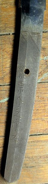

Would appreciate a translation of this oshigata. It's
Kane something, but I can't read the whole thing.
It also has a Seki tang stamp.

It may be Seki junin Fujii Kanefuji saku (関住人藤井兼藤作). But I am unsure about the 1st kanji.
He was also one of Showa WWII smiths in Seki.
Hi morita san,
Thank you for the confirmation. :)
BTW, I could not understand one point. There are two 藤 (fuji) in the mei, but they were differently chiselled. Does anybody know the reason?

Moriyama san,
It's calligraphy rule.
It is necessary to write these two characters by a different style,When the same Kanji character is used in the sentences(1st Fuji, 2nd Fuji).

so if you have same kanji but differnt word it does not apply?
as in Fujiwara Sukeyuki tsuku kore
Well, what you're saying is confirmed, by instance, by the Shintô / Shinshintô Kunishige smiths, singning their blades 備中国水田住國重 and 備中國水田住国重 alternatively depending on the generation, writing "kuni" with either 国 or 國. However, Inoue Shinkai is an example of *not* doing this, writing "kuni" both times the same way (see attachment). Just two examples off of the back of my head.
