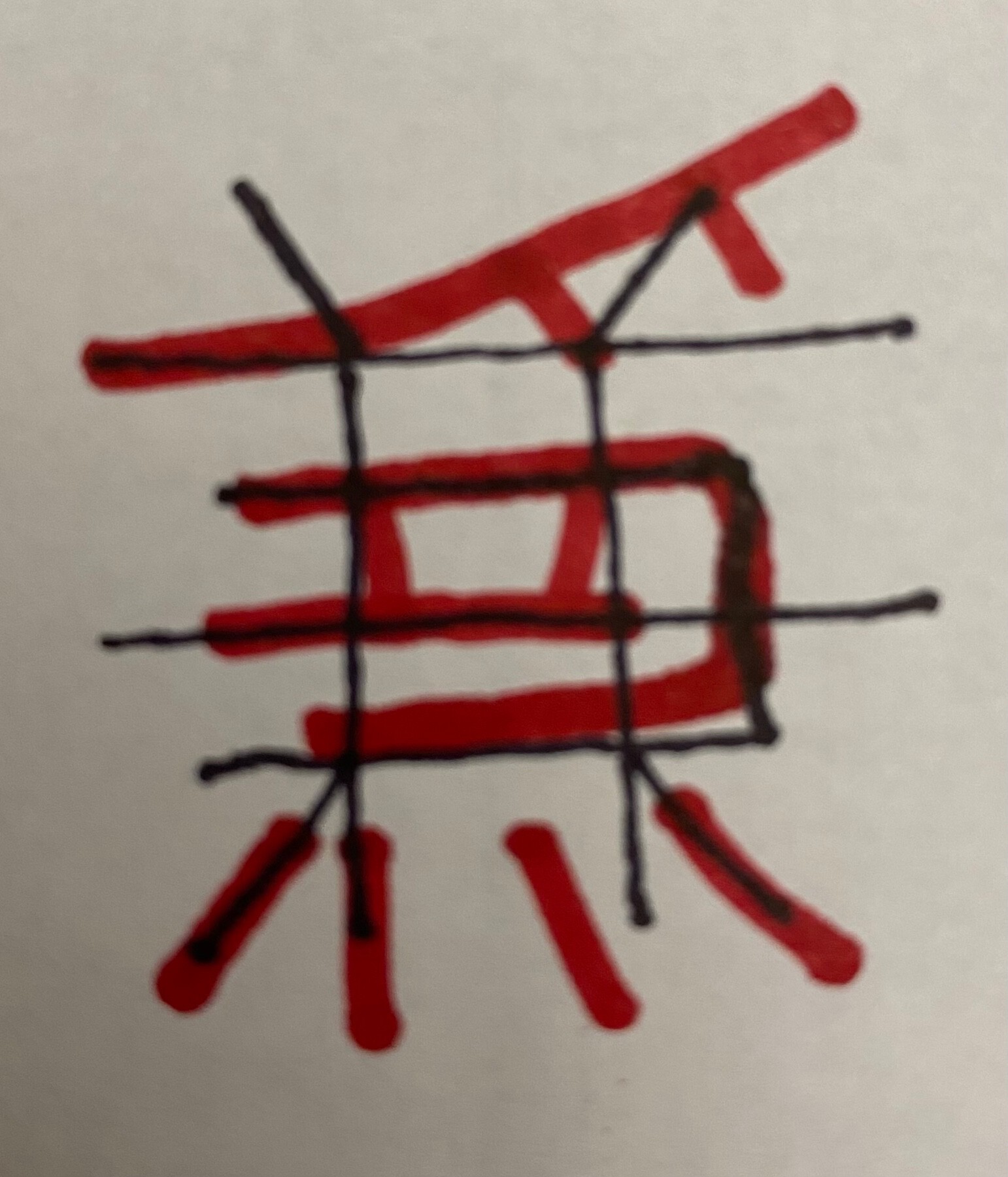

Mark S. Posted November 1, 2023 Report Posted November 1, 2023 I’m sorry if what I’m about to show is too rudimentary, but sometimes it helps to see the difference between the formal kanji with a different form laid over the top. Original kanji in black and kanji you showed in red (very rough ): 2 Quote
grapppa Posted November 1, 2023 Author Report Posted November 1, 2023 Not too rudimentary for me. Somewhat of a stretch for me admittedly... but good for training the eye to the variability in writing. I guess one has to learn by example. Thank you! ...now on to MASA Quote
