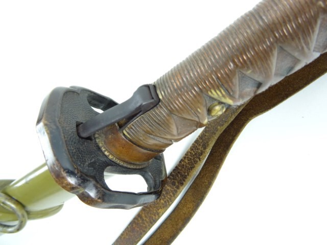

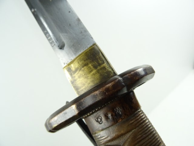

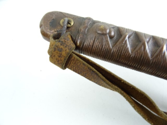

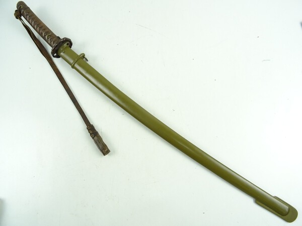

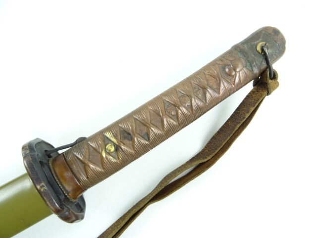

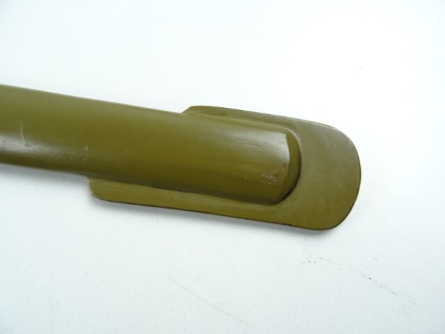

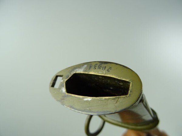

Kawazrana Posted September 14, 2023 Report Posted September 14, 2023 Hello, could you help me out with this one? It's for sale and im wondering if this is an original copper handle sword. Quote
Bruce Pennington Posted September 14, 2023 Report Posted September 14, 2023 It is an early aluminum handled type 95, the handle is painted brown. Looks legitimate otherwise. But if it’s being advertised as a copper handled sword, it is not. you can see they have repainted the saya as well. 1 1 Quote
Kawazrana Posted September 14, 2023 Author Report Posted September 14, 2023 5 minutes ago, Bruce Pennington said: It is an early aluminum handled type 95, the handle is painted brown. Looks legitimate otherwise. But if it’s being advertised as a copper handled sword, it is not. you can see they have repainted the saya as well. Thank you for answer, the color under the paint confused me, but it's probably just a lighting issue. 1 Quote
Kiipu Posted September 14, 2023 Report Posted September 14, 2023 29 minutes ago, Kawazrana said: It's for sale and im wondering if this is an original copper handle sword. Sergius, this is a Chinese reproduction. I think the handle is made of brass. I am not sure if it is painted or dyed though? In addition, the 東 inspection mark on the ferrule is all wrong. @Shamsy 1 Quote
John C Posted September 14, 2023 Report Posted September 14, 2023 Could just be camera angle, however in two pics the top loops on the Tokyo mark look to be different sizes. John C. 1 Quote
Bruce Pennington Posted September 14, 2023 Report Posted September 14, 2023 2 hours ago, Kiipu said: Chinese reproduction. DANG!!! I obviously need to take closer looks at these. This one is GOOD. Up to now, they haven't been even close on the Suya and Ijima stamps, but with this one, I can see they are working on it. I agree, now, the center "TO" stamp is caca (that's Spanish). There are areas in the dimpling in the diamonds that are caca, too. I had originally been bothered by the kabutogane, and color of the tsuba, but in my rush had ignored that. Also, the color of the screw/nut combo looks totally new. They have gotten the curvature of the latch much better, and the numbering + TO on the blade is pretty darn good. And all of that, of course, explains the new looking saya. Quote
robinalexander Posted September 15, 2023 Report Posted September 15, 2023 4 hours ago, Bruce Pennington said: This one is GOOD. Up to now, they haven't been even close on the Suya and Ijima stamps, but with this one, I can see they are working on it. I agree Bruce they are getting good but then I am one of the members that believes NMB threads provide a nice quick 'go to' that furthers the ongoing development of fake coppers and other 95's. On this particular sword... I thought the fuchi stamps were too large and too well pressed. I would always be asking for clearer pics of those. Also, isn't blade number 13982 way outside the range for coppers? The saya would be a deal breaker for me even if it was genuine..... but i like the knot! Quote
Bruce Pennington Posted September 15, 2023 Report Posted September 15, 2023 1 hour ago, robinalexander said: 13982 way outside the range for coppers? Yes, WAY outside the range. That's why I was curious if the seller was advertising as a copper. Quote
The Blacksmith Posted September 18, 2023 Report Posted September 18, 2023 So far as I know, and maybe I am wrong here, but the copper handled katana were held only by the screw holding the sarute. They didn't, I believe, have a screw where the mekugi would normally have been, this came later with the aluminium handled katana. (?) Also the kojiri on the copper handled swords was a simple rounded type, the later western style chape was introduced with the aluminium tsuka. I hope that I am correct here? 1 Quote
Kiipu Posted September 18, 2023 Report Posted September 18, 2023 More or less correct; however, occasionally during a rework a second mekugi was added. 1 Quote
The Blacksmith Posted September 19, 2023 Report Posted September 19, 2023 I did see an aluminium hilted type 95 a while back that had the screw at the mekugi point replaced with a rivet. said to be working life repair. Maybe? Quote
