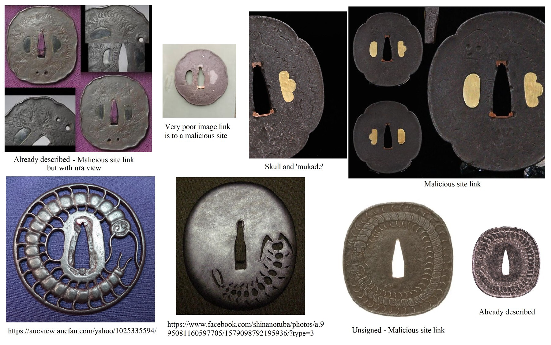

Some new images of "Nobuie Mukade"  - two signed images from links to malicious sites who have taken them from somewhere else and one image of an unsigned copy(?) of the one  Posted Monday at 03:00 PM
Sorry but the images are from small thumbnails and don't get much better when enlarged. Two images lower left are just because I liked the designs :)

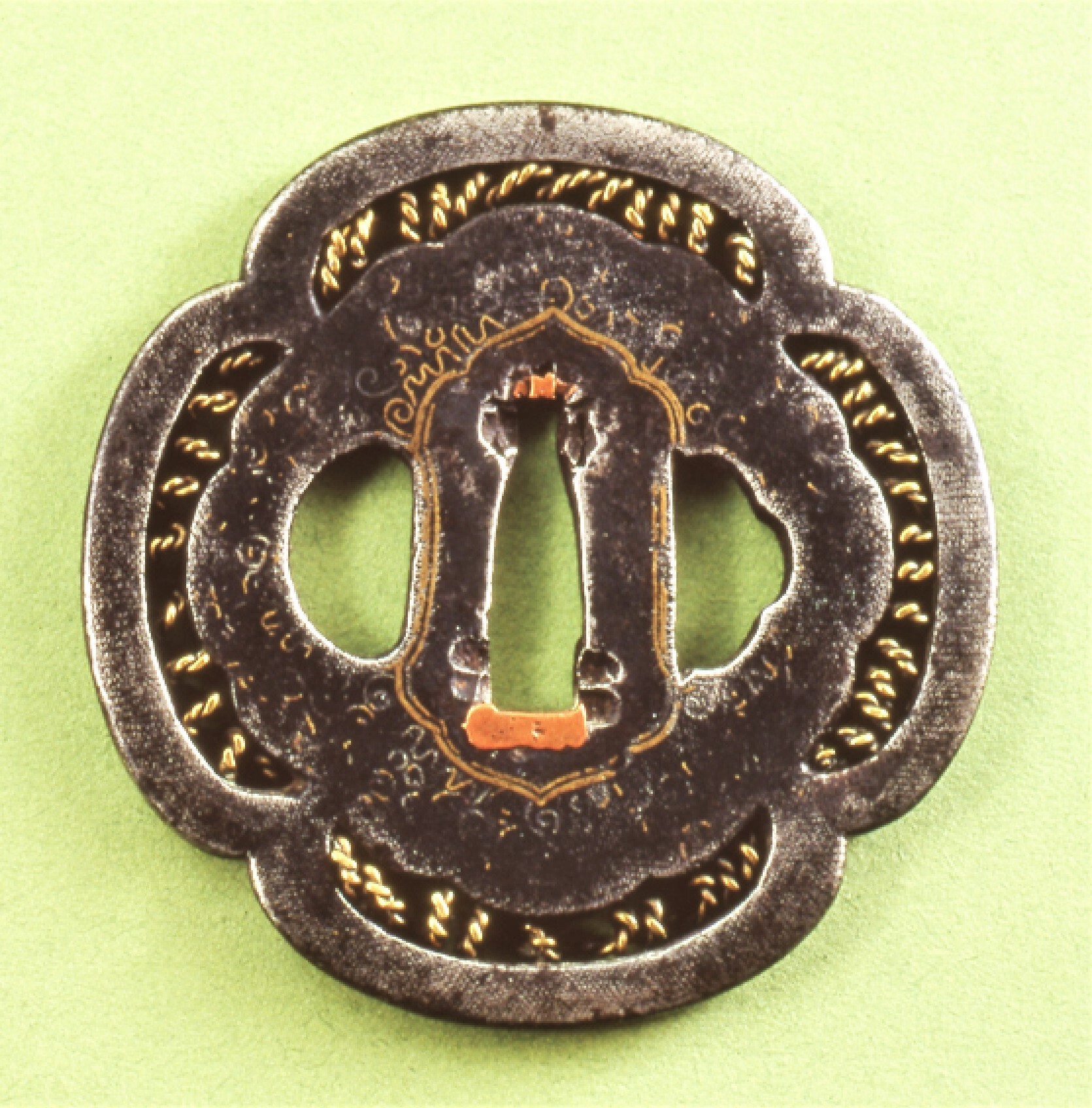

On 8/24/2023 at 1:25 PM, Curran said:
I have a question - where would this guard fit [if it even does?] with being Mukade or Shingen?
It is from the Klefisch Auction House collection of sold items  https://klefischaukt...sxgHNjqlMDWyo7m_CA2k
No information on any of the pieces. I have seen just a few like this, with twisted wires either hammered into the plate or welded. This one almost looks like coils of wire inset into a cut out but hard to be sure as the ura view is unavailable. There is a "nanban" or Hizen look to the seppa-dai?

Hi Dale, your guess is as good as mine. :dunno:
Doesn't look like Shingen or Mukade since, apart from the twisted brass rope, it does not have much in common with either...
From the seppa dai I would have said Hizen, also there is that cross hatching on the hira close to the mimi that looks like the base for nunome zogan.
Don't know.
Regards
Luca

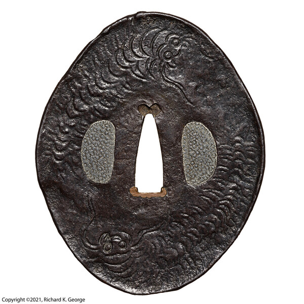

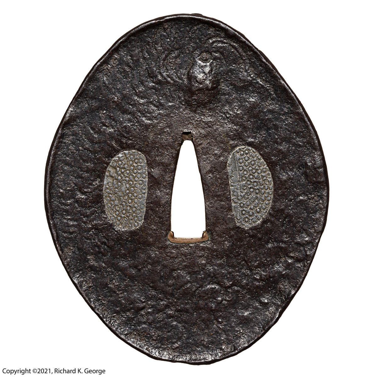

Since the topic of Nobuie/Myouchin mukade themed tsuba has come up....    Here's one of those pieces that I had been trying to acquire for a really long time and finally got to a couple of years ago  - its mumei and came with a stack of papers to Myouchin - I guess a former owner was trying for a Nobuie attribution or something...
mukade_front.thumb.jpg.946f8ccbd927b961b508d9e20f0a3322.jpgmukade_back.thumb.jpg.c320dc5a9242e0326bf1477ff5222040.jpg
The back might actually be my favorite part because its pretty surreal (and yeah, I think there are two mukade there - the one on the bottom is pretty abstract) - the metal work reminds me a lot of a not-like-the-others Nobuie that I think is my favorite tsuba ever, but I digress.  Aw, what the heck... I'll stick in an image of it anyway (the rocks/waves effect in hand is just brilliant) - apologies if this is too far off-topic:

Beautiful tsuba indeed Richard
If we are able to locate other tsuba with naturally depicted mukade that are papered or with solid attribution to Myochin we can start considering the hypothesis put forward by Dale.
Can you elaborate on the "stack of papers to Myouchin" you mentioned about your tsuba? Can you also share the dimensions?

Luca,
No problem on the dimensions.  I put up a description of the piece on Rich Turner's old kodogu no sekai FB page that I seem to have inherited.  The papers are buried at the bottom of one of my safes under a large stack of tsuba boxes and it might take a while to get to them, so I'll have to get you some scans of those later.
https://www.facebook...t=a.3953650578023594
And for those FB haters here's the description from the album:
Mukade (百足) themed Myochin (明珍) tsuba
I photographed this piece back in 2014 and was happy to purchase it when it recently became available.
This otafuku gata (お多福形, oblong spindle shaped) tsuba is made from iron and measures 89.4mm (H) X 72.64mm (W) X 4.06mm (T,nakago ana), 5.33mm (T, max, mimi). It weighs 137.9g The tsuba has an uchikaeshi mimi (打返耳,upset edge) in which prominent tekkotsu (鉄骨, iron bones) are visible. The surface is very dark (which appears to be due to a combination of lacquer and finishing) and is decorated with mukade (百足, millipede (or ishimukade -石百足,stone centipede)). I think its pretty cool how they appear to “rise up” out of the piece (particularly on the back side).
The age is hard to judge because the surface seems very well taken care of (and is waxed), but from the quality of work and large amount of arsenic that seems to have leached from the lead hitsu ana plugs, it appears to be fairly old, and I would date it to the early Edo period (17th Century). The piece has papers from several different groups, all attributing it to the Myouchin (明珍) group of tsuba makers.
