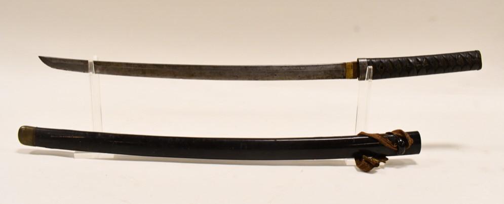

Spartancrest Posted August 19, 2023 Report Posted August 19, 2023 16 hours ago, Larason2 said: There's hardly any swords that didn't have a hand guard from any culture after this, so I suspect that it has been considered an essential aspect of a sword everywhere! The technique used dictates how useful a guard of a sword is - a large number of swords have no guard or a minimal guard Cossack Shashka were in use even up to WW2 and had no guards. Burmese Dha Sword with Heavily Inlaid Blade and Hilt in Wooden Scabbard - circa 1800 https://drouot.com/i...on-of-south-east-asi The Japanese themselves had several weapons with no guard. - A Japanese Shikomizue (Sword Stick); Blade circa 1750-1800, Mounted 19th Century Since 710 CE, the Japanese had used swords in cane-style mounting. They were the so-called joto, particularly the kuretake-saya-joto and the urushi-saya-joto. The former had a Kure bamboo scabbard and an overall length of around 160 centimeters. The urushi-saya-joto, on the other hand, had a thinner blade and a black lacquered scabbard. Vintage Japanese Shikomizue https://www.liveauct...-katana-sword-w-saya [ I am not totally convinced this one has not simply lost it's guard?] https://www.youtube....esktop&v=yFh6_vPx26k https://www.youtube....esktop&v=S40PDOLDARc Quote
