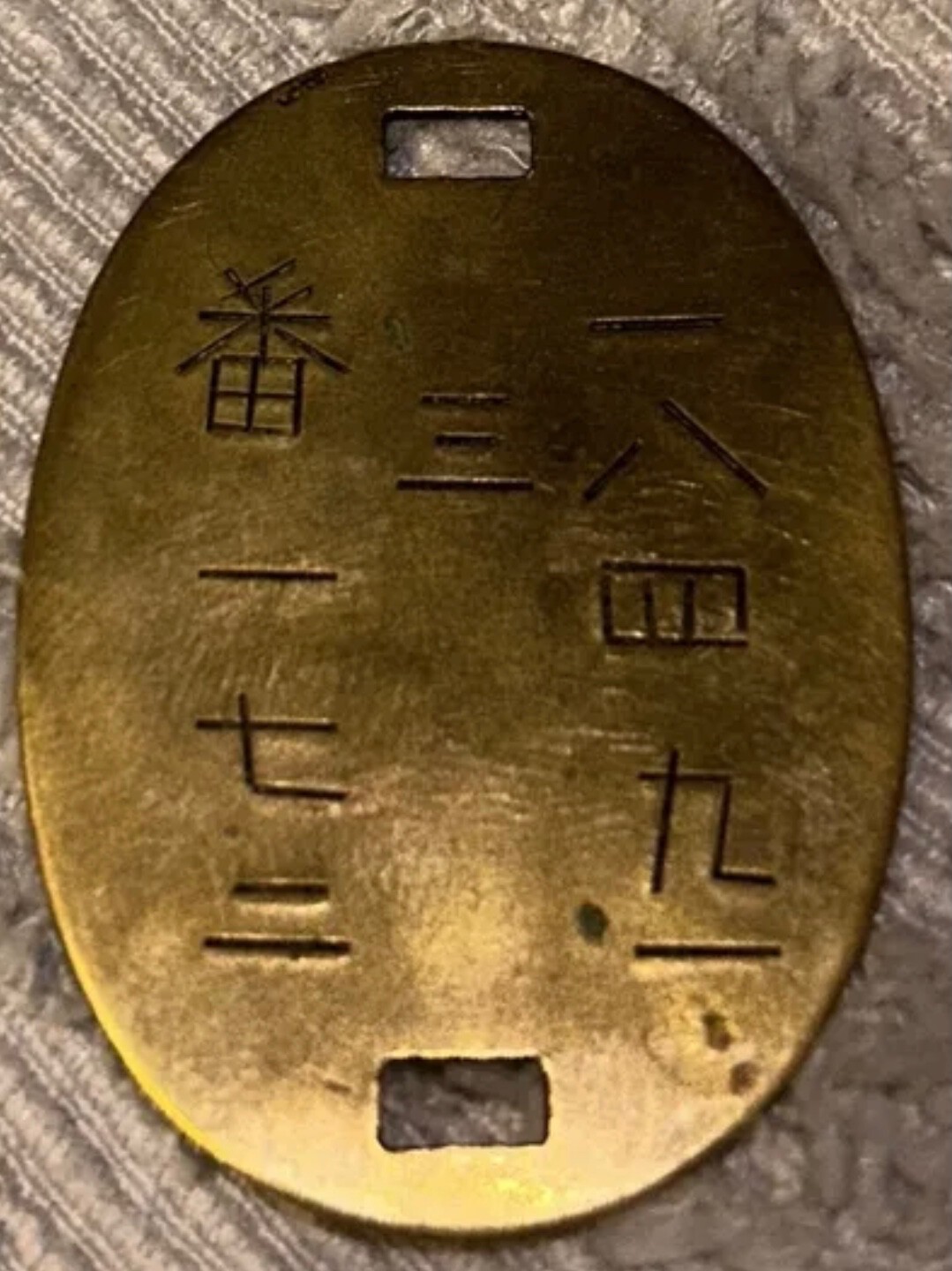

Dog tag is just numbers. Imperial Japanese dog tags aren't like US dog tags. They don't state the name of the soldier. They just have numbers and abbreviations signifying the units. You might ask over on the warrelics forum if they can decipher this. I know Nick Komiya had a key to identifying some of the codes used on the tags. @Kiipu might know what I'm talking about.

Unit 18491 was code for the 147th Airfield Battalion, ending the war in the Philippines, as part of the 41st Army. The unit was involved in aircraft maintenance, supply and airfield security. Whether the tag is original is a hard call as it was not made with proper stamping dies for each character, but improvised. However the scratched on characters are properly balanced suggesting it was done by a Japanese, making it a very plausible improvisation.
Need Help! dogtag

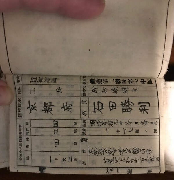

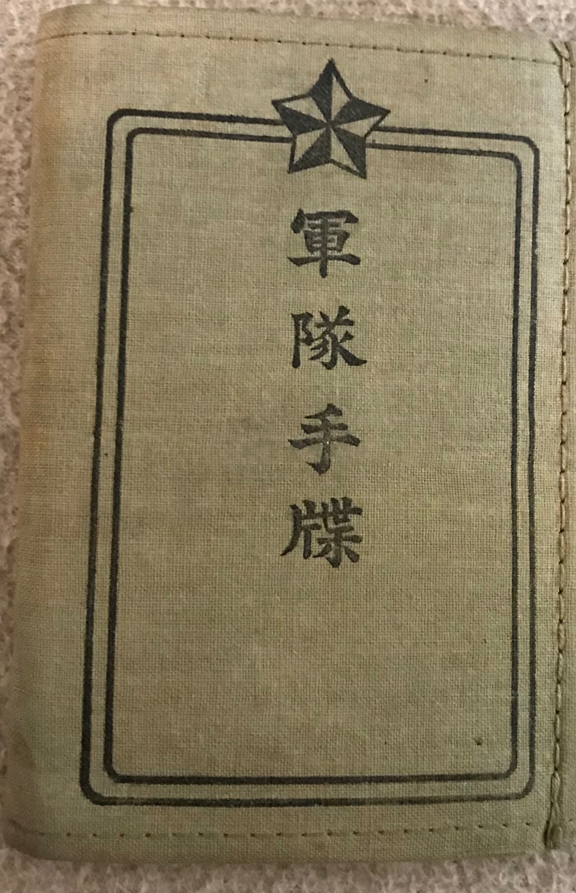

Also the little book is a 軍隊手帳 Guntai Techō or Army Regulations booklet to be carried at all times by every soldier, I would think.
(Off the top of my head. Might need to double-check that.)

Dose any kanji represent the name of the soldier who owned it?
 Thanks Steve
I think SteveM answered that question above (Ishida Katsutoshi), however I have another question. Is there any inscription on the back of the picture or any thing else that may help to identify the owner further?
John C.
I just saw your question No there isn’t any thing written on the back of the photo
when I bought the diary it was tucked in the pocket so it may or may not be connected
It dose fit nicely in the pocket
If there is any writing on the inside, it would be really cool to get it translated (probably would have to pay someone or take it to a local college where they teach Japanese languages). It could have some historically significant passages, or at the very least, give you an idea if his family can be located.
Great find, Steve!!
John C.
Actually I see you these books being sold on EBay I did see one that accurately had the original case There’s a lot of kanji red and black printed in the book
I agree It would be interesting to know what it all means
Not sure if some was done by the soldier I will take a few pictures
Thanks for everyones help
Steve:
I'm using google translate so the info is sketchy. But the first one looks interesting. Seems to be personal information. Ishida Masaru from Kyoto prefecture. Has height information; Born in Meiji era; jurisdiction imperial guard, stuff like that. But again, the app is not always very accurate.
I think the other one is basic military information.
John C.
I think I lost my comments? If it shows up ignore this message
I will send out the diary and see if they can find out any information of this soldier ISHIDA Katsutoshi
And will keep everyone informed !

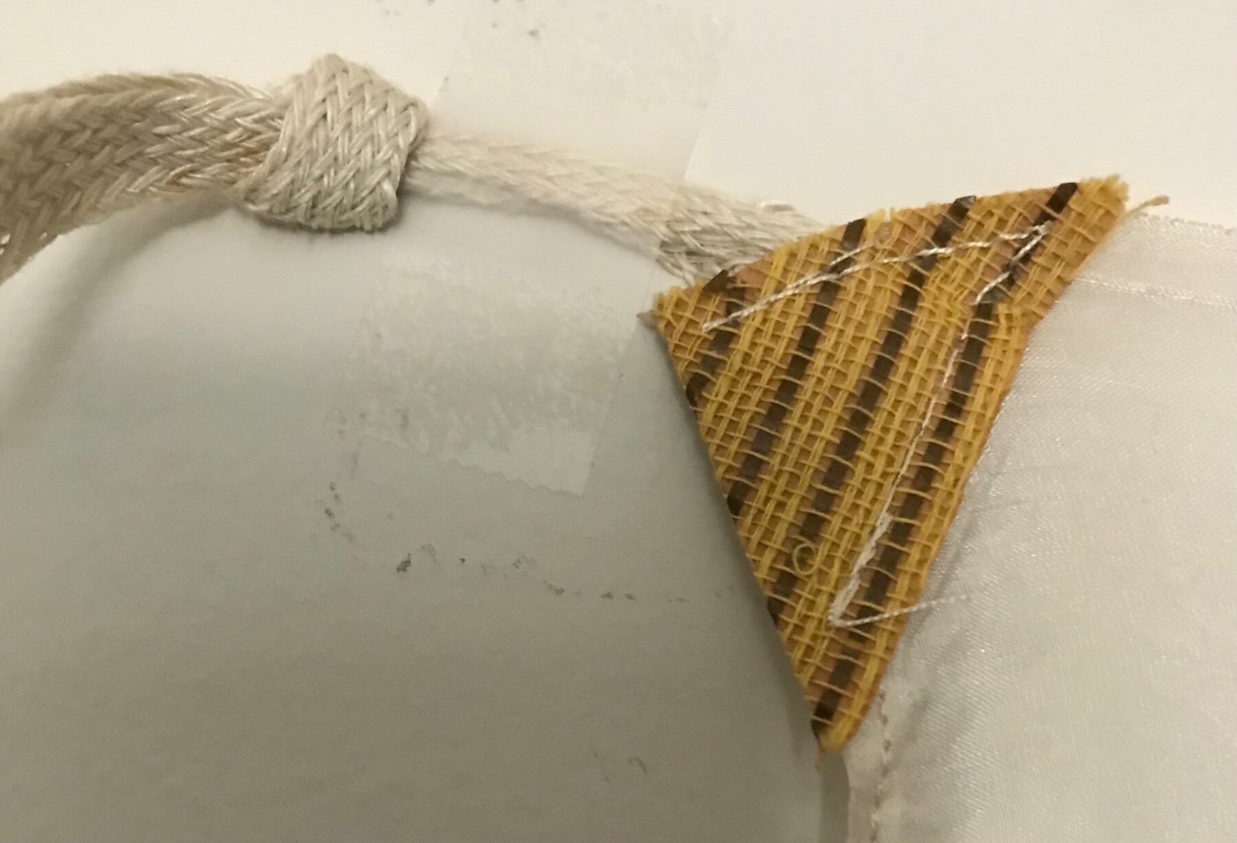

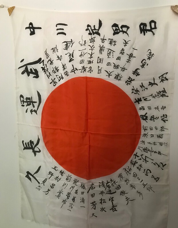

Hi everyone I wanted to have you see my good luck flag in hopes to  authentic it
I bought this year’s ago believing it’s original but have doubts.  Because it looks new Being silk shouldn’t it have yellow texture? Any way I used a black light but have a hard time since it’s not a deep purple glow but not a light tint The paper corners don’t glow at all which I think strange I was told some. Kind of receipt?  Also need help translating kanji that might help authenticate it
Steve

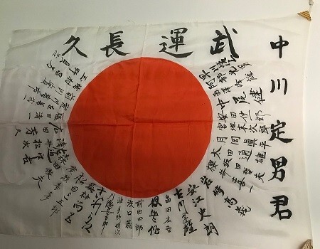

Ideally, the orientation should be horizontal for this flag, like the below. The big letters on top, and the other big letters down the right side.
The 4 big letters at the top say 武運長久 (Everlasting luck in battle). I would say 85% - 90% of these flags have this slogan at the top.
Down the right side is the name of the recipient, NAKAGAWA Sadao.
The rest of the writing are names - presumably colleagues, friends, or schoolmates of Mr. Nakagawa. No idea if it is real or not. It has no location or school or company name or date that would allow us to pinpoint it. The writing across the top and down the side is not particularly well executed. And the name, Nakagawa, is an extremely common name. So, unfortunately, these all increase the possibility that the flag is a fake.
The tag is just a quality inspection tag. There is no date on that. You might be able to date it by the name of the association, but I just did a very quick search and couldn't find anything. Kumamoto Prefecture Fabric Quality Inspection Association (approximate translation).
Steve
I think that the paper has no connection with the flag.
熊本縣繊維品價格査定委員會 – Kumamoto prefecture Textile Pricing Committee
The paper was issued to control the ceiling price of a national frag whose size was 一巾 (34 cm) at its short side.
Your flag looks two times lager than the size written on the paper.
Well I was hoping it’s authentic
As I  said the blue light  is hard to see
Although the paper corners don’t glow which I find odd.  Anyway it looks too new and the kanji looks too uniform
I would think it would yellow with age ?
Unless anyone one else knows something
 I will take it as a worthless piece of silk
and will keep it on the wall
Thanks for your help
