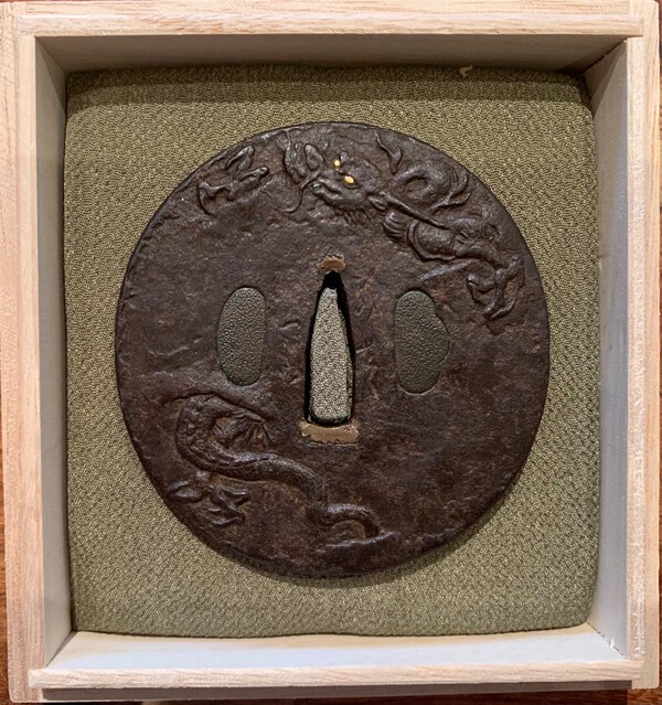

Matsunoki Posted May 20, 2023 Report Posted May 20, 2023 Hello from a miraculously sunny UK, hope around the globe you are all good. Ventured onto eBay again and this one appealed to me. I’d like your opinions please as I’m still very new to the “dark side”. It seemed to exude age and the dragon and especially the windswept bamboo looked aesthetically pleasing imo. I think it’s a bit worn. There are traces of fine gold nunome dot clouds around the rim. Maybe there was once more nunome within the main designs? It was described as signed Jakushi Ichizan ……can anyone date it from that? I’ve had a root around and it does look in the style of other Jakushi tsuba. Is there a link of any sort to this school anywhere? How would you rate the condition? 8cm x 7.6cm All comments always most appreciated. Thanks for looking. All the best. Colin Quote
Brian Posted May 20, 2023 Report Posted May 20, 2023 Tsuba doesn't look cast to me, but then I look at that mei and I think "this isn't sharply cut, waaay too rounded and looks cast into the tsuba" So I dunno. That alone would give me pause. I guess it would be good to confirm the kozuka/kogai ana are filled with a different metal, and not cast with the tsuba. Quote
ROKUJURO Posted May 20, 2023 Report Posted May 20, 2023 Looks like a cast JAKUSHI (not Jukashi) to me. As Brian wrote, the signature of authentic ones look very different. Quote
Matsunoki Posted May 20, 2023 Author Report Posted May 20, 2023 Hi Brian The ana are definitely a different metal……almost certainly shakudo….slight copper colour showing. Jean…. Sorry for getting name letters mixed up! I do that sometimes. Embarrassing. There was once a lot of nunome around the rim…..you can just see the remains in this image. Its been on a sword at some point In hand it looks more heavily worn that cast …….but that is not based on any actual knowledge! Interesting…… Quote

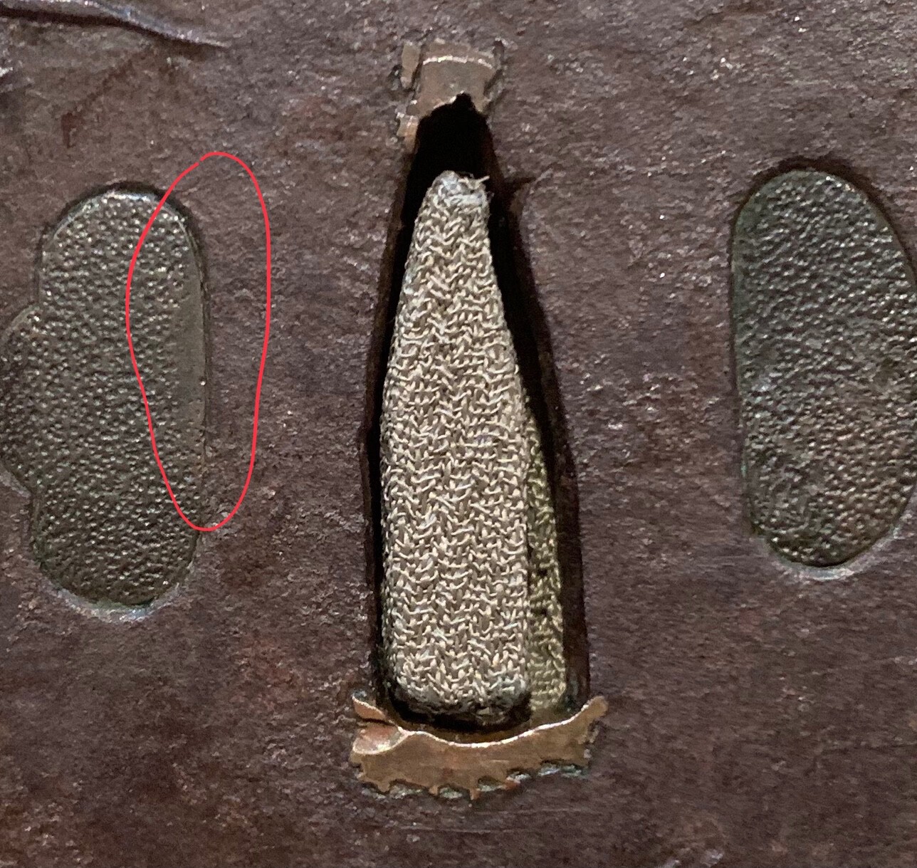

Matsunoki Posted May 20, 2023 Author Report Posted May 20, 2023 Also just noticed the stippled finish on the Kogai ana has been worn away. Not sure if that tells us much? Quote
rematron Posted May 20, 2023 Report Posted May 20, 2023 Ironically, this doesn’t look cast to me. The newbie. And, I'm a little surprised that word is getting tossed in here so quickly by you guys specifically. So being the newbie with a differing opinion than the more experienced means I’m likely to be wrong and learn something, which is a good thing in the end. I know I have a lot less experience but to me the mei is one of the only details that looks like it could have been mold formed instead of carved. However, the mei could have lost what crispness it had with erosion if moisture were trapped on the seppa dai underneath the seppa. The tsuba in general does look like it has some damage from moisture and exposure and age. But the plate looks hammered to me. The bamboo has a lot of crisp detail and so does the dragon for that matter. Should @Ford Hallam get called in like he has in the past? I’m fully prepared to be put in my place. 1 Quote
Matsunoki Posted May 20, 2023 Author Report Posted May 20, 2023 Memories of the wasp tsuba I listed which sparked the “cast debate” suddenly loom large in my mind! Oh no not again🙂🙂 Fwiw I’d bet a lot that this isn’t cast, just very heavily worn. The seppadai has a noticeable halo of wear around it….imo Would any other images help? Quote
ROKUJURO Posted May 20, 2023 Report Posted May 20, 2023 Colin, when I wrote 'looks like cast' I refer to the pictures and the details visible therein. It is never a final judgement. The inlaid eyes and gold NUNOME might be taken as hints that it is not cast, the MEI on the other hand has suffered - possibly from corrosion, but could be interpreted otherwise as well. Quote

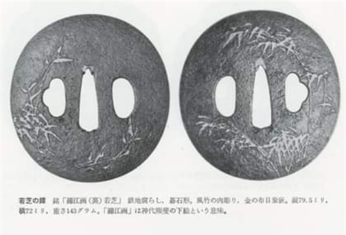

GRC Posted May 20, 2023 Report Posted May 20, 2023 Looks legit to me Colin It's an excellent example of their work. I was tempted to buy it myself, and I kept the images from when it was available: The Jakushi or "Wakashiba" group are known for using acid etching to give some of their designs a more weathered, wispy, "painted with ink" look. That is especially true of the wind blown bamboo (which is a motif taken from a "suiboku Zenga" (Zen ink-painting) of windblown bamboo by Kumashiro Yuhi in the 1700s). The acid etching also frequently ends up revealing some of the folds in the layered steel near the mimi in certain locations. I think I can see those along the lower left and upper right sides on the ura side with the bamboo. Here's one of their etched ones. The squirrel with grape vines is a common motif, but very rare for these smiths. Note the mokume layers revealed at the bottom of the ura side: In my experience the etched ones are usually associated with the "Wakashiba" group of smiths. They often get lumped together with the Jakushi group. Although they have a lot of similarities, I think there's an aesthetic difference between the two... at least that has been my experience with the labels "Jakushi" and "Wakashiba". Unfortunately, I don't know what the actual relationship between the two groups is though... same group or splinter groups working in different locations? Try searching for "Wakishiba bamboo tsuba". It's actually fairly rare to have a dragon on one side and bamboo on the other. They are usually bamboo on both sides. Here's some more: The daisho pair above was also acid etched to enhance that "windblown" look. Congrats Colin, it's a great tsuba. 7 1 1 Quote
Larason2 Posted May 21, 2023 Report Posted May 21, 2023 I agree there's no evidence that it was cast, and lots of evidence of good quality work. Gold inlay, gold nunome rim, kozuka/kogai filled with a metal with different texture and colour, fine carving, especially on the dragon and the bamboo. The mei looks eroded, not poorly chiseled. The surface of the tsuba in general looks weathered in a way that's typical for wrought. The copper inserts in the nakago-ana also look authentic, and their texture and colour is different. The rim looks authentically hammered. 2 1 Quote
Spartancrest Posted May 21, 2023 Report Posted May 21, 2023 10 hours ago, Matsunoki said: just noticed the stippled finish on the Kogai ana has been worn away. I see this as a compression of the seppa onto the ategane or even damage from constant in and out of the sword from the saya. No big deal with a soft metal ategane, it shows up from time to time. Any idea what the metal is? It looks like lead or a silver alloy? 2 1 Quote
Matsunoki Posted May 21, 2023 Author Report Posted May 21, 2023 2 hours ago, Spartancrest said: It looks like lead or a silver alloy? Hi Dale, it’s almost certainly shakudo….there is a definite copper tone showing which the images haven’t picked up. @GRC…Glen, thank you so much for a brilliant reply. Greatly appreciate the time you spent on it…..extremely helpful (and reassuring). Their technique of ageing is certainly effective…it was the first thing that struck me….the appearance of great age coupled with the aesthetic feeling that it creates……all on a piece of hammered iron. Pretty clever. @Larason2 …Carlos, thank you also for your observations @rematron….🙂 Thanks to all. It made me look a bit harder at it! All the best. Colin 3 2 Quote
Brian Posted May 21, 2023 Report Posted May 21, 2023 Acid etching the surface would have worn away the sharp edges of the mei, giving it that soft cast-look we referred to. I wonder if any acid work was done after it was signed by this group? Interesting. Quote

GRC Posted May 21, 2023 Report Posted May 21, 2023 I just got a really helpful message from RKG (Richard George) on the usage of "Jakushi" vs "Wakashiba". Turns out that Wakashiba is just a variant in pronunciation of the same kanji that can also be read as Jakushi. Jakushi is the correct pronunciation. Thanks for that Richard! 1 2 Quote

Matsunoki Posted December 13, 2025 Author Report Posted December 13, 2025 48 minutes ago, Lewis B said: Was this for sale in the UK or USA? What was the price (PM me if you prefer)? Hi Lewis I bought this (ie the original subject of the topic) from a Japanese dealer in April 2023 and with import tax it cost £378. I sold it at the Birmingham Arms fair but can’t remember who to or how much. In hand it was a lovely tsuba in far better condition than some thought. The distressing and apparent wear were all intentional. The iron was excellent. Quote
