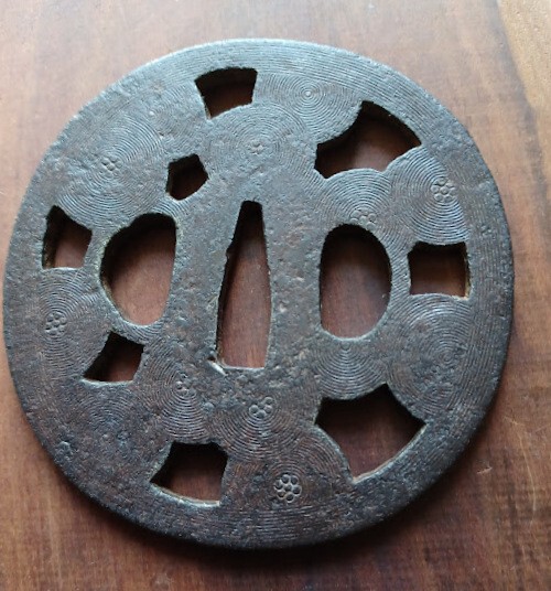

Spartancrest Posted May 9, 2023 Report Posted May 9, 2023 On 5/3/2023 at 10:26 PM, ROKUJURO said: Does someone have an idea they would be kind enough to share? Still no idea what school but the tsuba is not a "one off" There are differences but I would say the same artist did this one. The concentric circle motif is the same right down to the dots in the middle. https://www.jauce.com/auction/w1058682590 or https://buyee.jp/item/yahoo/auction/w1058682590 4 Quote
ROKUJURO Posted May 9, 2023 Author Report Posted May 9, 2023 Dale, thank you very much! How did you find that one? It has more decoration, but the basic work is indeed very close to mine! (Have you ever considered working for a secret service? No one and nothing can hide from you!) 2 1 1 Quote

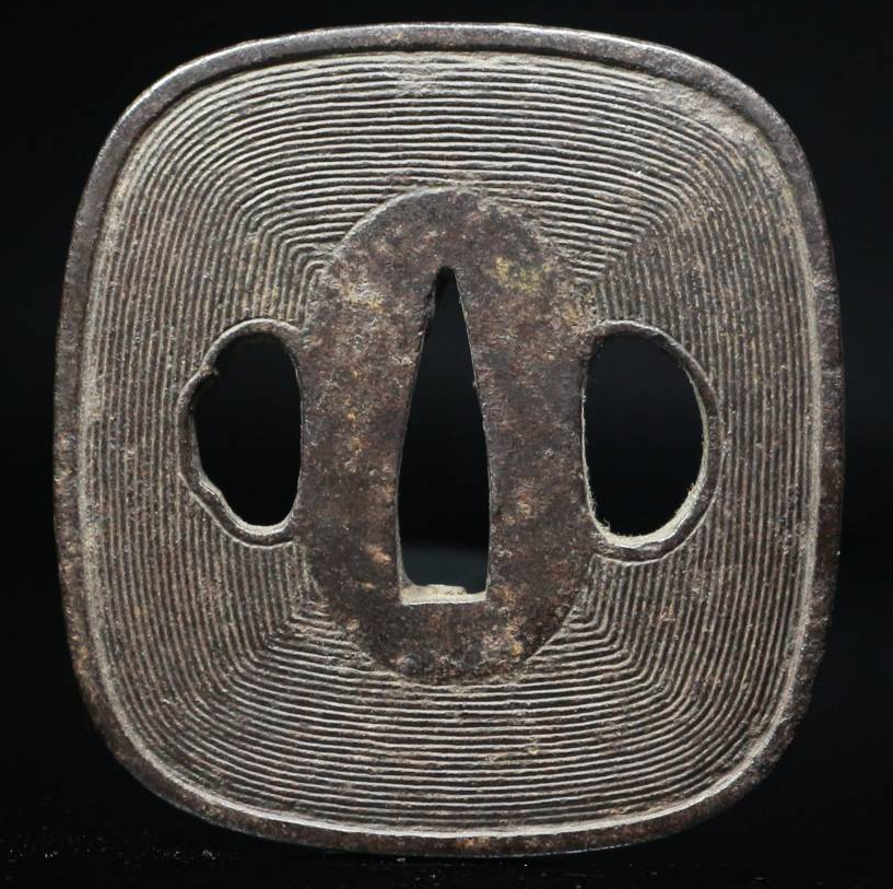

Spartancrest Posted May 11, 2023 Report Posted May 11, 2023 21 hours ago, ROKUJURO said: the concentric rings are super-fine Amazing work when it comes down to it, I think it is far more difficult to do than carving a figure - one slip and the effect is ruined. Truly a technique of great skill. I wonder if the work is related to these "record" tsuba that have the whole surface done in concentric circles. I even ran into a "square" version last week. 5 Quote

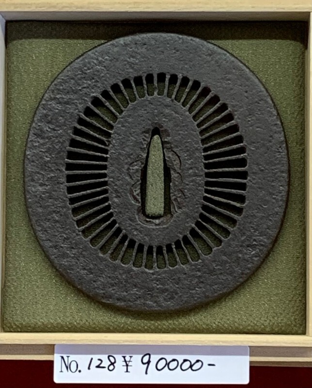

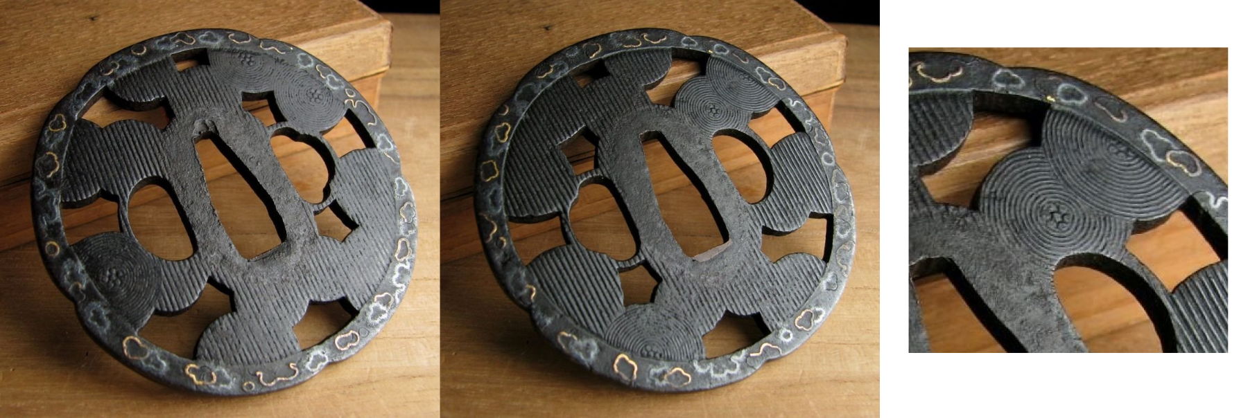

Matsunoki Posted May 11, 2023 Report Posted May 11, 2023 13 minutes ago, Bugyotsuji said: It’s new!” he whispered. Blimey Piers, that’s scary. Just looking at one image, the workmanship looks skilled and old. Was it “proper” brass inlay? Quote
Bugyotsuji Posted May 11, 2023 Report Posted May 11, 2023 It was under glass so I didn't ask them to open it, but yes, scary was the word I was looking for. The shinchu inlay looked properly done. There were a couple of others too. I did wonder if some old tsuba had maybe been redecorated...(?). Quote
Matsunoki Posted May 11, 2023 Report Posted May 11, 2023 Simply from its appearance and having had another close look I really struggle to believe that this is new. However the design is not something I’ve seen the like of before (not that that means a lot!) Quote
Bugyotsuji Posted May 11, 2023 Report Posted May 11, 2023 In fer a penny, in fer a pound. “These two also”, he said!?!?!? Aaaarrrrgggghhhh… and I felt like a schoolchild. What? Where? How? Quote
Bugyotsuji Posted May 11, 2023 Report Posted May 11, 2023 The other possibility, which I had not considered until now as he is a sort of friend, is that he also had stuff to sell, and maybe he wanted to put me off using my cash on any of these above. (?) 1 Quote

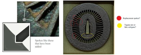

Matsunoki Posted May 11, 2023 Report Posted May 11, 2023 Well Piers, more confusion. Looking at the first of these two pieces, the radiating sukashi is very uneven but that unevenness does actually follow a rhythmic undulating pattern and could be perfectly deliberate…..or just bad workmanship. Again it doesn’t look new and has taken some time and effort and skill to make. The second one employs a very similar inlay design technique to the original piece but the iron looks old and genuine. So, maybe later inlay into earlier plain tsuba as you say? …….or maybe your suspicions re your “sort of friend” are correct🙂? A jealous rival dealer once pulled that trick on a customer of mine who was considering a purchase from me at a large Antique show. A very nice pristine Satsuma vase by Sozan for Kinkozan. In front of me he said to my client….”I think that vase has been cracked”……..it was mint perfect and he knew it. The client still bought it but the tricks people play hey?……… The dealer wisely avoided me forever after that. We need some help here I think. All the best. Colin 1 Quote

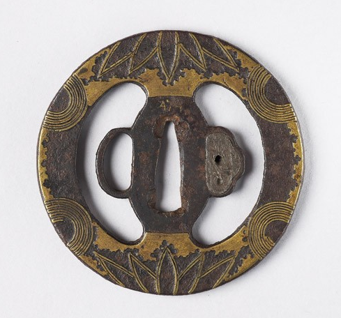

Spartancrest Posted May 11, 2023 Report Posted May 11, 2023 2 hours ago, Bugyotsuji said: reminds me of one I saw recently Hitsu are different shape but the design is the same as the one you were looking at. "Snow on bamboo" If any of the tsuba are "new" the only one I would look at is the Saotome, the tagane-ato at the base of the nakago reminds me of the fake sekigane you sometimes see on cast guards - but it could be just tagane marks Tsuba with bamboo leaves and semicircles (EAX.10121) http://jameelcentre.ashmolean.org/collection/7/10237/10343 Round tsuba with half-wheels and bamboo leaves (EAX.10122) http://jameelcentre.ashmolean.org/collection/7/10237/10343 2 Quote
Matsunoki Posted May 11, 2023 Report Posted May 11, 2023 Dale to the rescue again!…..why am I not surprised🙂 Snow on Bamboo - Yep I can see that now…..maybe in a Zen garden (raked stone circles?) Brilliant spot re probable replaced spokes…..my money is on it being genuine/old. 👍👍 1 Quote
Spartancrest Posted May 17, 2023 Report Posted May 17, 2023 On 5/11/2023 at 9:26 PM, ROKUJURO said: may indeed be related work! On 5/11/2023 at 7:20 PM, Spartancrest said: I even ran into a "square" version last week. Well it took me some time but I finally ran the 'square' one to ground - not a perfect square of course - The technique doesn't really work in my opinion on that shape. https://www.jauce.com/auction/x1084932019 or https://buyee.jp/item/yahoo/auction/x1084932019 Quote

Spartancrest Posted May 18, 2023 Report Posted May 18, 2023 7 hours ago, rematron said: I'd love to find one like it. This one is still doing the rounds! https://www.jauce.com/auction/w1058682590 https://buyee.jp/item/yahoo/auction/w1058682590 1 Quote
