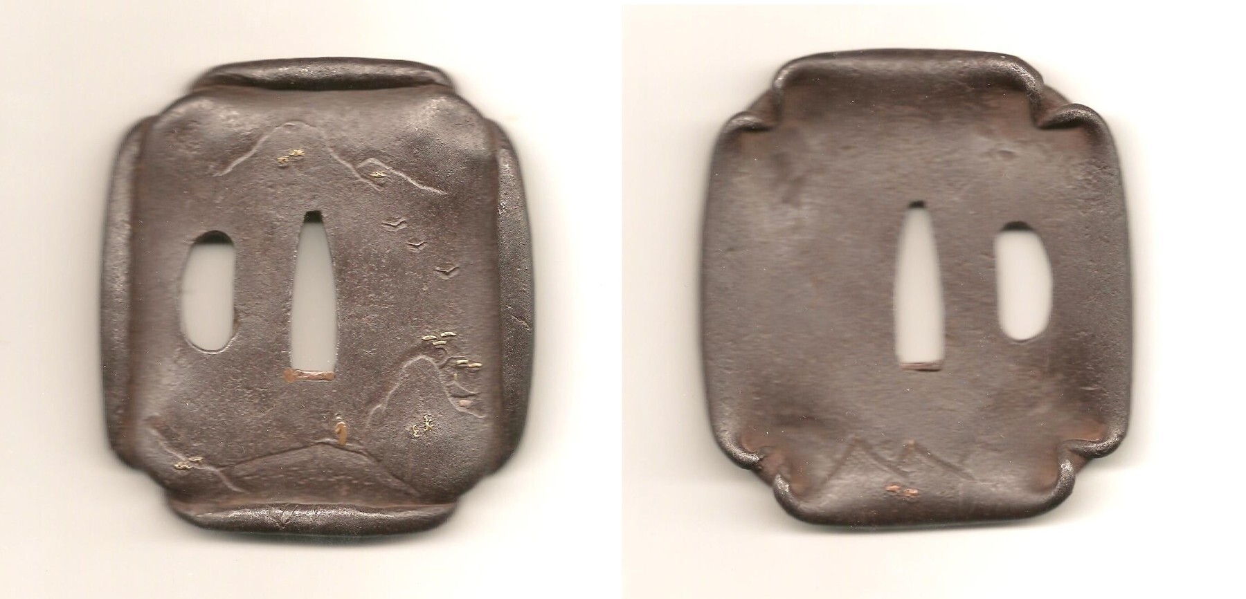

Hi Roger it looks like an attempt at a type called Uchimimikaeshi or Uchikaeshimimi depending on the reference. Unlike your example they are usually made from a thin round or oval plate with the edges turned in one direction while red hot and the 'corners' turned in the opposite.
The plate looks thick on yours and it looks like it was a cross shape to start with. Perhaps it was a continental attempt to copy the Japanese style?

Roger, I think yours is a variation on the wan-gata form that was more common in continental Asia, but also produced in lower numbers by a variety of schools in Japan.
But at the same time, like Dale suggested, it could looks like a variant of the Japanese Uchikaeshimimi form which not typically dished like a wan-gata... so yours looks like a blend of aesthetics.
I have seen several examples of wan-gata shaped "Hizen", nunome decorated tsuba, where the dished inward side is much rougher than the outer surface.

Although that's not always the case...
Here's one (Possibly of Korean origin) that is finished smooth on both surfaces:
image.png.27783243b8fc3c446fd404cac3b217ac.pngimage.png.f0e1f8fb53f2ae0368676b4b461c52be.png
Given that both rough and smooth inner surfaces exist on the dished wan-gata forms, you would have to conclude that it was a deliberate choice by the smith to leave one side rough.
And Roger, yours has deliberate horizontal chisel marks that were done in clusters.
I think they are meant to suggest some form of "mist" or "air" to go along with the dragon on the front.
