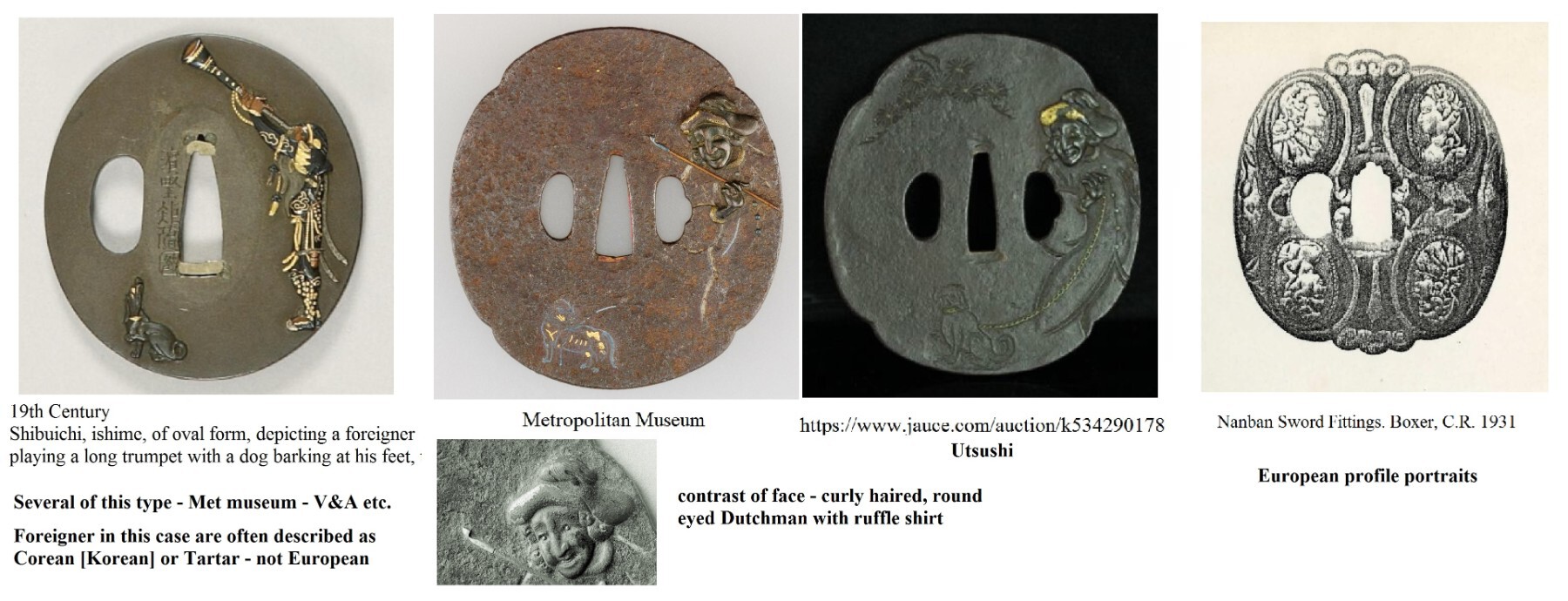

No one else has offered me guidance about gaijin faces on Namban tsuba, so let me ask you to look at these two guards and four (!) bearded fellows.
Namban ? - sure looks like that , notice one has a squared ana
Gaijin? well, yes, round eyes and beards
A type? I'd have to say "yes". similar design/construction.
Reactions???
Peter

Thank you, thank you!
Dale, you are a font. Indeed, we have seen that re-worked Juyo guard that featured a full-figured naked girl. Talk about outlandish stuff!
And thank you for showing me that big-nosed profile hidden on the bilobed guards. GOOD EYE!

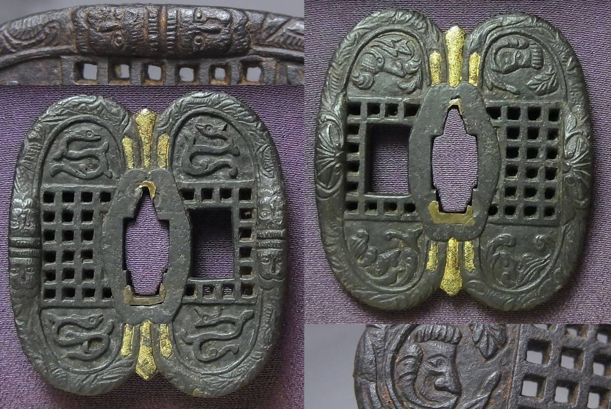

This is a guard that presents another couple of gaijin images. It has a old NBTHK Green Paper and has been posted on the NBTHK-AB page.

This topic has gotten rather bulky, but please allow me to add another gaijin face. This one is a pair on the margins of really nicely carved dish - red hair, button nose, and round eyes.
Peter
(While you are inspecting it, look at all those "VOC's" in the tendrils).
