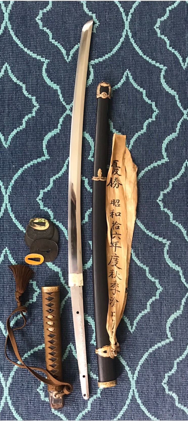

Hi you all wanted opinions for this sword I have the blade is mint scabbard a little split on top but sound I normally see 2 hangers where mine has one don’t know if this hurts the value and what is the value for this sword

The uniform regs were changed in the last year of the war to allow for 1 haikan (hangar) and lesser quality fittings, so this koshirae is likely made in the last year.  It's a nice looking rig for a late-war kaigunto, actually!  Puzzled by the 3 holes in the nakago, but that doesn't detract from it's value.
Someone else will have to help you with the saya crack question.

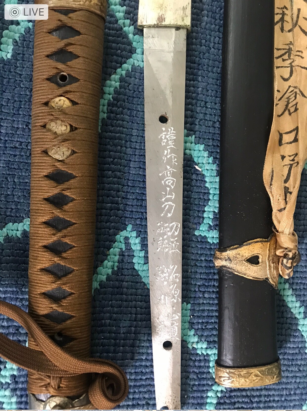

Is it possible that the Sarute Hatome passes through the nakago? It looks long enough…
The cloth tag has a date of 昭和拾六年 written on it which in the Gregorian calendar is 1941.  Is this sword dated by chance?  I would suggest getting this cloth tag translated in full.
拾 = 十
Charles, I think you're right.  The nakago is longer than usual, so the hole at the very end must be for the sarute.  Still don't understand the hole just below it, though, unless the blade was originally made for RS fittings, then sold to a Navy buyer.

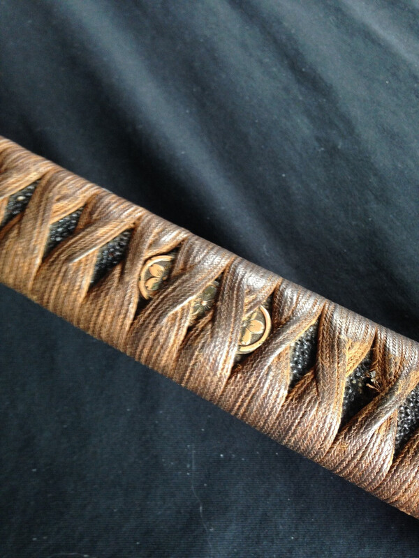

I was told it was post war put together and the wrapping is backwards
I got sick when I heard this Can anyone help with is authenticity

Hi Bruce I was told that the wrapping on my
handle is wrong? I did not expect that since I have had it for a while and no body ever mentioned this
steve
Steve, based on pics 27 Dec kaigunto, nothing appears "wrong" with the tsuka and ito wrapping.  Disregard criticism.

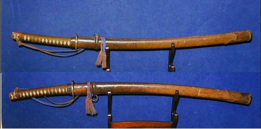

I think whomever told you the wrap was wrong, likely was thinking of the flat-wrap style normally seen on kaigunto.  There are names for the various styles, which I don't know, but the majority of navy wrap is the flat style like this:
Yours is folded, but I've seen plenty of kaigunto with the folded style as well.  There was plenty of variation in every official gunto type.

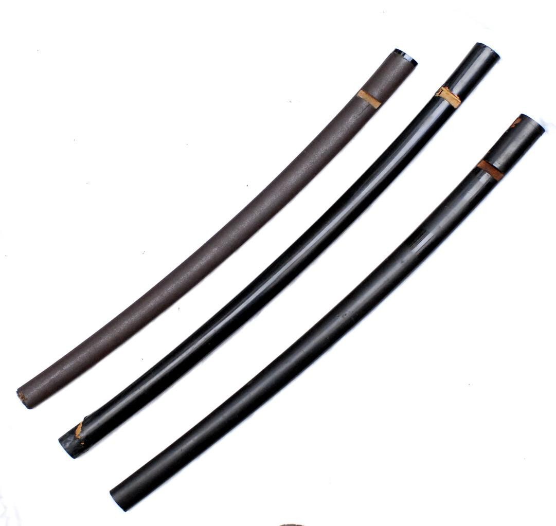

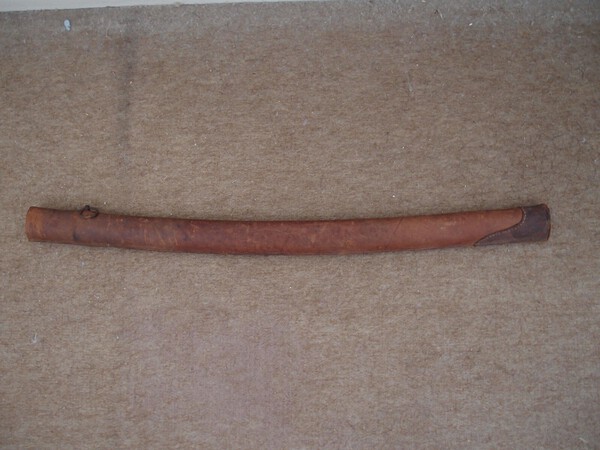

Having a bit more time I will go into more detail. Of the eleven saya I have bought off the market only the one wood and leather and two steel Gunto saya, were  ready fits for spare blades I had. The wood and leather was a complete koshirae and all of it fitted the blade I had, saya and tsuka, which we all agreed in the local To-Ken club was a one in a million chance, never to be repeated.
 I bought a stack of three from Japan, one of them fitted a blade I had, and the other two fitted nothing, and still not with anything six years later. Non of the others  fitted blades that I had already. So eleven saya, four fitted something.
 What I have done on three occasions is to split and re cut a random near fit saya to fit a blade, and I have repaired two damaged saya to hold their original blades safely.
 Repair is easier and more sure of a decent fit. (Apologies if the numbers are a bit confusing, I kind-a-got-lost-there-myself!)
