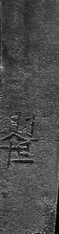

The mei on the blade i have is going gimei on me..

Hello Alton, I do remember the discussion about Narishige. I had forgotten that highlighted page and that we probably discussed this sword a bit too.
I wouldn't think gimei on this sword, just rather think it as (at least so far) unknown signature. I think the signature is legitimate on this sword. I think Michael has a point and it could certainly be pre-Ōei too, I see something from late Kamakura to early Muromachi as possibilities for this one.
I believe the Bitchū Senoo Noritsune that Steve posted earlier is from Jūyō 53, unfortunately I don't have that book yet. That is the only (則常) Noritsune that has made Jūyō. The Noritsune (則恒) mei that Michael posted I believe it was judged as Ichimonji at Jūyō 18 but later revised towards Bitchū Senoo at Tokubetsu Jūyō 25.
I think in general when Aoe smiths used 2 character mei, it was very rarely put so neatly near mune as on your sword. Later longer signatures were often on smaller characters and near mune.
Have you tried taking an angled picture with a pointed light source, if it would be possible to see the actual hamon? This is an exciting sword. Do you have a picture of it with habaki on? Is this in shirasaya or in koshirae?
No oshigata of this smith (very likely not that skilled) in the literature and no examples of his work. All one can do is speculate and I refuse to do that.
Should strongly consider sending this for shinsa
The mei kinda also looks like it could be 國常 kunitsune but the only smiths are Shinto Mino and this blade doesn't fit that
Can we have closer shots of the jihada and hamon
Shape is early, however, keep in mind that there was a period of time during the muromachi period that produced worthy copies of earlier swords, sometimes complete with a mei. A blueish tinge to the metal is one give away.
