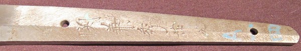

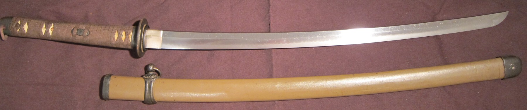

george trotter Posted April 1, 2021 Report Posted April 1, 2021 I have a question for members who have an example of the showato blade 'Type Rinji' mounted sword. These have steel scabbard painted light brown no dust cover seppa over scabbard mouth only one chuso button (not two) usually have Seki, Nagoya (na) or Gifu (gi) stamp on tang My question is about the year they started in production...has any member got one dated before 1943 (sho 18)? ...if so I'd like date details and stamp (I have a real nice toffee apple for whoever has the earliest date). (maybe Bruce already has the answer?) This pic is of my Seki 'Type Rinji, but it is RJT by gendaito smith Kanehide so is not Showato type. 2 Quote

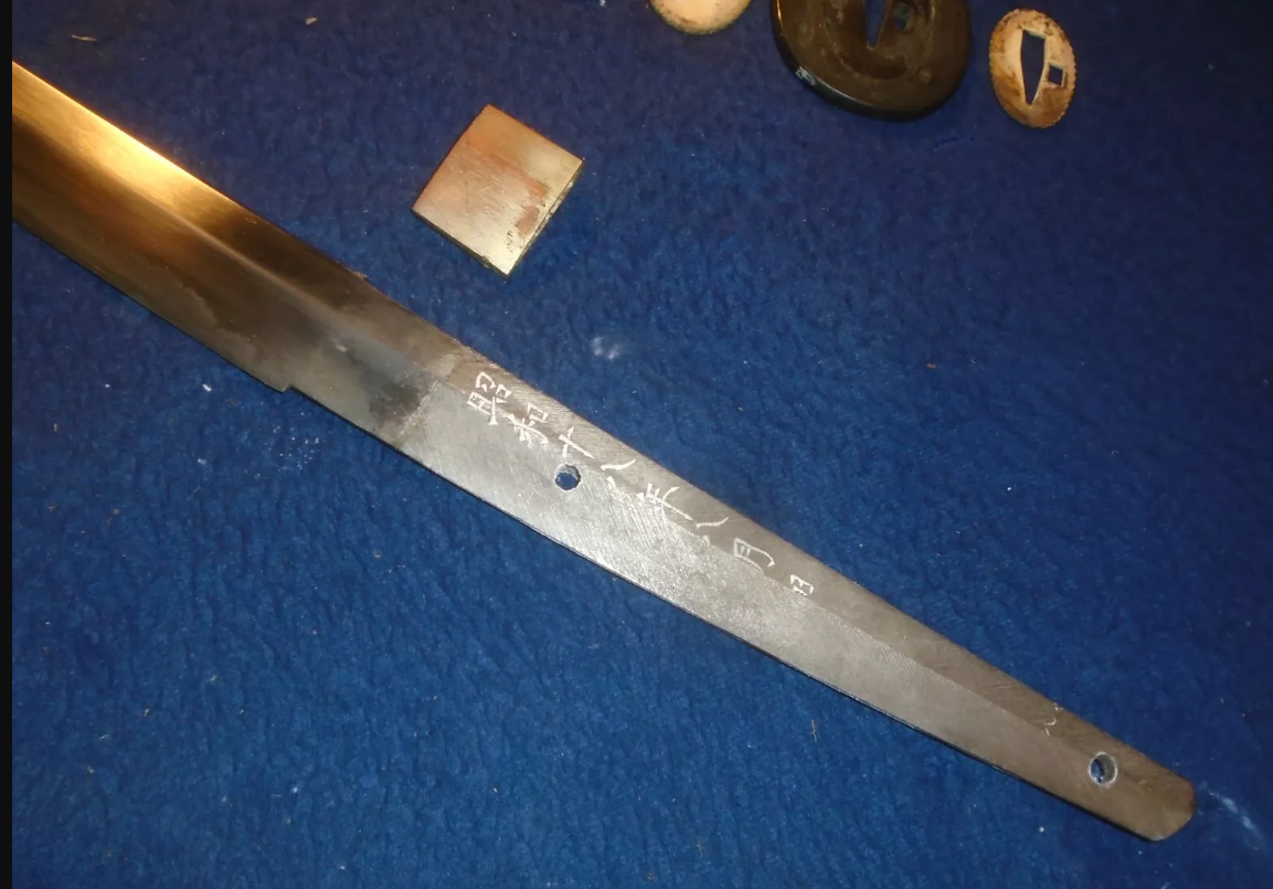

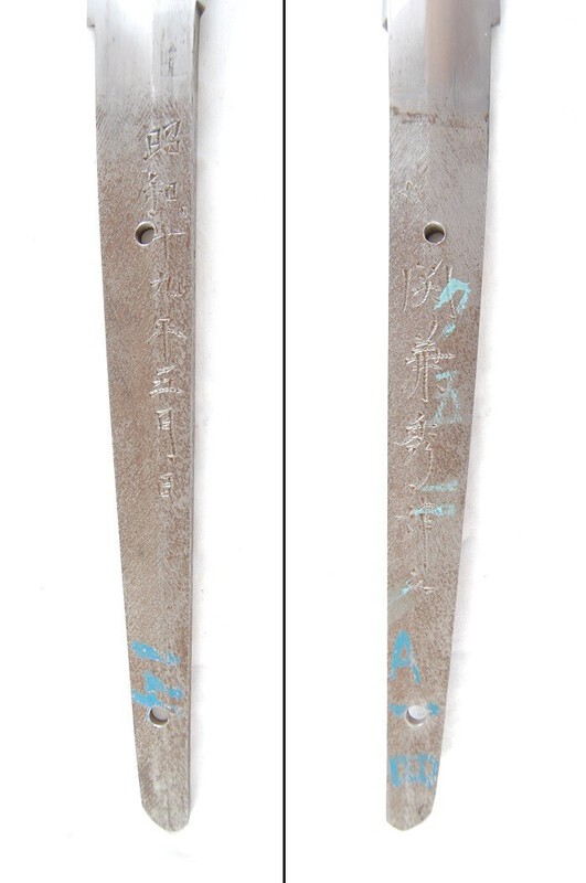

John C Posted Saturday at 06:08 PM Report Posted Saturday at 06:08 PM On 3/31/2021 at 8:34 PM, george trotter said: RJT by gendaito smith Kanehide George: Would you mind posting a picture (or directing me to the thread if already done) of the mei and date of your Kanehide for a project I am doing? Thank you, John C. Quote

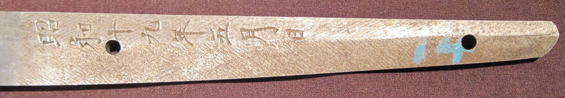

george trotter Posted Sunday at 05:11 AM Author Report Posted Sunday at 05:11 AM Hi John, Here are the mei and date of my Kanehide. Also, here down below is the original pic from 2012 - I show you as some of the blue paint marking on mei side is now not easily visible. Regards... 2 Quote
John C Posted Sunday at 02:53 PM Report Posted Sunday at 02:53 PM That's fantastic, George Thank you verry much! John C. Quote

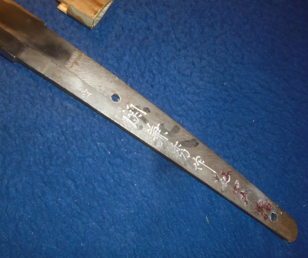

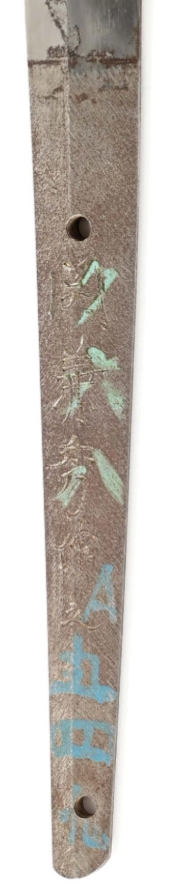

Bruce Pennington Posted Sunday at 03:02 PM Report Posted Sunday at 03:02 PM John, I don't know if you have all the Kanehide I have on file. In addition to the ones on this thread, I have 6 with painted numbers. Here's a list. If you don't have some or all, let me know and I'll post them: Kanehide (star stamped) Aug '43 Black/Red paint Oct '43 Black/Red paint Aug '44 Green/Blue Aug '44 Green/Blue Mar '44 Red/Blue May '44 Blue A90/90 @JohnC 1 Quote
John C Posted Sunday at 05:06 PM Report Posted Sunday at 05:06 PM @Bruce Pennington Wow, Bruce. That's great! I have 39 examples of his mei, which is what I am recording, but do not have 3 on your list (aug, 43; oct, 43, aug 44). I would love to get your nakago pics of the 3 left on your list below. You have two listed as Aug 44. The one I have has the A80/A930 paint scheme. But it's the mei I am particularly interested in for this project. Just to give you some background info - It is widely known that Kanehide changed his mei through out his career. But current literature available to me does not discuss a) how many times (i.e., what style kanji used) he changed, b) when those changes took place, and c) why those changes took place, if that can be determined through examination. It would be easier to just get in touch with his son Masanao and ask these questions but that is obviously not possible for me. Additionally, there is an almost 20 year gap in his oshigata record between 1954 and 1973. What version of his mei did he use during this time period? Are there any exhisting oshigata from this time period in Japanese sources? So far, I have been able to log 39 examples of his mei from ~1938 to 1988, except for that 20 year gap. There are some definite time frames for his kanji changes—basically 1938-1940, 1940-1945, and post war. Also, there seems to be some correlation between his kanji changes and certain events in his life. So I am comparing his kanji changes with his biographical history (mostly coming from Malcolm's research and one of his "resumes"). Anyway, it keeps me off the streets. And I greatly appreciate any info you have. John C. 1 Quote

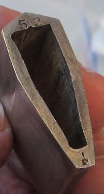

george trotter Posted 19 hours ago Author Report Posted 19 hours ago Hi John C..Just thought you and Bruce might be interested in a little more marking detail on that RJT 5/1944 Kanehide I posted mei pics of just above. Here is a pic of its habaki...stamped '52 and also '1 with kanji' (Seki? not sure). The '52' matches with the blue paint marking on the tang which says 'Ku 52'. When he made this sword he was working at the "Seki Kabushiki Kaisha' which he joined on Sho 16 year 2 mo 2 day so these marks must be related to their production system markings (Dai Nihon Token Shoko Meikan Mar 1942) (from Hist. of Nakata Kanehide, Swordsmith' from sanmei.com). Not sure if this is of interest bur it does show the tang and fittings are numbered together. Regards... 2 Quote

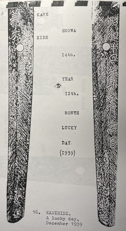

mecox Posted 18 hours ago Report Posted 18 hours ago @John C John, as a matter of interest did you see my paper in Downlaods "Seki Toki Swordsmiths" it has an outline of Kanehide. Do you have these 2 oshigata from Fuller & Gregory 1983. Quote
Bruce Pennington Posted 13 hours ago Report Posted 13 hours ago August '43 Kanehide Oct '43 (don't have one legible of full nakago) Aug '44 1 Quote
John C Posted 13 hours ago Report Posted 13 hours ago 5 hours ago, mecox said: Do you have these 2 oshigata from Fuller & Gregory 1983. Thank you, Mal! I had one of them (1944) but not the other so much appreciated. John C. 1 Quote
John C Posted 12 hours ago Report Posted 12 hours ago 45 minutes ago, Bruce Pennington said: Aug '44 Thanks, Bruce. That's great. Not sure it matters for your data set, however the one labeled Aug 44 was mis-identified by the website (I had seen that one as well). It's actually June 44 (Kanehide has a very particular way he makes his 6's, which can look like an 8 if the picture is blurry). Also, it's a little interesting that on two he used a black and red paint scheme rather than the green and blue we normally see. John C. 1 Quote
Bruce Pennington Posted 12 hours ago Report Posted 12 hours ago 19 minutes ago, John C said: Aug 44 was mis-identified by the website (I had seen that one as well). It's actually June 44 (Kanehide has a very particular way he makes his 6's, which can look like an 8 if the picture is blurry) Thanks, John, I see what you mean. I corrected the file and chart. Quote
