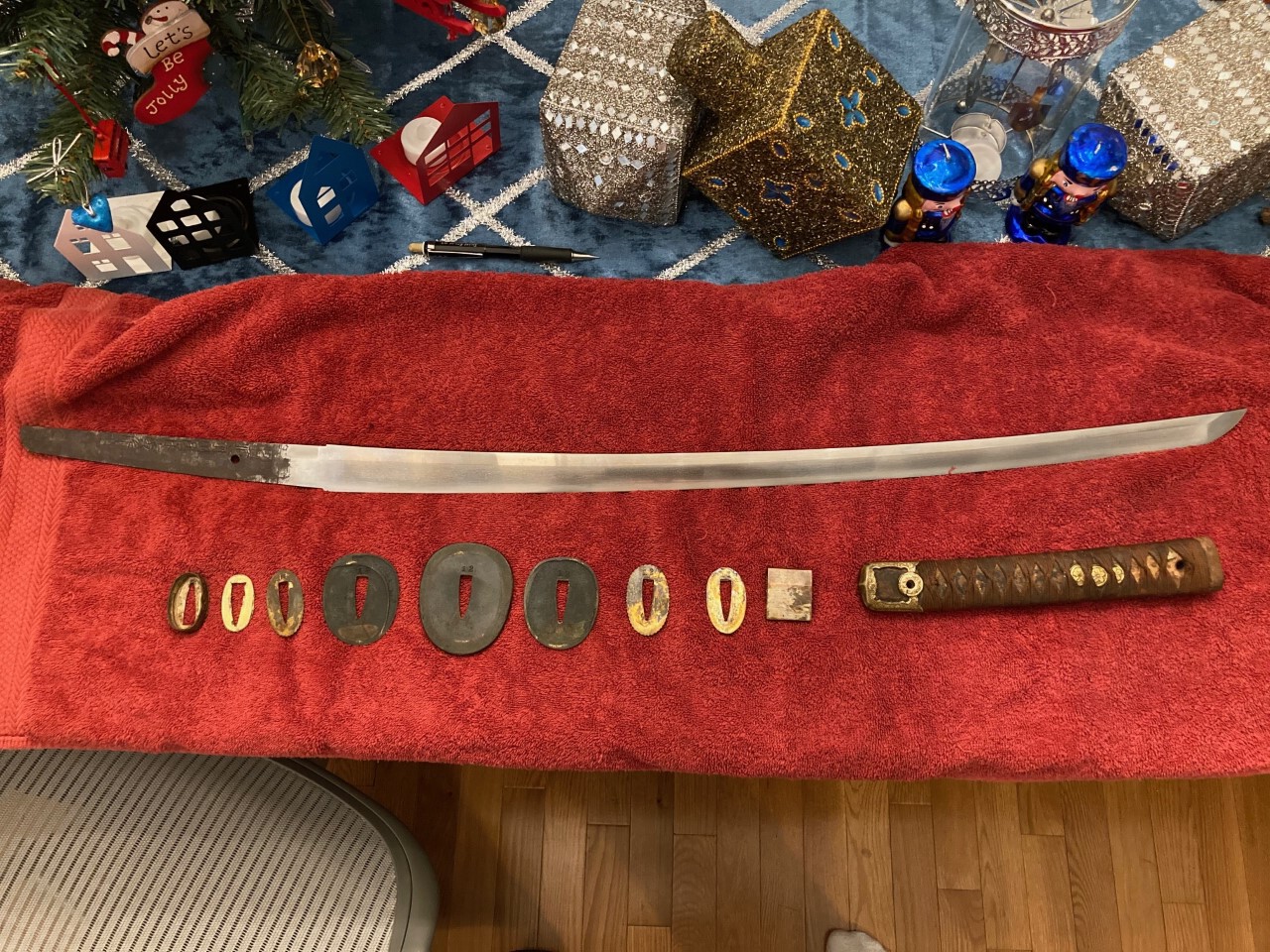

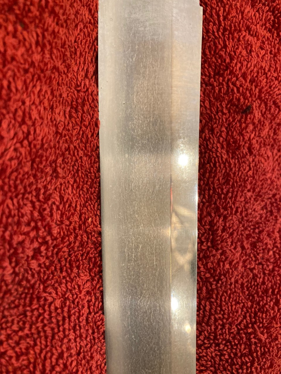

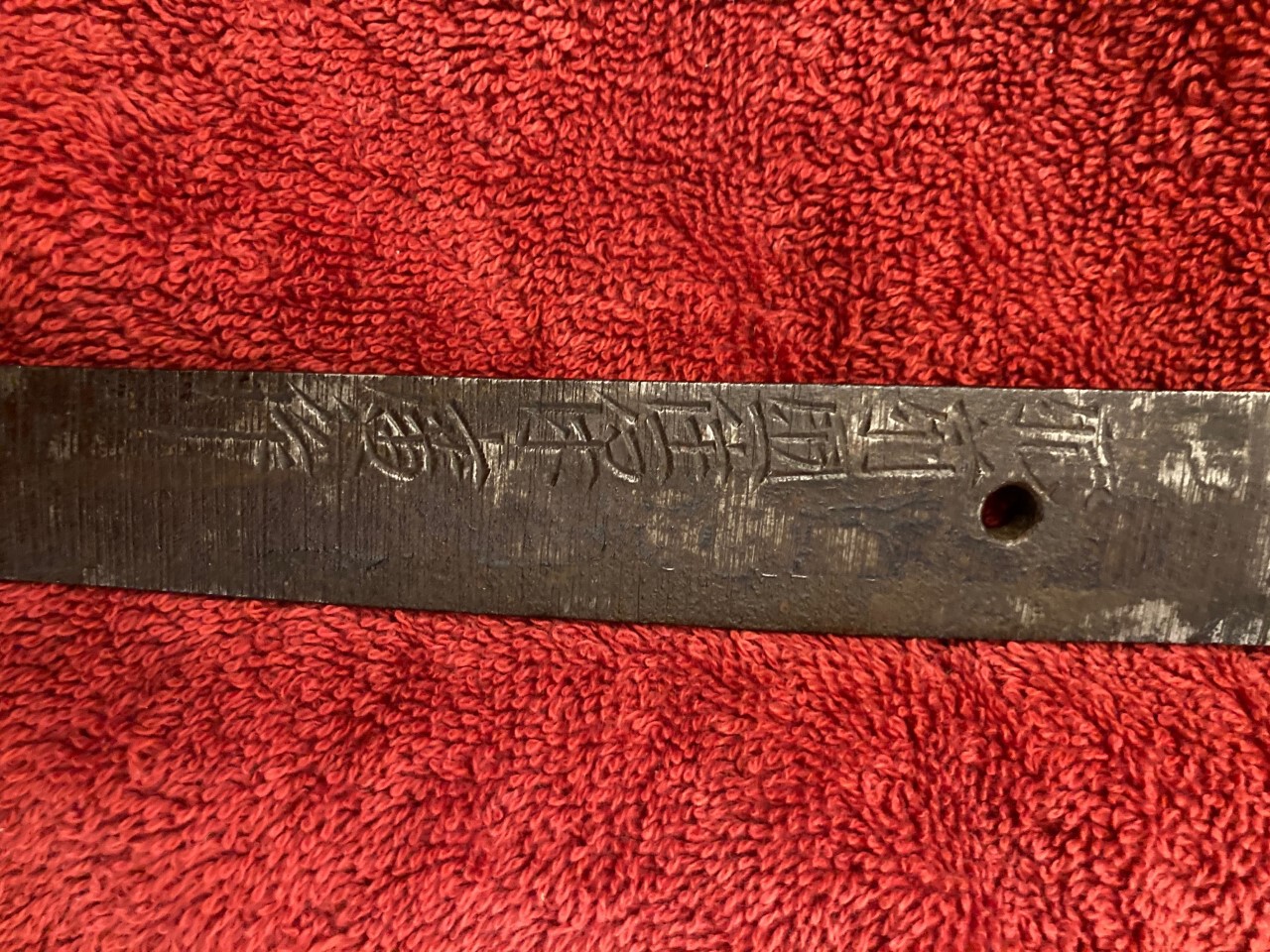

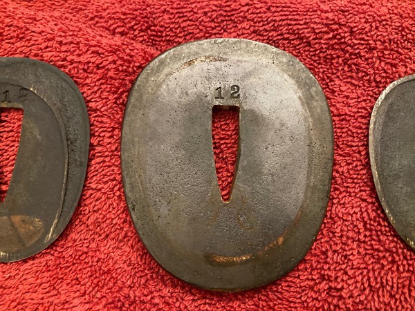

Peter Birmingham Posted December 20, 2020 Report Posted December 20, 2020 Hello: I bought this katana advertised as a hand-made WW2 era naval officer's sword on E-bay and would like to know more about it and perhaps authenticate it. 1. What is the translation of the mei (signature) on the nakago (tang)? 2. The tsuba (guard) and two seppa (washers) are marked "12". What does that mean? 3. Does this look like a machine-made or hand-made blade? 4. Was this scabbard type wood with lacquer on the outside, or is the outer layer typically plastic? The blade does react strongly to magnets. Thank you for your help. Quote
SteveM Posted December 20, 2020 Report Posted December 20, 2020 Mei is 肥前國住保廣 Hizen-kuni jū Yasuhiro Yasuhiro is a wartime smith. The numbers on the parts are likely to be assembly numbers. Wait for the military lads to come on line to give you more info. 1 Quote
Bazza Posted December 20, 2020 Report Posted December 20, 2020 At first blush it looks like a good Hizen Gendaito?? BaZZa. 1 Quote

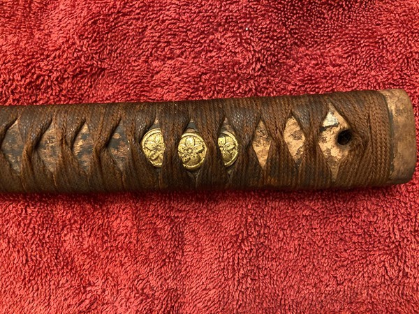

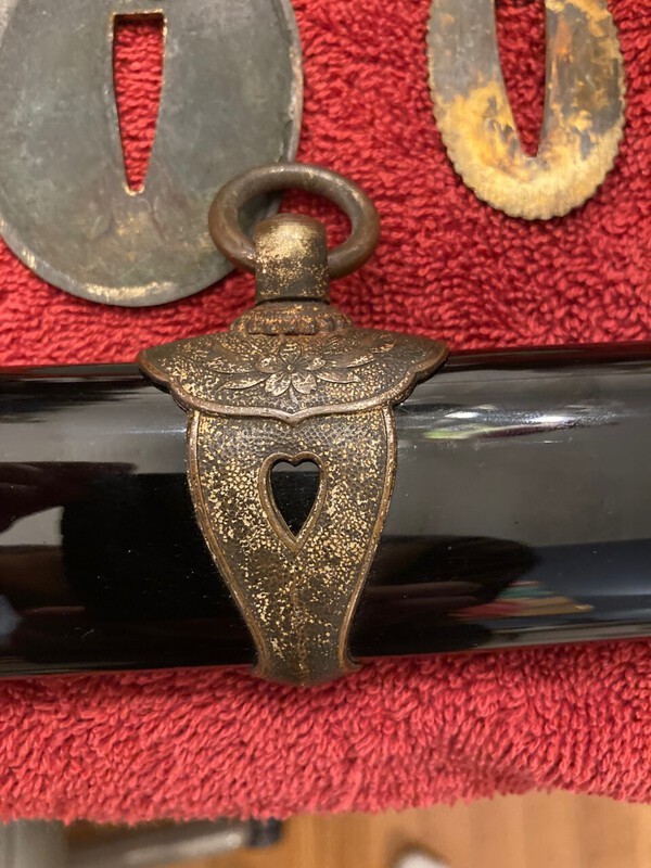

Bruce Pennington Posted December 20, 2020 Report Posted December 20, 2020 Yes, the shop doing the fittings for the blade mark them with a number to keep them together as each blade is different in size and shape and the fittings are customized to each blade. The saya is lacquered. The painted wood under your handle wrap indicates this was fitted very late in the war. And I agree with Barry that this looks traditionally made to me, but I'm nowhere near knowledgeable about nihonto. Those guys will have to advise on that. 1 Quote
Surfson Posted December 23, 2020 Report Posted December 23, 2020 A hada appears to be clearly visible, leading to the belief that it is hand forged. 1 Quote
Peter Birmingham Posted December 24, 2020 Author Report Posted December 24, 2020 Thanks to all of you that responded; very helpful! Do any of you know a tsukamaki service provider in the Chicago area? I don't want to mail any part of the sword if I can avoid it; I'd rather drop off the tsuka. I'd consider a new handle or just a new wrapping. Thanks and happy holidays! Quote
ROKUJURO Posted December 24, 2020 Report Posted December 24, 2020 Peter, I can see no reason for a new TSUKAMAKI unless there is severe damage to it. The condition of the TSUKA and its used appearance is part of its history and considered as patina. This may be different with swords that are in actual use (TAMESHI TO or alike). As your sword probably has an old (or at least traditionally made) blade, you could envision a complete new KOSHIRAE as soon as the blade has been evaluated and polished. 1 Quote
