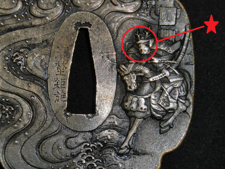

Dale. You have discovered a new clan. The Battle of Uji River is a popular story and is often used in the subject of sword fittings.
However, the tsuba you posted clearly uses the same sketch or the same mold.
You can see the superiority and inferiority of the finished product even by comparing the products handled by the pro shop.

Crushing around nakago-hitu with chisel is a characteristic of the middle Muromachi period. However, the drills and file marks that open the slogan are modern.

It was revealed that the failure of the casting process was a casting work. It is also characteristic that the edge of seppa-dai is slightly raised.

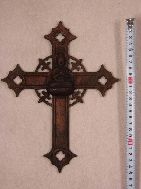

The ebisu & daikoku design tsuba has been around for a long time as lucky charms and is also featured in books.
Since ebisu and daikoku are gods of good business, you may have in luck if you make a successful bid.
https://www.jauce.com/auction/s808531392  28 cm x 25.2 cm
11'' Japanese Tsuba Katana Sword Guard Fitting Cast Iron Signed Wall Plaque
https://picclick.com/Vtg-11-Japanese-Tsuba-Katana-Sword-Guard-Fitting-232398491013.html   Also on  https://www.jauce.com/auction/b539885510
SOLD - Sep 29, 2018, 04:50 PM $55.00 image.png.abd305d25ee62ac79343a9c287976fb4.png
Nambu Tekki image.png.9745a196adef61462a5aa3c8348aa620.png     tsuba design ornament plates [diameter 15 cm]
image.png.bac0d039925831947596a1bedd663649.png    https://www.jauce.com/auction/v779901391 275mm x 245mm x 7mm  Weight 1884g
All these are seriously large tsuba-like objects. I have one the same size as the top image (different pattern) that I use as a Sundial in my garden and I also have a set of the tsuba cast iron 'sizzle' plates. Most of these objects are relatively cheap ornaments - except their weight is often a small fortune in shipping costs!:(

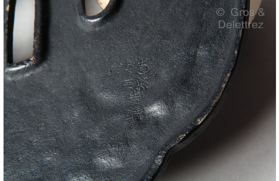

Hi Yas, another Hamano Noriyuki reproduction - "Silver" this time [Don't think so!]   https://www.jauce.com/auction/c896249242
The face as usual is worn away, the inscription and other details are not too bad, the ura has casting faults in the seppa-dai. They must have made plenty of them that's for sure, they keep turning up.
