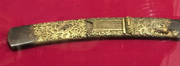

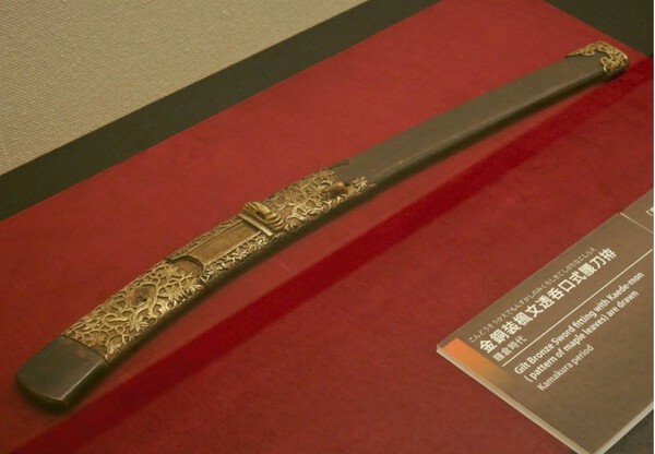

Yasaka Azuma Posted July 22, 2020 Report Posted July 22, 2020 Can you please ensure your name is on every reply by embedding it in your signature. Lots of Newcomers are not adhering to this policy. I still don't know how. I type every time, not smart! The exterior is a traditional and splendid style dating from the 13th century, so a deformed copy of the new era is made. Apparently, there are no scratches or abrasions that would normally occur, so I think it is electroplated refinished as Adam says. Yas.A 金銅装楓紋透呑口式腰刀拵 http://www.city.odawara.kanagawa.jp/index.php?p=&d=field/lifelong/culture/reporter/reporter&c=&type=article&art_id=5602 1 Quote

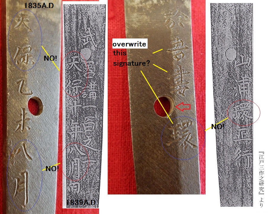

Babu Posted July 22, 2020 Report Posted July 22, 2020 Tamaki known Signatures: 山浦環 yamaura tamaki No record that I could find to corroborate your mei. What was your point of reference as admittedly I'm just going on records and known examples. Well done if it's shoshin I still wouldn't have bought it myself. I must admit I find this whole scenario of going from a kogatana mei to this point rather strange. Regards Adam Quote

Babu Posted July 22, 2020 Report Posted July 22, 2020 I'm not sure if you guys are aware of what smith tamaki is? This was the early mei of kiyomaro. Just saying. Regardless of mei I haven't seen many signed and dated kogarasu Maru wakizashi for 2500 then again I really haven't done any research on them and price of different Smiths that made similar pieces but either way 2500 won't buy you a mumei piece of junk truthfully Kiyomaro (清麿) changed his sword name many times during his brief career. The first name he used was Ikkanshi Masayuki (一貫齋正行), then he used Hidetoshi (秀壽), later he switched to Yamaura Tamaki (山浦環). After that he went back to Masayuki (正行) and finally to Kiyomaro (清麿). Quote
Yuradneprov Posted July 23, 2020 Author Report Posted July 23, 2020 Yes I read this. There are existing examples with only tamaki written without the yamaura. Quote
Yuradneprov Posted July 23, 2020 Author Report Posted July 23, 2020 Kanzan koza has one that has a single kanji mei. Just tamaki. Quote

Babu Posted July 23, 2020 Report Posted July 23, 2020 Darcy has a papered kiyomaru on his website for reference . It's also dated and there is a character on that date that's identical to the one on your blade. However the atari on that kanji are struck from the opposite direction to your blades atari on that same character.This would throw red flags for my simple mind but I appreciate your far more knowledgeable than I so will bow to that fact. Quote
Yuradneprov Posted July 23, 2020 Author Report Posted July 23, 2020 The direction varies there are examples that go both directions. Believe me I checked everyrhing Quote

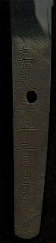

Yuradneprov Posted July 23, 2020 Author Report Posted July 23, 2020 Will put an example up with arrows that point in the same direction in a little bit when I get back home. He really have many different ways of signing this is dated 1835 would be when he was 24years old and is beginning of his career as he gets older the style changed into a more squared of kanji look Quote
Yuradneprov Posted July 23, 2020 Author Report Posted July 23, 2020 From kiyomaro kotetsu book..same example both pictures Quote

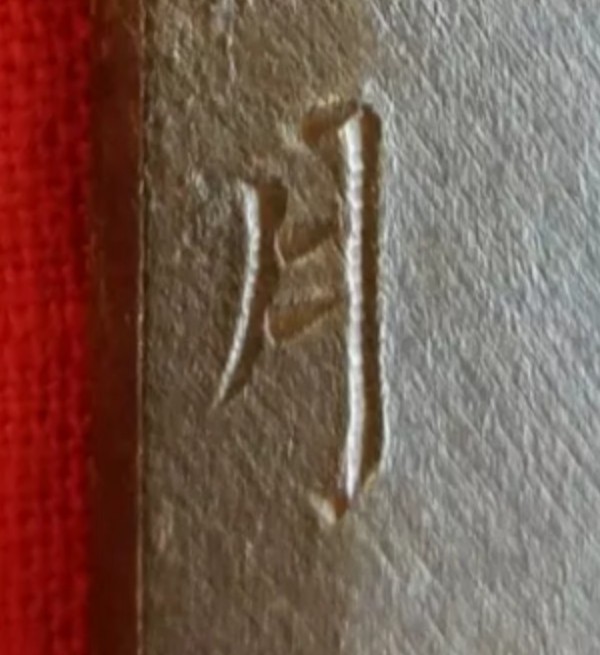

Yasaka Azuma Posted July 23, 2020 Report Posted July 23, 2020 Is the topic of koshirae over? Why are you getting so heated? You don't have to worry about kiyomaro's signature. No one can reach the real kiyomaro. See a Mekugi (fastening pin) hole. Grindstone powder is sticked. Evidence that the previous owner of this wakizashi often maintained it. I think that the next owner should also be cherished. Y.A 1 Quote
