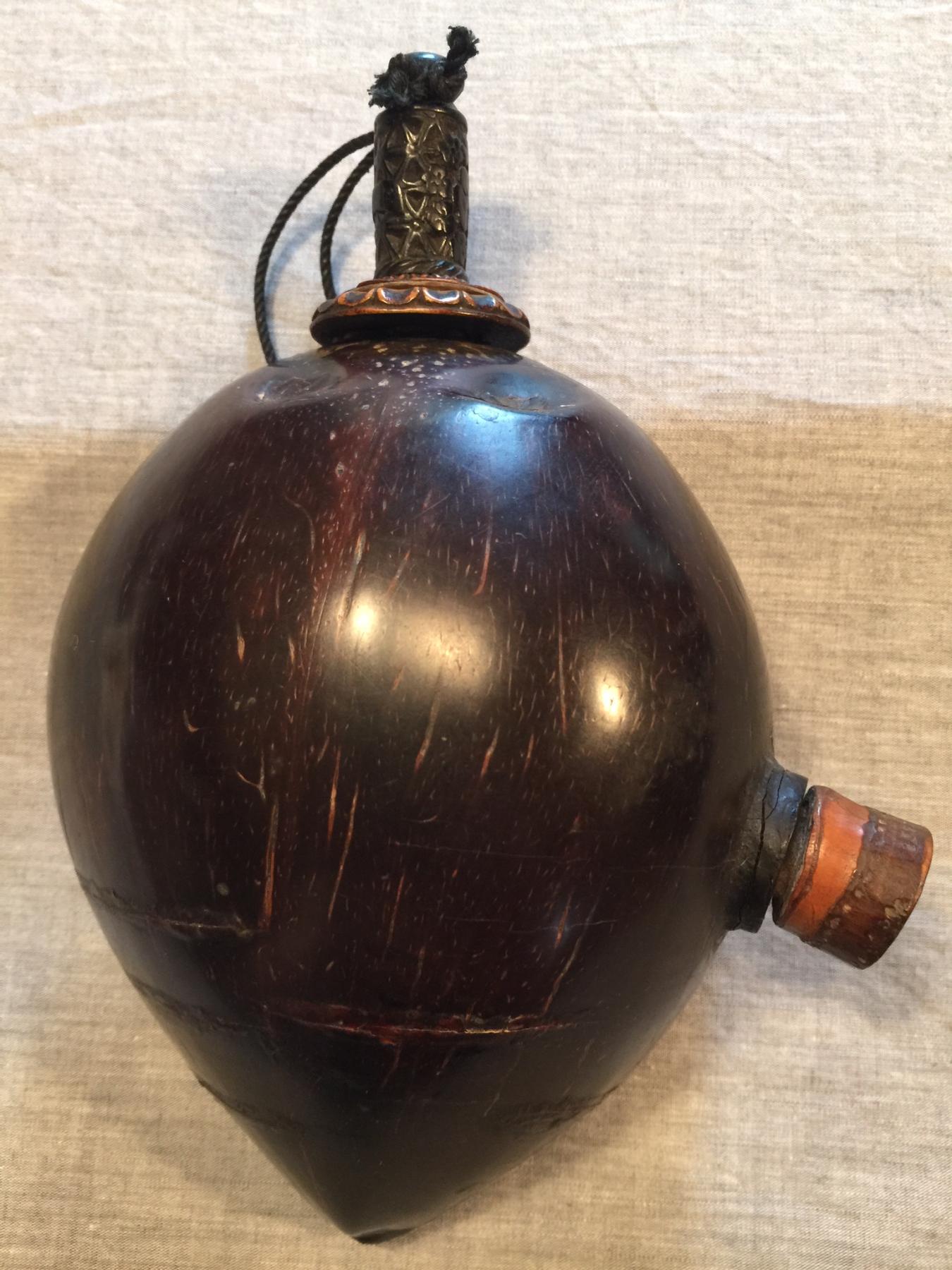

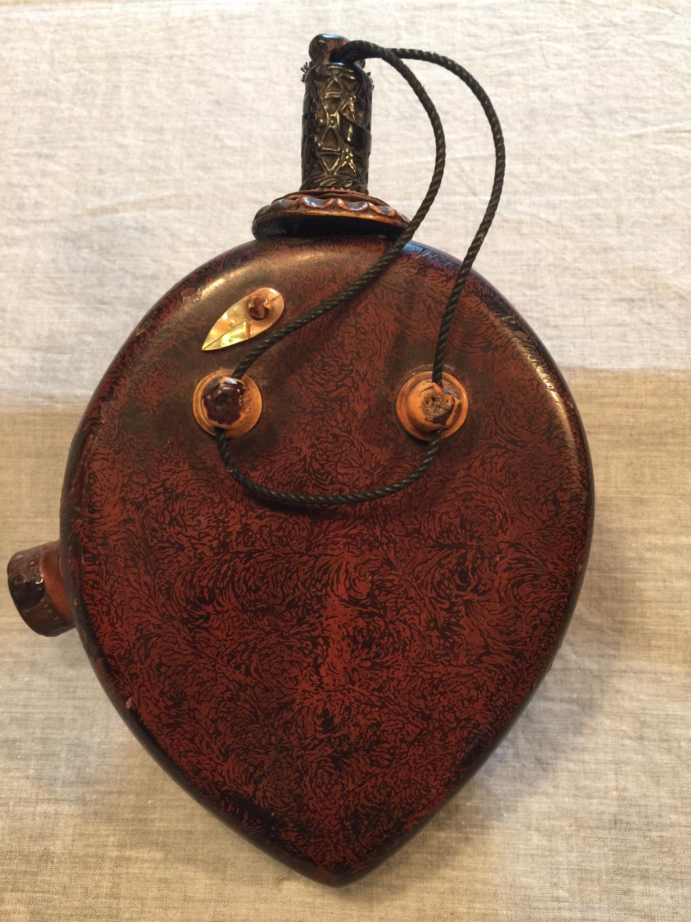

Bugyotsuji Posted May 7, 2019 Author Report Posted May 7, 2019 Coconuts. This Kayaku-iré made from a coconut half looks to be from some south Pacific island, but you can just make out what looks like the Chosokabé Mon on the black neck of the top cap. https://www.google.co.jp/search?q=長宗我部家紋&client=safari&hl=ja-jp&prmd=inmv&source=lnms&tbm=isch&sa=X&ved=2ahUKEwjts6zE8ojiAhWEHHAKHTTOBhMQ_AUoAXoECAwQAQ&biw=414&bih=719#imgrc=GU46lGoqQwgL-M Quote

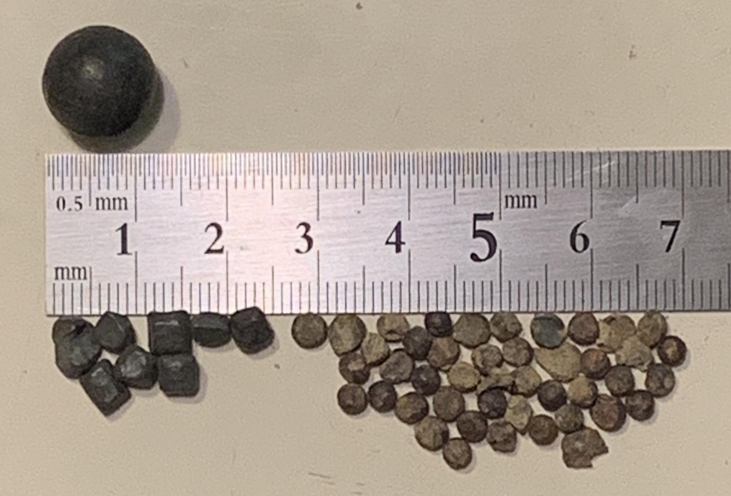

Bugyotsuji Posted May 22, 2019 Author Report Posted May 22, 2019 Recently I have been lucky with finds, small to be sure, but interesting.One is a Tama-ire double ballbag, one side/slot bag marked 小, and the other 大, (Daisho) so we can guess that the owner possessed and carried two guns of different ball sizes, i.e his small-bore gun and his BIG gun.The other discovery was inside a bag attached to a blackpowder flask. There was one ordinary lead ball for a smooth-barrel small-bore, and then some strange chips of lead, which I suddenly realized were scatter-gun or shotgun pellets. Since I already had some which came from the jammed barrel of a Shikoku gun I purchased last year, I am now able to show two examples of Edo or earlier shot, as opposed to smooth round musket ball.See photo: The single ball and the larger bits on the left came from the ball bag. The smaller shot on the right was down the barrel of a jammed Iyo gun. 1 Quote

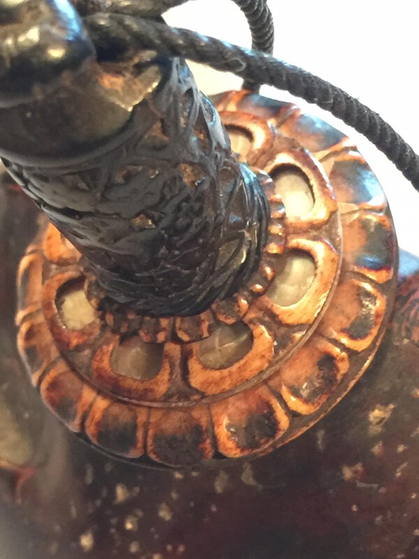

Bugyotsuji Posted November 18 Author Report Posted November 18 This topic is surely worth expanding. Looking to post a coarse powder flask I found over the weekend, I discovered this good old thread! These old black-powder flasks can show astonishingly fine work. If you can find one with matching bits (frills), then all the better! See below the collar of the spout, the top of the powder measuring cap, the heads of the pegs, and the flask side-attachment seat. Detail Pouring spout 3 Quote
Bugyotsuji Posted November 19 Author Report Posted November 19 These are to my mind older, from a time when guns were still thought to be ‘Western’, a time of strict imitation, when artisans thought a ‘powder horn’ ought to be made from cow horn. They still retain some Western feeling, but already the artistic sensibility was at work. The ‘frilled’ edges may also pay lip service to Western clothing ruffs which were still somewhat in fashion. Later on, people felt free to create powder flasks in more Japanese iterations. The ruffs often continued however. 2 Quote

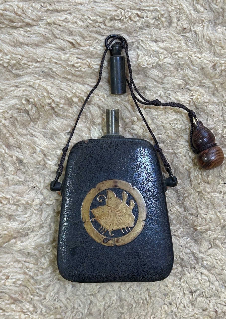

Bugyotsuji Posted November 26 Author Report Posted November 26 Having given a recommendation concerning what state or condition of powder flask is best, I came across a ‘why bother?’ one that is more typical, well used, with replaced parts. Why did I buy it? See what the ball bag contained. Small round shot, backing up previous discoveries of shotgun pellet usage. (See 22 May 2019 post above.) Quote
John C Posted November 27 Report Posted November 27 On 11/25/2025 at 9:11 PM, Bugyotsuji said: Small round shot Firstly, unbelievably interesting thread. I love the details about items I might come across. Secondly, would the shot be used like we use shot today (bird shot vs. ball round for larger game)? John C. p.s. I would pay an entrance fee to see your collection in a museum somewhere. 1 Quote
Bugyotsuji Posted November 28 Author Report Posted November 28 John, shot would have been used in the same way for small game, yes. Of course they did not have cartridges as we know them, so, as in the early days of the Wild West, a powder charge would first be poured down the barrel, followed by a load of lead pellets, maybe in some paper wadding to keep the load compact. Trawling some antiques fairs etc. will gradually build your collection. Step by step one gets to Rome! PS I you can get hold of the *Ogawa Collection, you will see many interesting examples of the kind of thing we look for, accessories of the ashigaru and castle lord. * and 1 Quote

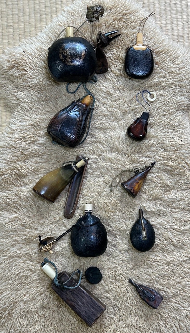

Bugyotsuji Posted November 28 Author Report Posted November 28 Gary (Tengu) has a nice collection above. Quote
