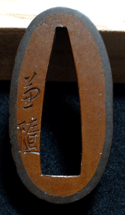

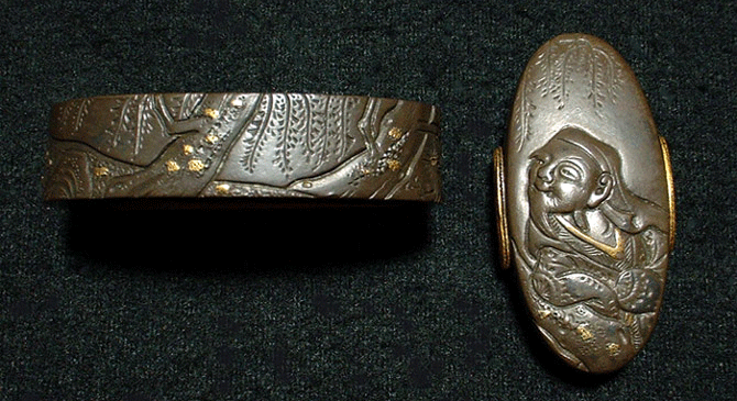

Hi All, I am in the middle of ice on the 3rd tug I am activating nthis year and this is the one I will be on the rest of the season. Meanwhile it is in 8 feet of ice so no trip home until early August, which leads me to ask a favour. Having just bought this set by the workmanship, I am curious if the mei is shoshin. Hamano Kenzui. Yes? No? Thanks, John
edit; BTW This is shibuichi although it must be largely copper. Which of Ford's alloys I'm not sure, but it reminds me of well patinated suaka. It was the varying techniques combined that attracted me. Kenzui is apparently Shozui's son.

The mei of Hamano Kenzui, the second son of Hamano ShÅzui and the second master of the Hamano school, is illustrated on p.83a-d of KinkÅ Meikan. While the second kanji of your tsuba would pass, the first is quite unlike the much more formal and stylised kanji illustrated, which lacks the florid, ‘D’ shaped loop of your fuchi.

Thank you Brian, I see the difference in the first kanji alright. Must confess that the one on my fuchi is more stylised and thus not carved to deceive maybe. If not Kenzui, another legitimate artist? John

Thanks Stephen. BTW Kane can be read ken. john
I’m sure we will all agree that John’s fuchi-gashira is inscribed Kaneyuki, since it is surely not gimei and the Hamano rendition of Kenzui is no longer applicable. The only other artist listed by Haynes who used these kanji (H 12617.0), with the gŠof Juryūken, is described as working in Edo ca 1800-25. I wonder if this is the artist of John’s pair?
