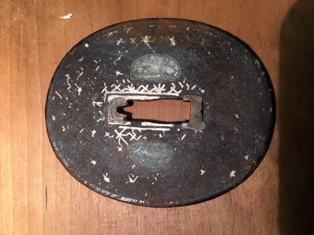

I am writing to show to the NMB community a tsuba that I have just added to my collection.
I am as sure as I can be that most of readers who have bothered to open this post will judge this guard harshly. It is in rough condition. It does not fit comfortably into any “school” although most of us would easily call it “Nanban style”. I also assume that many on the Forum will realize that I just bought this fitting from one of the most reviled purveyors Japanese antiques on eBay. I am NOT embarrassed. This guard fits in my collection!
I like this guard because I am sure that it is a CHINESE sword guard that found its way to Nippon, probably at a time when the country was supposedly “closed”. I can’t be sure how this guard got to Japan. It might have been the property of a roaming warrior. I am sure that lots of the guys who came home from the terrible fighting that took place in Korean had access to Continental weaponry. Maybe one of them brought it home as a trophy. It is also possible that this was nothing more than a trinket some Chinese trader sold to a minor official who wanted to dress up like a “foreigner”.
Once in Japan, this guard was adjusted for use on a katana. The kinko that added the necessary ryo-hitsu or the fellow that later filled them in probably found the nunome zogan embellishments on the guard coarse. And it seems never to have been treated with care. It probably spent most of the last century or two in a kura where it lost lots of zogan and gained ample red rust. Cleaning it will be a chore – that I am looking forward to!
I am pleased to have found this guard.  It fits with other pieces I have assembled and I found it. I have done my home work and developed my own opinions.Collecting is much more about searching than it is having.

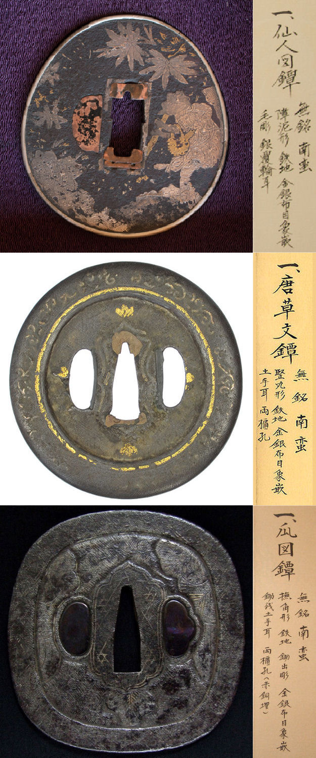

Agree that Nanban is the box where this kind of tsuba usually are put. Here below 3 tsuba papered as Namban which share some point with your one.
Bye, Mauro
Can't argue with your conclusions there Peter. Definitely seems repurposed Chinese, and has a tale to tell. Glad it found the right home.

Thank you for showing us those Namban tsuba. I agree that the top one you show is absolutely of “Chinese” origin. It is terrific. Your examples also show the range of tsuba that get assigned to the Namban category. Most Namban guards are, frankly, not very good, but your group illustrates well-crafted pieces that include modified imported and pieces as well as other made in Japan but  inspired by “foreign” designs. The beauty of your tsuba is that they illustrate the QUALITY of Japanese metal working. Collecting by types may cause us to emphasize “type” rather then quality. I LOVE your Chinese guard!

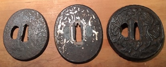

For what it is worth I will attach images of one of my papered Namban tsuba. I got it because it is – to me – a copy of a European bilobed guard. But it also has pictures of those funny European guys with round eyes and moustaches. Unfortunately, it only has an old “Green Paper” so we can’t be sure it is “good”. :)

I appreciate your positive comment and encouragement. But I am not sure I can agree that my guard is good and – well – "beautiful”. I think Mauro’s top guard IS both of those things. Obviously, I agree my tsuba deserves to be “preserved.” But I am also willing to view it as an “artifact” that wears its history. Mine is very unlikely to get – or warrant – papers.
