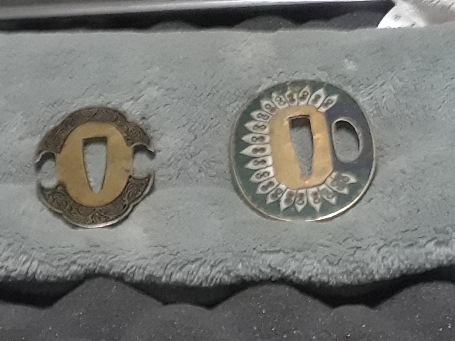

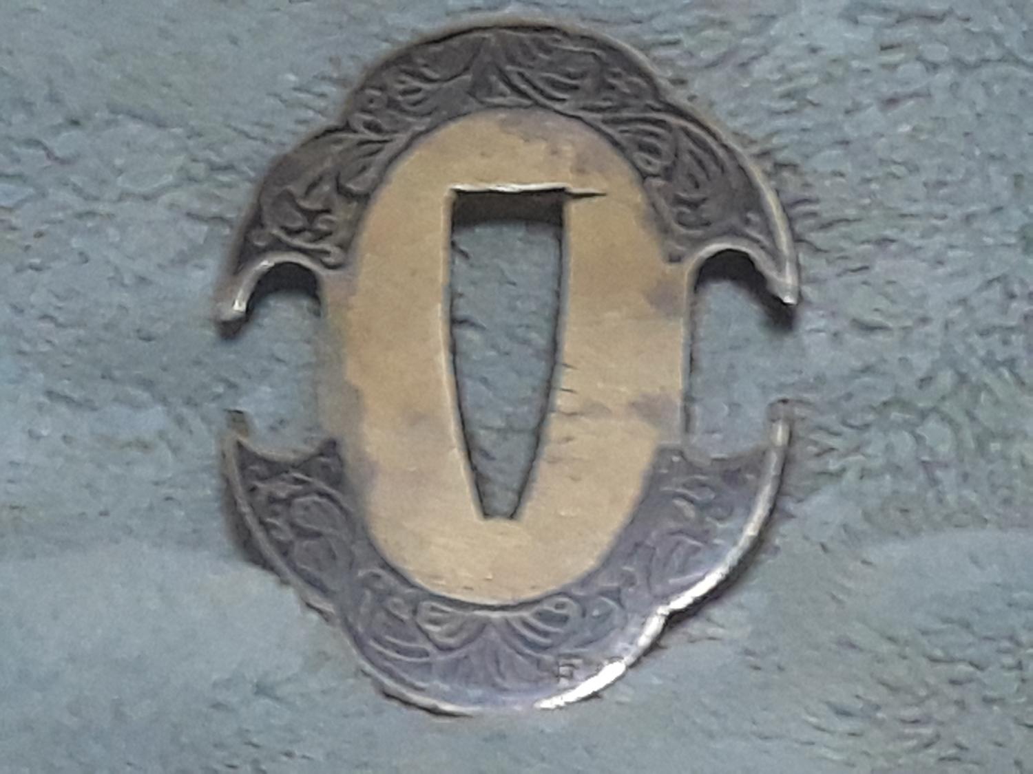

I have a couple of tsuba I thought I would show and get opinions on. I saw these and have not too much knowledge of them, though I know they're probably Edo-period (?) as I read that ornamental fittings came more into vogue around that time. I could and (probably be) totally off base with these. Either way, I didn't pay too much for them.
Let me know what you think and any information you might be able to glean from the pictures.
The first tsuba is 5.45cm x 4.1cm, Thickness: 0.5cm, Inside hole is 2.4cm x 0.75cm(max width) x 0.2cm(min width)
The second tsuba is 6cm x 4.7cm, thickness: 0.5cm, Inside hole is 2.4cm x 0.7cm (max width) x 0.2cm (min width)
Thanks for any education guys!
Ah, cloisonne, I've heard that word. Thanks for that! Also I have not heard of the term 'doro shippo' but I googled it and now I understand. Thanks! Can you all perhaps identify a school/age it belongs to?

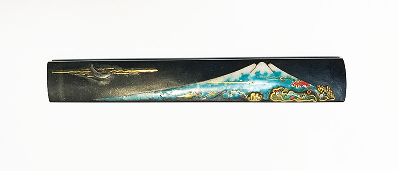

Doro-shippo, 'mud enamel'. This is a term used to describe earlier Japanese enamels that featured less bright and clear, ie; muddy colours, generally those enamels produced before the late 19th century when German chemists introduced finer enamel production technologies.
There were two currents of cloisonne art during the Meiji period: one traditional since the Edo period which includes doro-shippo, and another which started anew under the direction of western technicians (e.g.,Gottfried Wagener).  The two styles have run concurrently through Meiji, Taisho, Showa, were revived during the post war era and continue to be produced.  The tsuba presented here are in the doro-shippo style, anyone seeing clear bright color needs to calibrate their monitor.

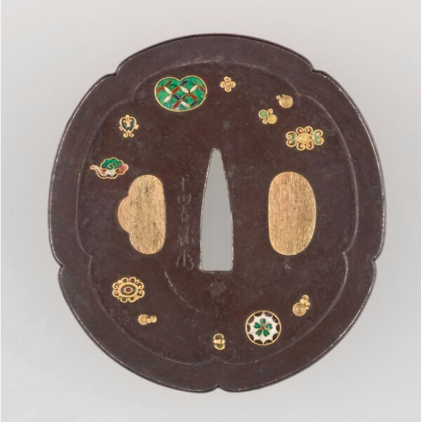

Funny Jean!  Although the surname Hirata is a famous one with samurai associations, and even some  links with the martial arts,  in this instance MMA stands for- Metropolitan Museum of Art, NY, USA.  :)
