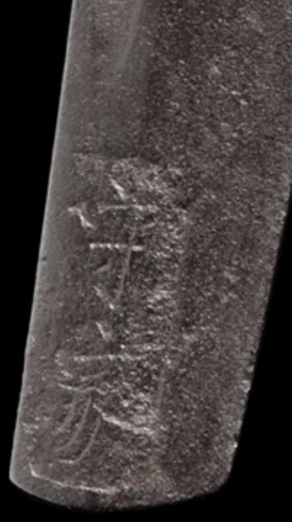

Guido Posted June 1, 2018 Report Posted June 1, 2018 FWIW: this is the nakago of a Nambokuchō period sword I used to own – pretty much everybody said it’s Keichō-suriage. Quote

leo Posted June 1, 2018 Report Posted June 1, 2018 FWIW: this is the nakago of a Nambokuchō period sword I used to own – pretty much everybody said it’s Keichō-suriage. Guido, I would lean towards the same opinion, even though its rounded a bit. Grüße, Martin Quote
seattle1 Posted June 1, 2018 Report Posted June 1, 2018 Hello: Guido I would say your attachment is Keicho as there just is not enough of a curvature, and I would call Paul's both to be Keicho for the same reason. As for the reference it is No. 389 of Me no Me, 2009, February., pp.23-57. It is wonderful for you to be able to talk with Tanobe sensei. Arnold F. 1 Quote
